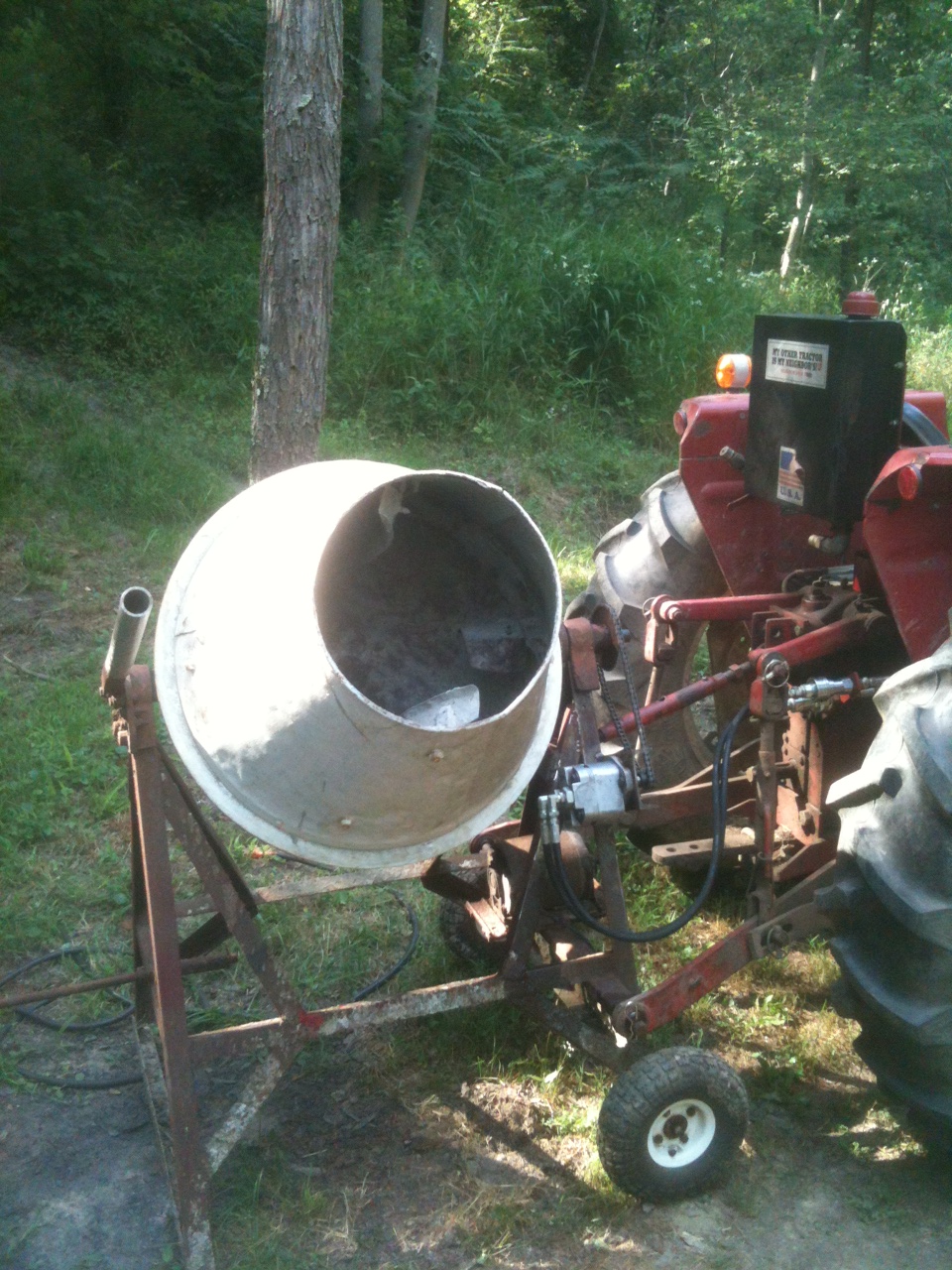

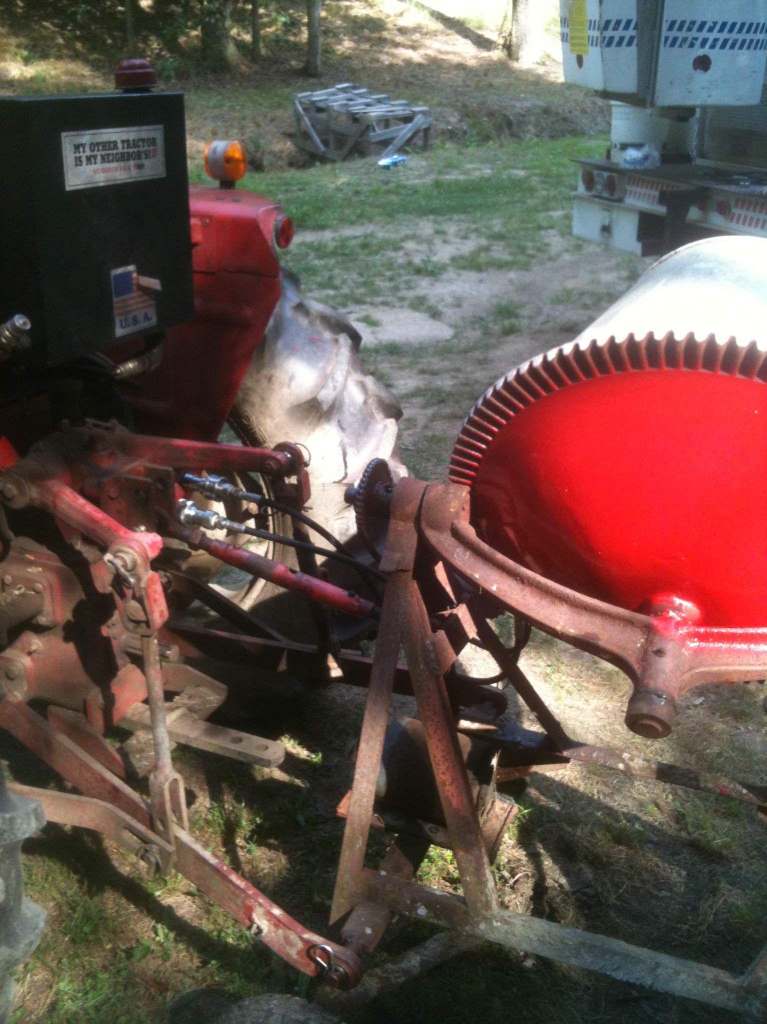

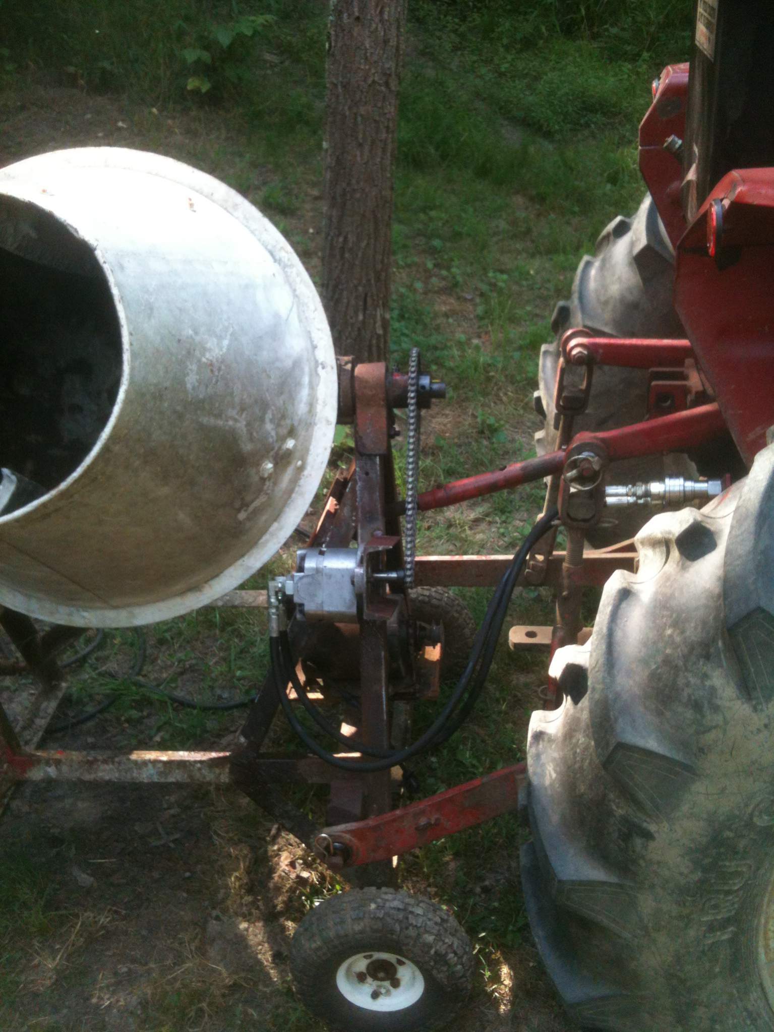

I modified an old Sears mixer to mount via 3-point hitch, and just last w/end modified it to run with a hydraulic motor off of my newly installed rear hydraulics Q/c's. Now I can run the drum by changing position of my selector valve. I left the electric motor on it in case I ever want to run it with 120vac, by removing the sprocket and putting the pulley and belt back on it.
Now I want to add a cylinder for dumping from the tractor seat.

hey that is pretty cool. How much did the hydraulic motor set you back moneywise?

Not to hi-jack this guys thread, but the motor cost me about $35. The sprockets and chain I had laying around. The motor is a 1.0cu.in Rexroth. The chain ratio is 4:1.... 10 into 40.
If will turn a loaded drum @ idle, (540 PTO) and revving-up when first mixing is about the same drum speed as when using the 1725 rpm electric motor. My tractors have 1000rpm PTO capability too, but I see no need to run that speed, but I could if I wanted to? The pinion RPM of the stock electric powered setup was 246 (no load on 1/4hp electric motor). The 1000rpm pto setting would make it 250, but even with the 540 setting, I think it'll be fine.
