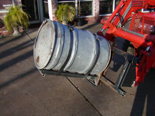

I tried to come up with a cheap,easy way to mix & pour those little tads of concrete that I always seem to need.
Have mixed 25, 80 lb sacks so far. Much easier for me than mixing by hand.
It is a 55 gal barrel mounted on my fel. Put in materials, clamp on lid, then turn upside down, then right side up, about 1/2 dozen times, remove lid & pour.

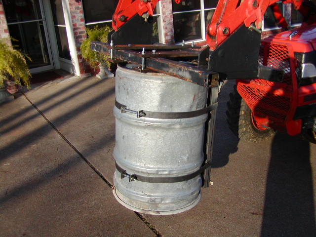

Barrel upside down

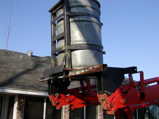

Barrel right side up

Neal,
Did you do anything to the barrell (e.g., weld in a baffle to help stir up the concrete)? Your set up looks like it would be a great help in placement of the concrete, assuming you can get your tractor close to the project -- a whole lot easier than using a wheelbarrow. Do you know how many cubic feet/(yds?) the barrell will hold?
Clint.
   / Strange, cheap, concrete mixer #8
I applaude your ingenuity, but I suggest you tip that barrel over a few dozen times instead of a half dozen. If you expect any consistency in strength, appearance, or performance you will need to mix it THOROUGHLY. You could open it occasionally and help blend the components with a shovel. That would probably get you most of the mixing you need. If you were using ready mix and water a dozen tips might work, but mixing aggregate, sand, water, and cement from scratch takes more effort.
#9
Clint,
I did not do anything to the inside of the barrel. So far I have not even put a gasket on the lid. I thought before I use it the next time, I would run a small bead of silicone around the inside of the lid & give time to set up, to see if this eliminated all leaking. It did not leak much, without any gasket.
I am sure the speed at which your bucket tilts, would have some bearing on the mixing ability.
I mixed as much as 5 80# sacks once, but so far I feel 2 sacks at a time may be the optimum.
It works great if you can pull up to where you are pouring with the tractor. I built a V-box (what I call a hog trough with the bottom open), when pouring forms, to make it easy to pour into the narrow forms.
