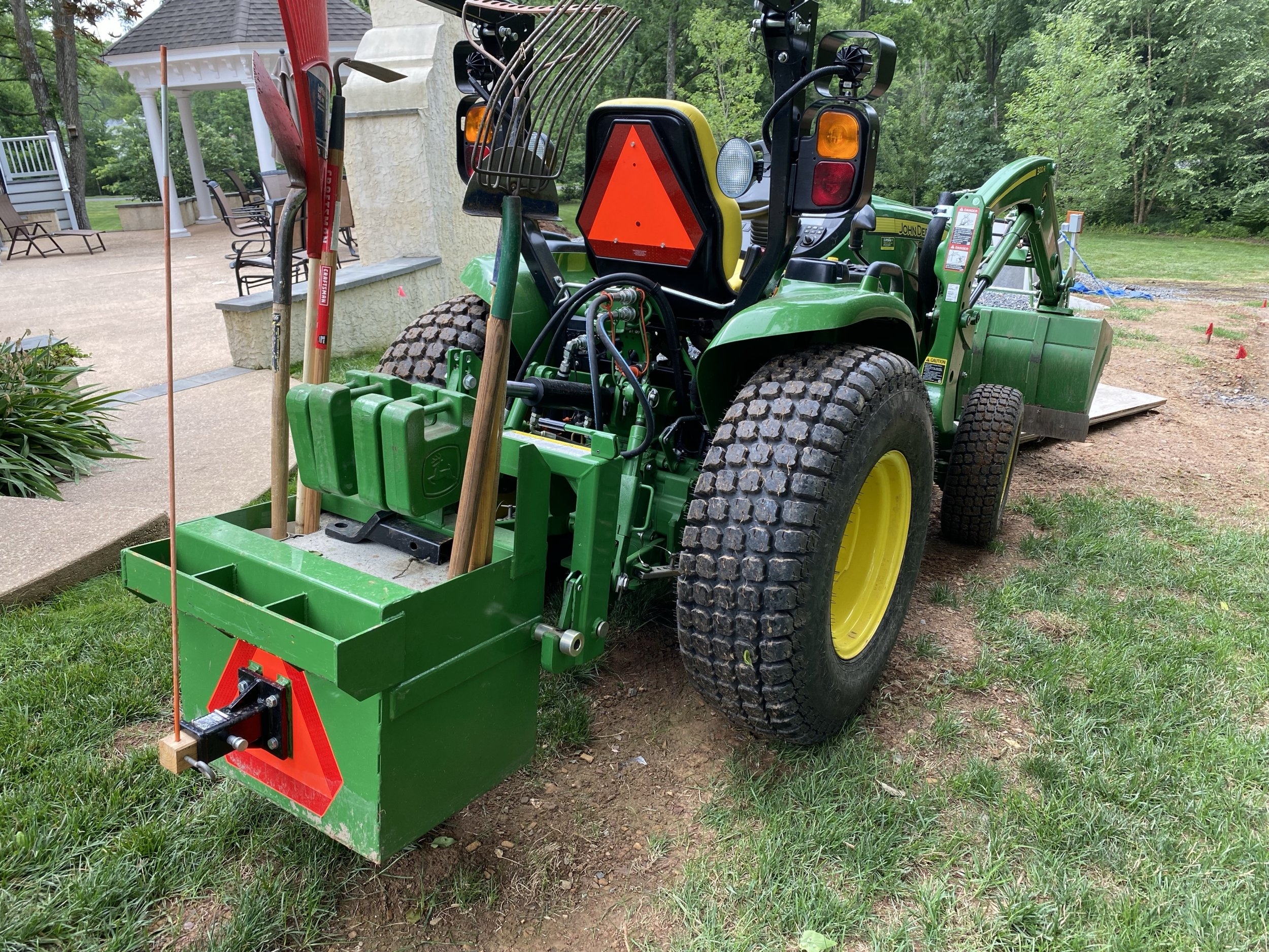

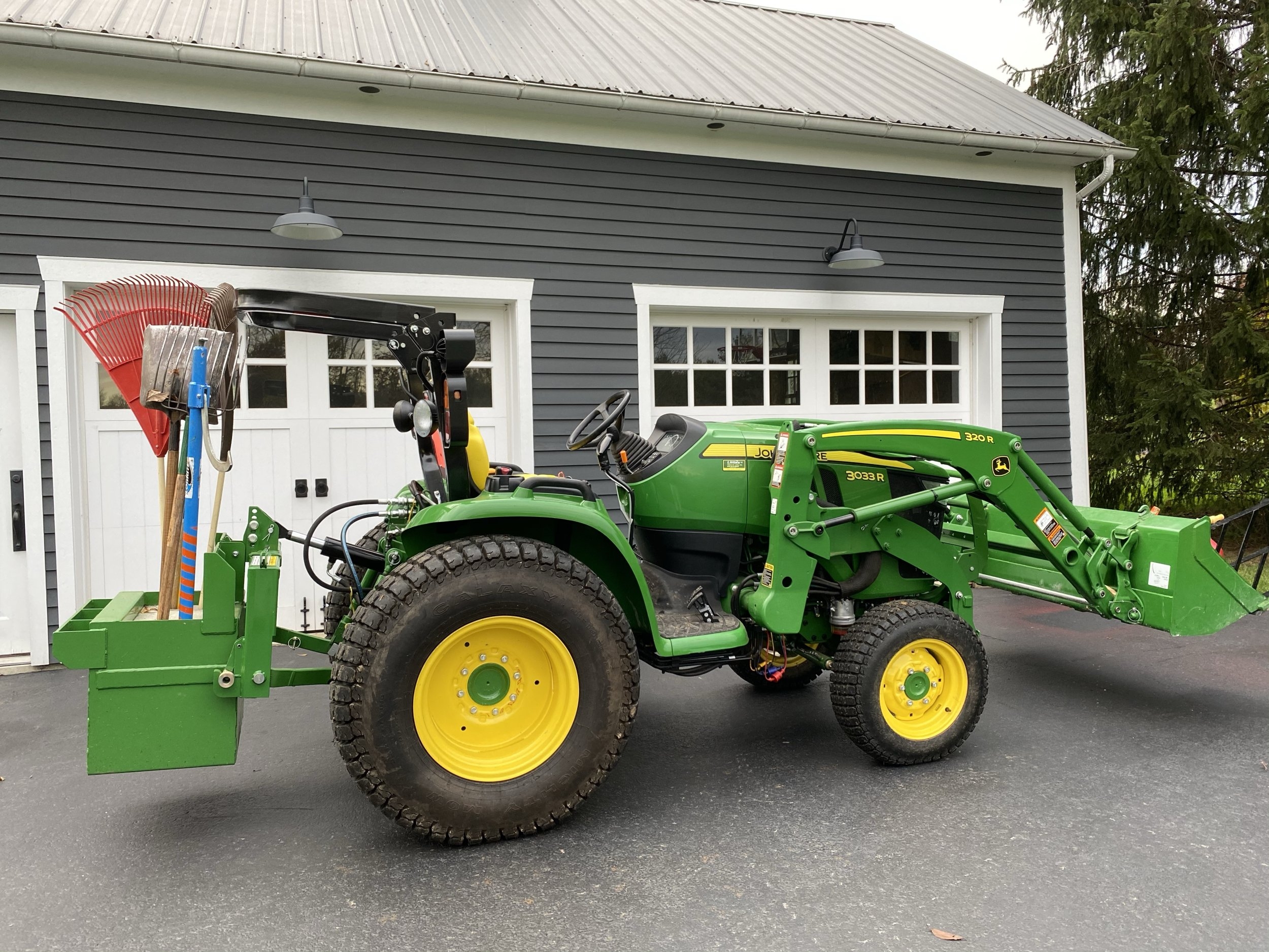

Since I have a ballast box mounted to my machine for most logging and yard work, I use my ballast box for storing hand tools and chain:
Chain usually sits in that top tray, with ends hooked to upper suitcase weight bar.

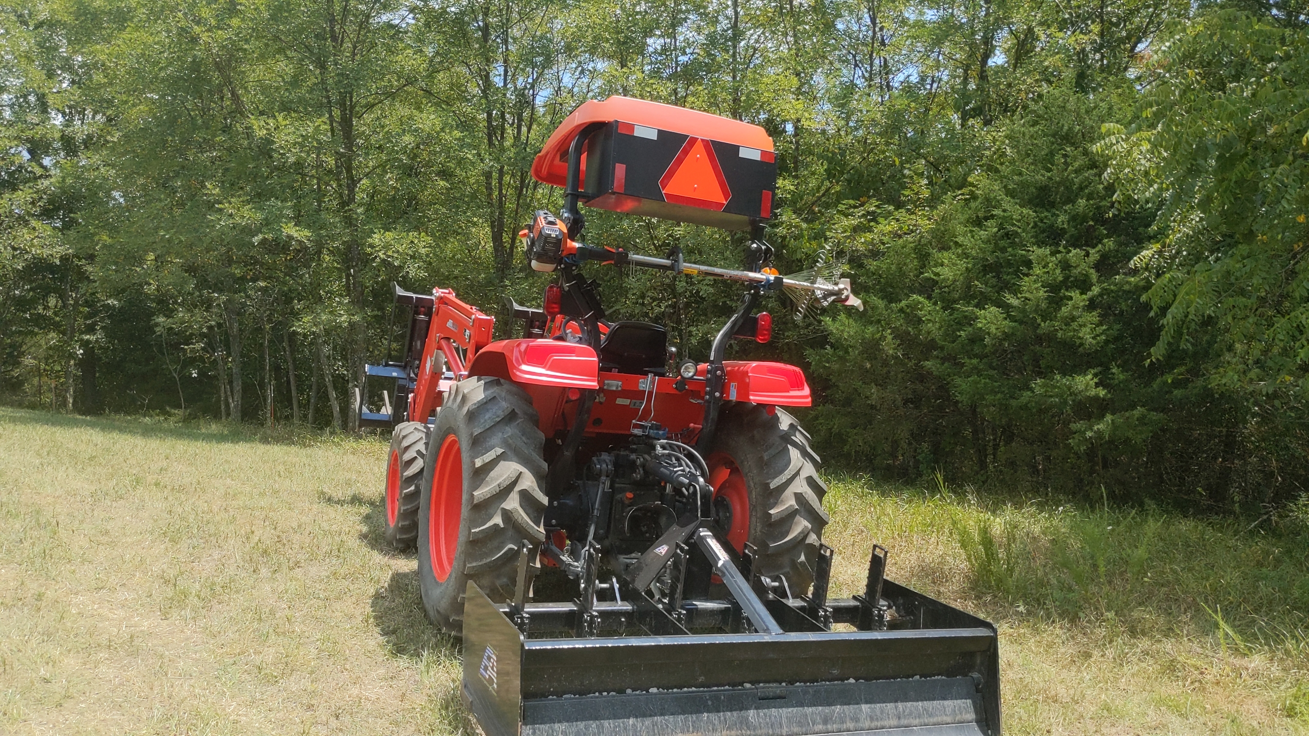

Lots of miscellaneous carrying options with the toolbox. I also made some tool racks that u-bolt to the ROPS for long tools. I try to not load really heavy items into the tool box due to working on hills constantly (high center of gravity), so still thinking about chain storage options.

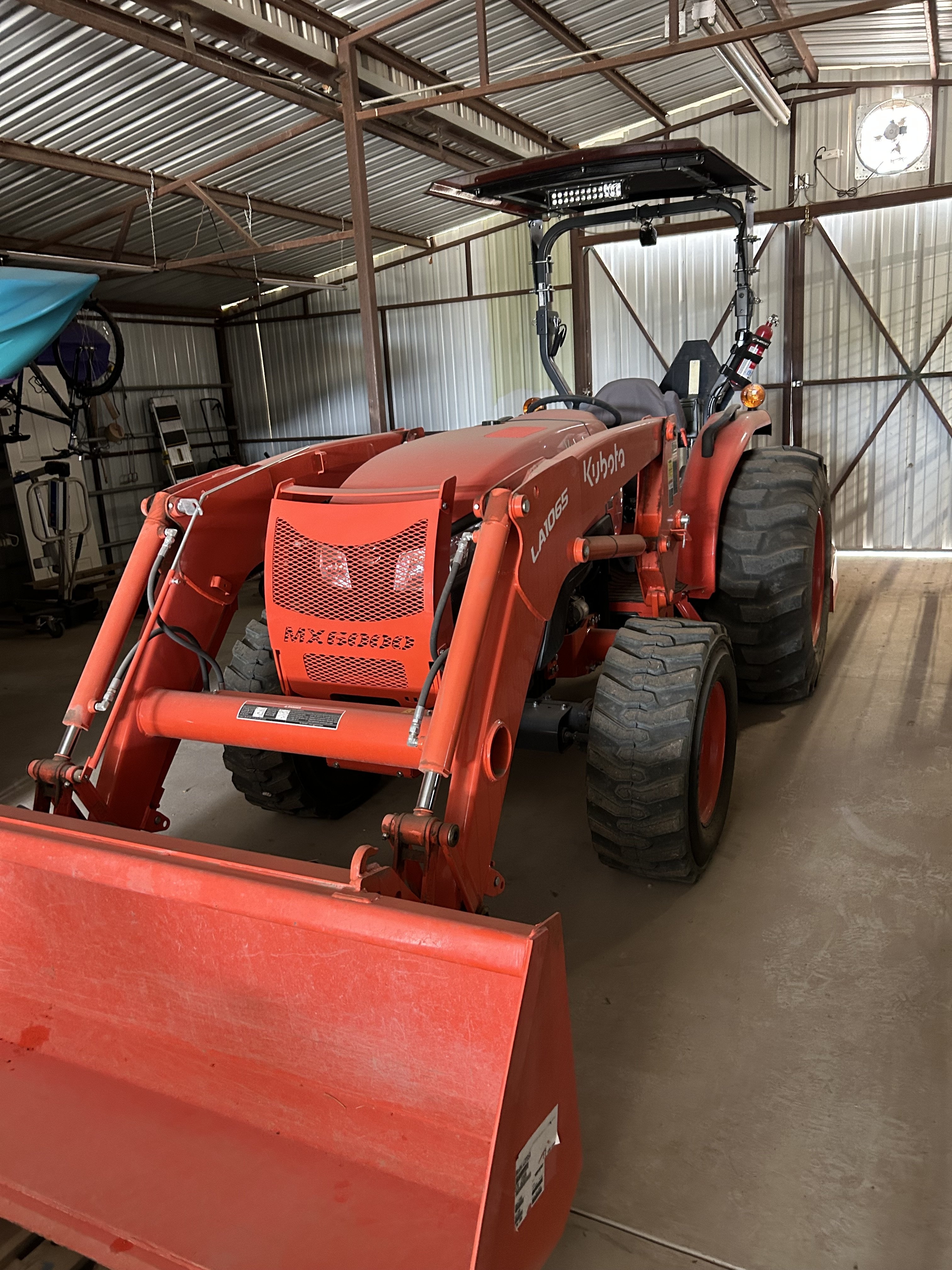

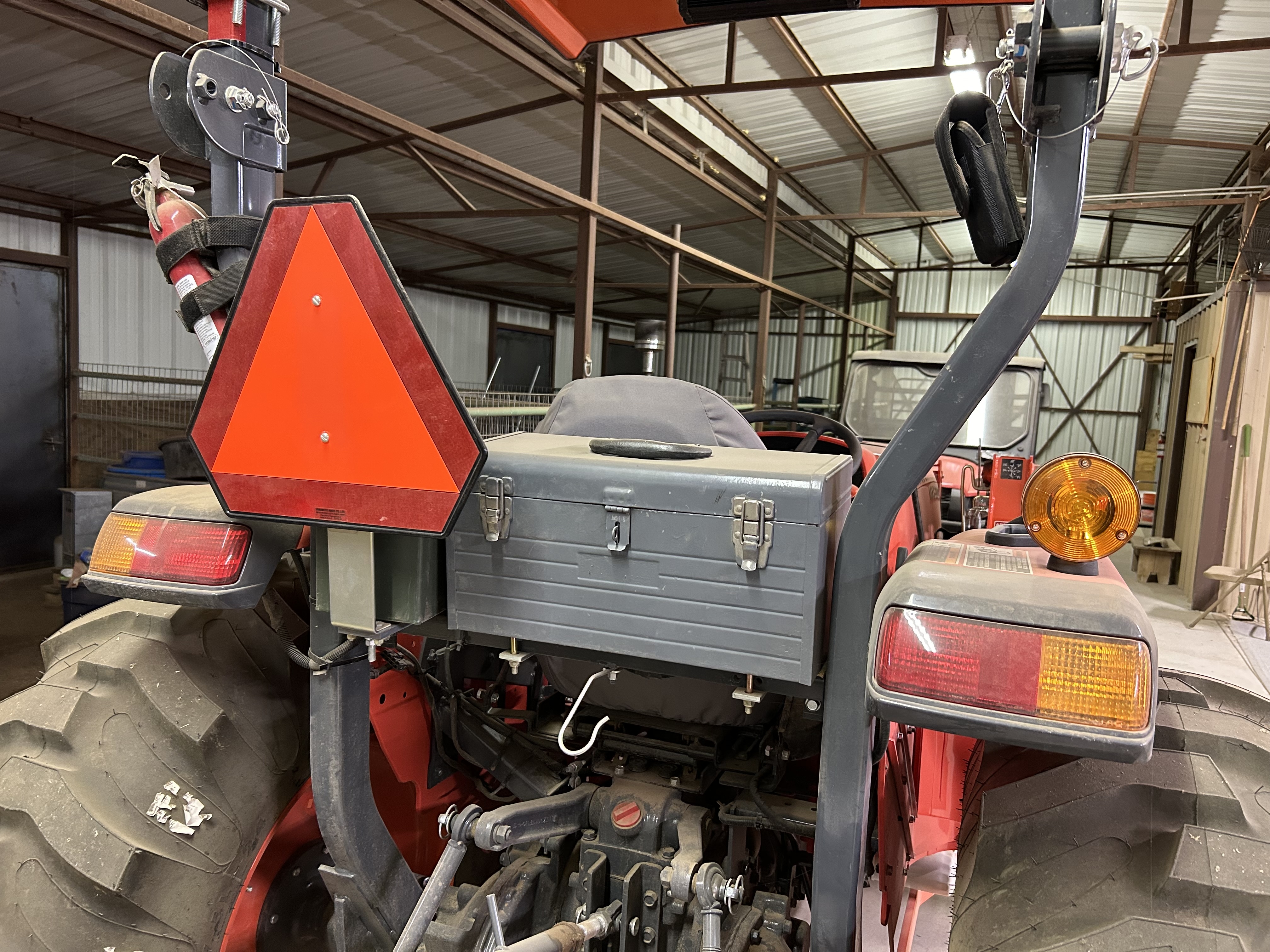

I installed a grill guard and chain bucket combination. I carry a 20’ chain in the bucket below the grill guard. I also installed a steel toolbox on my ROPS cross brace where the useless plastic box was. I carry a 10’ chain in there.

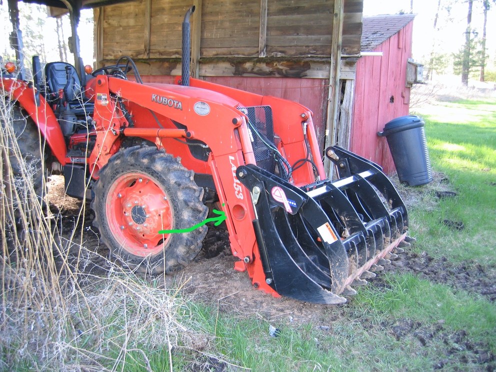

For my use, it is the shorter chains that get the most use. I have at least four six foot lengths with a slip hook and a grab hook fitted to alternate ends.
If I expect to need a chain, I just drape one or more between the three grab hooks welded to the top rail of the bucket.
It does get cumbersome with the 16 foot chains however.
I need to drop size and up grade to 70! ;-)
