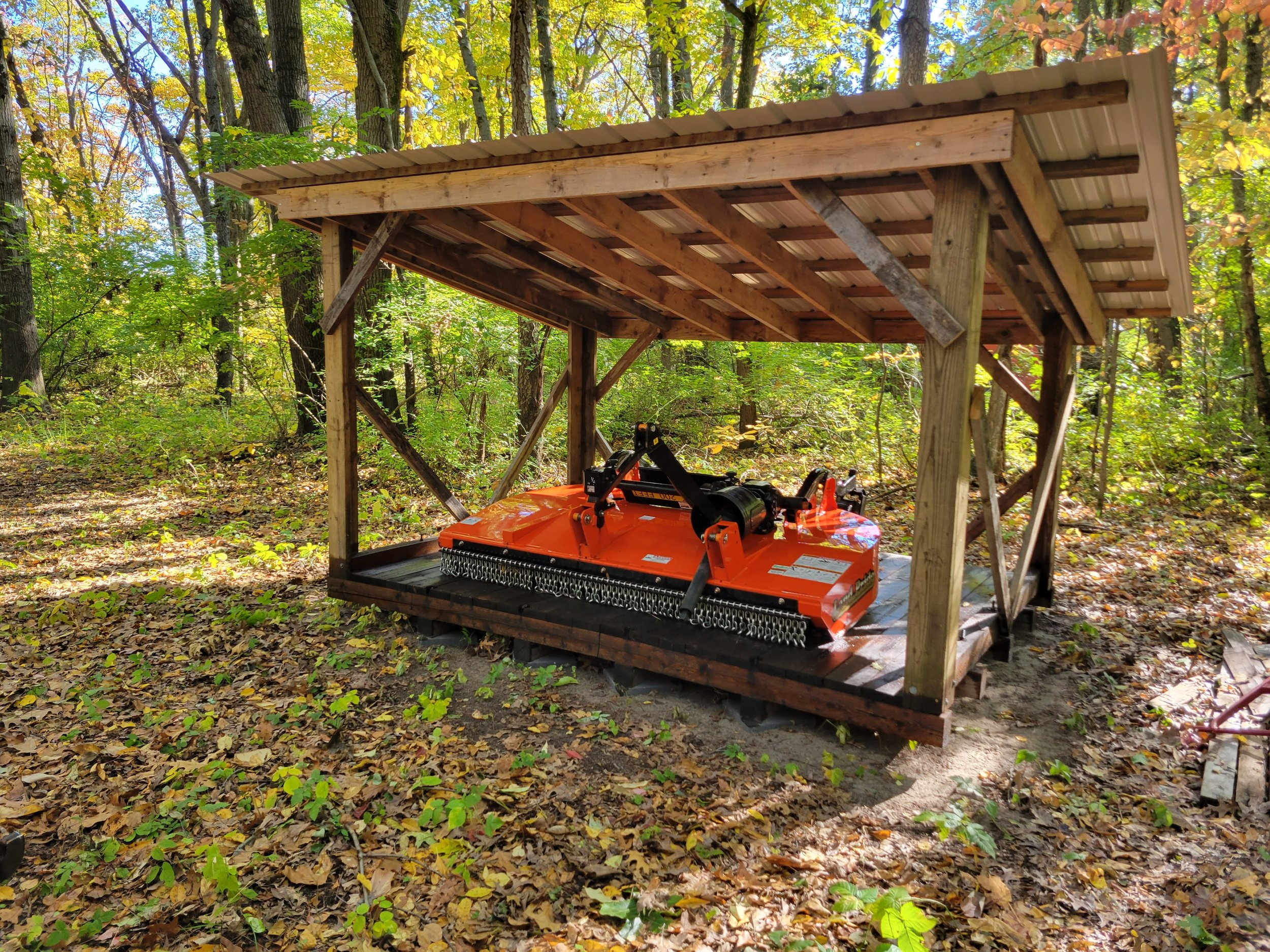

I try to keep everything inside, but what must sit out is:
1. Kept up off the ground, preferably over a paved surface.
2. Has some sort of roof over it. Tarps are bad if draped directly on the equipment, as they can trap moisture. But a roof, even a sheet of corrugated fiberglass just tied in place, is nearly as good as being indoors.
Here's how I store my aerator and brush hog, both which lost their spot in the garage to more expensive equipment:
