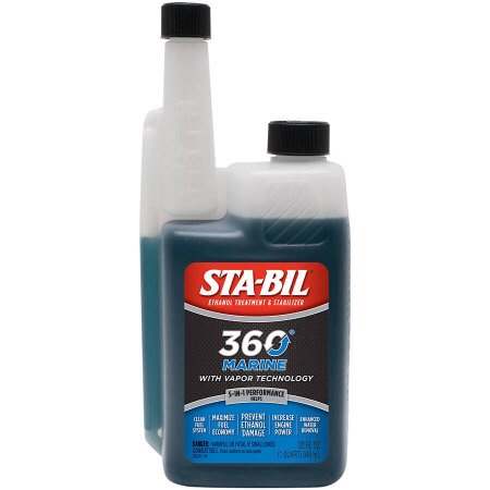

I've been using Stabil Marine 360 for a bit over 2 years and have, so far, eliminated all of the ethanol induced problems I've had with chain saws, etc. I haven't had a fuel line or carb problem on any of my 2-stroke equipment since I started using the Stabil.
I add to Corvette gas tank, which gets driven only few hundred miles a year. I use about 20-25 gallons of gasoline per month for my non-diesel equipment.

I'm not talking about regular Stabil gas treatment? I use Stabil Marine 360. Prove your point!

Prove my point ? Like 'prepare for court' ?
Hey, I gave my opinion.....based on having gas in sealed drums go 'varnishy' after a year using Stabil, and storing it many years with PRI with no degrading. If that upsets you, so be it.
I've never used the 360 version, perhaps they have improved their formula.....they sure needed to....the original version is crap.
Have you ever used PRI ?
