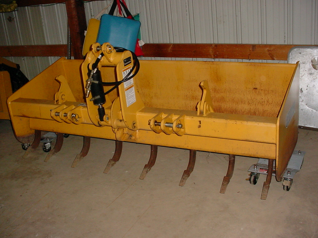

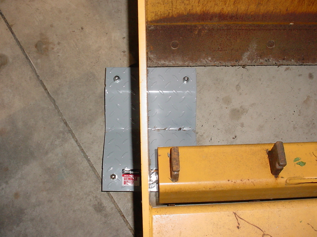

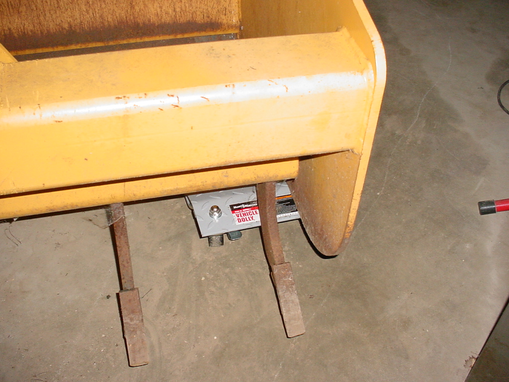

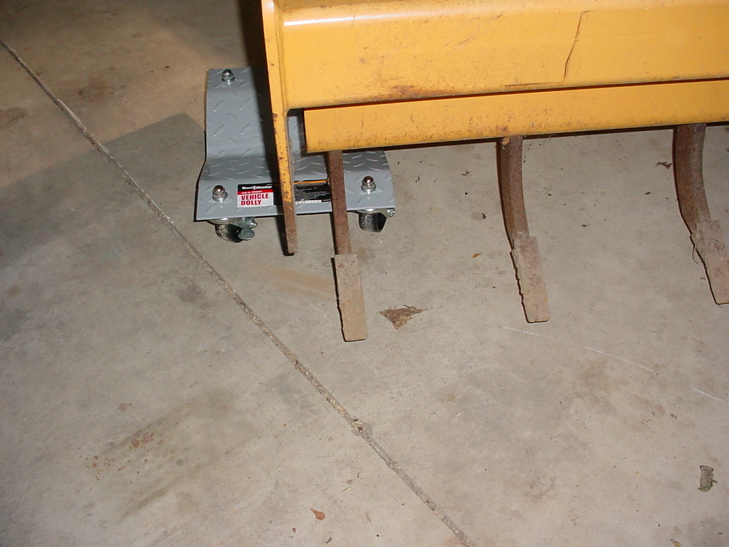

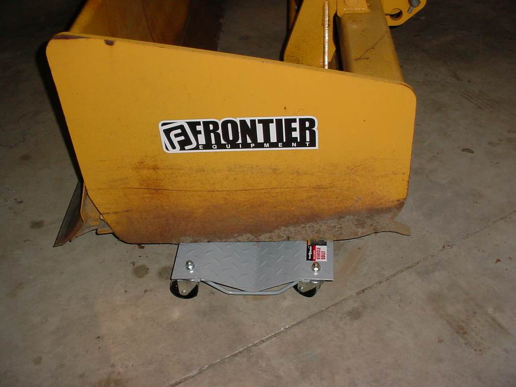

Just an update: Picked up a set of 1500 lb vehicle wheel dollies from HFT. They work great, the box blade rolls with very little effort, not bad for 1260 lb box blade. ($49.95 with coupon for a set of 2) Just remember the 67338 have steel wheels and the 60343 have plastic wheels. (I have the steel wheels)

I use the same dollies on some of my heavier equipment.IMHO they work great on cement floors.

Anybody have opinions on whether the wooden or automotive (shown) dollies are superior? I am using the wooden ones for my land plane and am wondering whether the ones shown above are superior. Does more expensive = better? :laughing:
