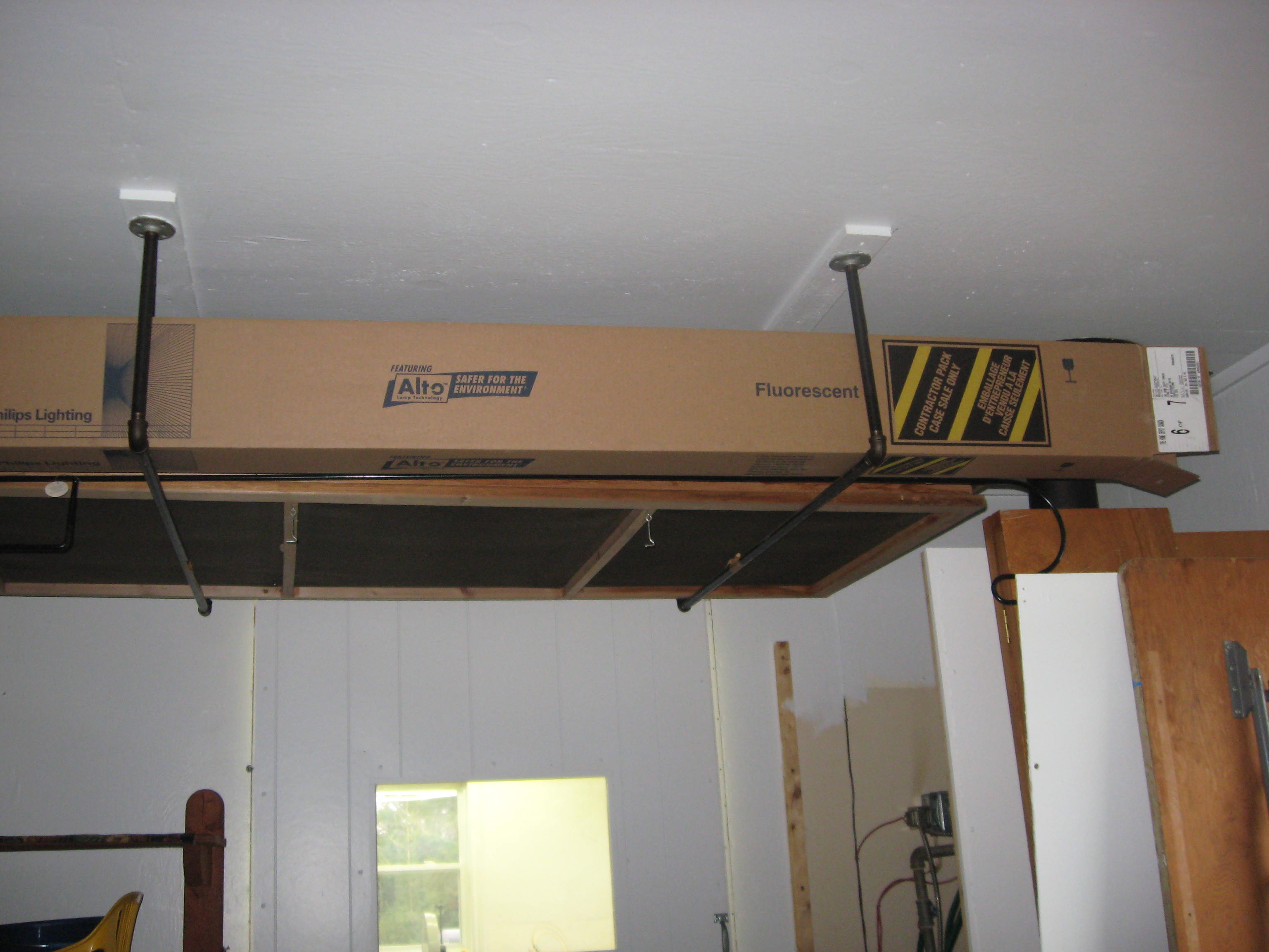

I made these pipe racks for overhead storage. Work great for doors and light tubes. Might be an idea for siding. Mounted pipe to board then board to ceiling because 2x4 are only 1.5 wide and hard to get flange attached directly to it. Just scale it up for the extra load.
Used that option myself for lighter things, but the weight of 15 sheets of 26 gauge from 8 to 18 feet long is a lot more than a screen door and light bulbs. The barn is made of 4x6 posts on 8 foot centers. Thinking the weight might be too much.
Thanks
