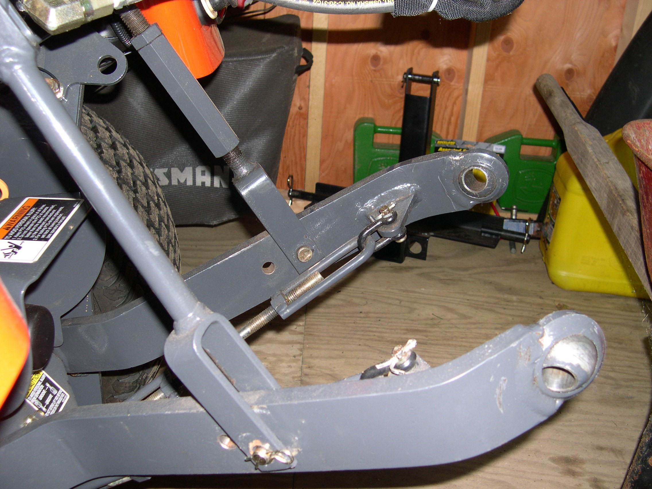

On the newer BX's, there are pin holes on the frame where you can attach the vertical 3PH lift links to so the hitch does not move when your deck goes up and down. From what I recall, I think you have to buy similar pin holes for the older BX's and bolt them on.
Here's a pic of my old BX1860. Note the ear or pin hole just inside of the vertical lift link. Like said, you unpin the vertical links from your 3PH upper arms and pin them to these holes. Hopefully someone with an older version BX will chime in on how that is done on the older models, but again, I thought you had to buy the ear/pin holes and bolt them onto your frame. Good luck.

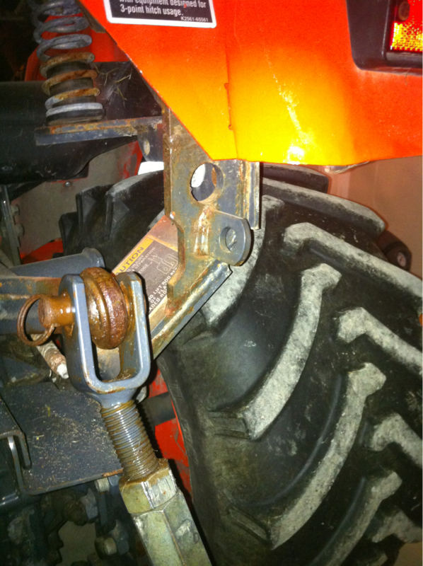

/ Stop 3pt hitch from dropping #8
on a 2003 BX2200 there are lugs on the frame where you can hang the vertical links. I always assumed that this feature was kept on all the BX's. NO????
/ Stop 3pt hitch from dropping #9
They're on the xx50 and xx60 series BX's. Just didn't know if the earlier models had them too.
I never notice these because they are under the fenders and the book says nothing about using them. I have only had my BX2200 for a few months and this site has been an amazing resource. Thanks for all the advise. Now I can mow my lawn without gouging it up every time I back up.
/ Stop 3pt hitch from dropping #11
In August of 2001 I bought my BX2200 brand new. It now has 2850+ hours on it and still running strong. I have been looking at those tabs under the fenders all this time thinking they must be for tie-downs in a trailer? During mowing season I have been taking the 3 pt. completely off the tractor. Maybe this year I'll try switching to those side tabs. Also the coiled ring pin keepers, I Have drilled the hole in the pins slightly larger and use small hitch pins to keep the cross pin in place, works very well.
