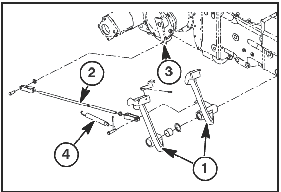

Yeah, a noob... So I try to do "the right thing" and put the parking brake on at various times when i get off the tractor. I have a very steep hilly wooded area I am working in, so it makes sense to me at times to do this. Now last week I managed to forget to pop the brake off 2 times when I got back on. The tractor seemed to complain a bit more from the load, but yet it still moved OK. I'm new to this - I could hear something was not quite right but couldn't figure out why right away. I'm hoping my brain kicks-in so I don't do this anymore but...
So is my brake out of adjustment that it still lets me drive it with the brake on, or is the tractor just strong enough that no parking brake will matter in the end once you step on the go-pedal? In all my cars, if I try to move with the parking brake on, it is MORE THAN obvious, but not with the 3130.

I have three speeds on my HST tractor, and I generally keep it in the 2nd speed range. I have the parking brake adjusted such that I cannot take off when I'm in the 2nd range. 1st range, I can still take off.
Anyway, my point being that you probably need to adjust your parking brake slightly.

Well that was my basic question....but how? I don't see anything on it in the owners manual???

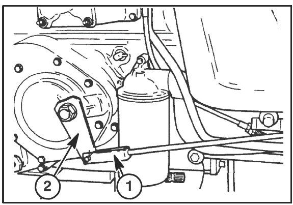

I have a New Holland TC33D, so it's going to be different, but on the underside of the tractor, near the brake pedal, is a linkage to the rear axle. On my tractor, that linkage is adjustable with a nut on the rod.
attachment.php
As I recall, it was at position marked #1, but it has been a while, so I could be wrong. I'm coming down with CRS disease.
Ah, yes, here's a better picture:
attachment.php
Rod #2 in the above picture is what you want to adjust.
Yes, this adjusts your regular brakes as well. On my tractor, the parking brake just locks the brake pedal in place.

Thanks. The parking brake is the same basic format - just locks the pedal down, so I'll look at adjusting it a bit tighter. Right now I am spending most of my time in Low range as the ground is very steep and hilly, and I'm doing a lot of heavy work, so speed doesn't really come into the equation. And I'm new at this.
