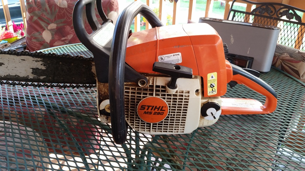

Here are a couple pics:
I haven't attempted to start it yet. I'm sure it hasn't been started in at least a year. I threw my back out yesterday and I don't want to aggrivate it. At the very least I'll be replacing the fuel/oil with fresh when I get around to starting it.

/ Stihl Farm Boss #12
New Fuel
New Oil
New Sparkplug
New Fuel Line
If you're lucky, that might be all you need to do.

That would be a easy one to do yourself. 290
This series really reponds to a muffler mod and carb retune. The muffler are very restricted.
About 30mins to do and retune for a easy 18%-23% free

Thanks, A coworker just modified the muffler on his cheap Poulon Pro and it made a HUGE difference on how it starts and runs. I will be making a modification to the Farm Boss also. What adjustment will be needed to the carb? More fuel I assume.

New Fuel
New Oil
New Sparkplug
New Fuel Line
Good start before you pay someone else.
I have a 310 I bought at a pawn shop for $160 many years ago because they couldn't get it to start. I thought it was the worst starting chainsaw I ever had owned or used. Found out that was not the case, these chainsaws get flooded very easy when using the choke. Unlike cold starting most 2-stokes where you leave the choke on until they fire if you do this you will likely flood the Stihl and then you will be pulling the cord until you are winded.
This works for me and my 310 will almost always start on the third or fourth pull.
Choke on, two pulls on the rope. Choke off it should start right up. Good luck.
