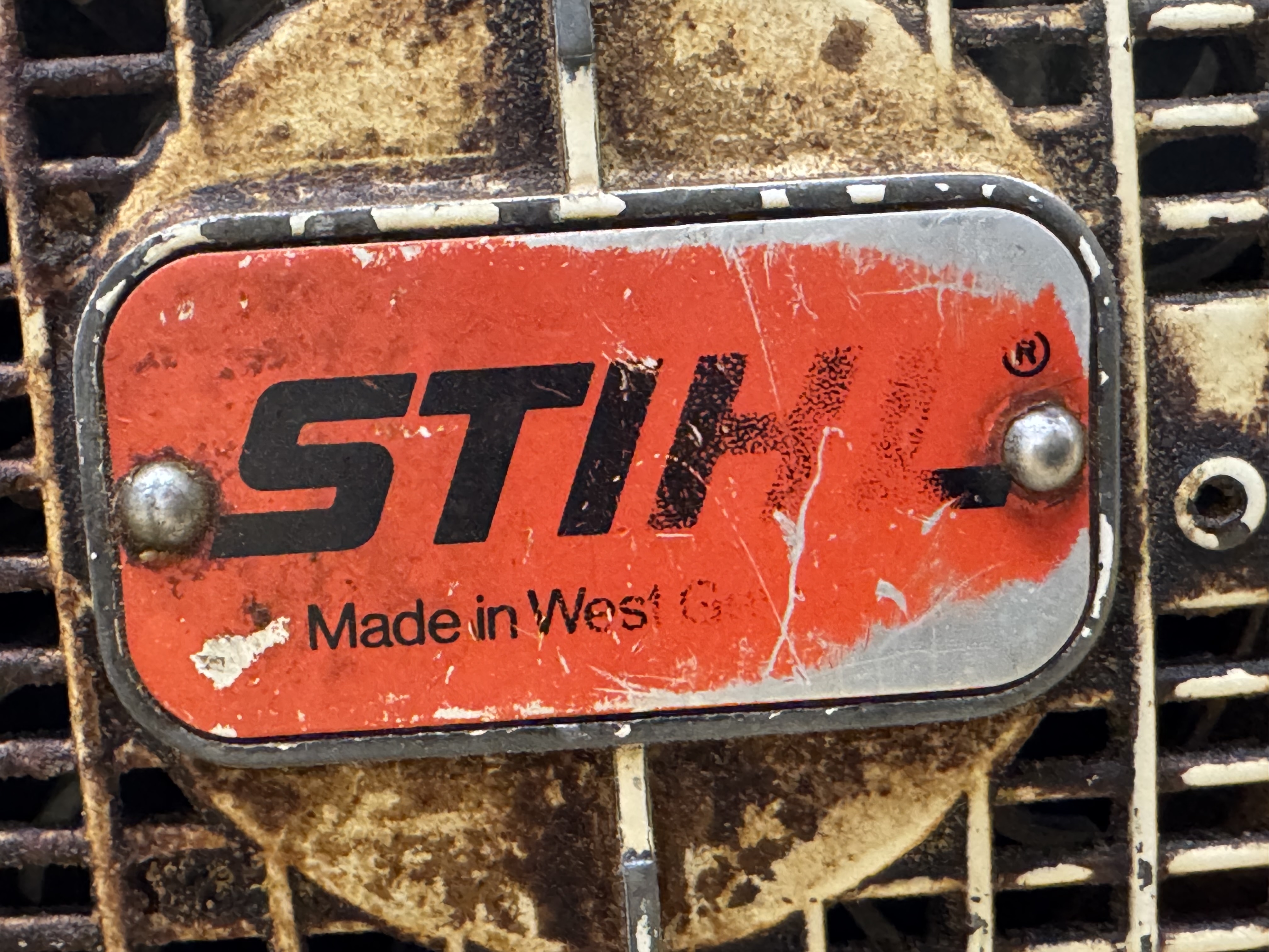

If you're using the saws with any regularity, and aren't super budget-conscious, the pro saws are a nice way to cry only once and smile ever after. I currently own and regularly use a pro saw (Stihl 064 AV) marked "Made in West Germany", if you want some idea of just how long they last. I suspect the damn thing might outlive me, if the ignition module made of unobtanium doesn't die first.
