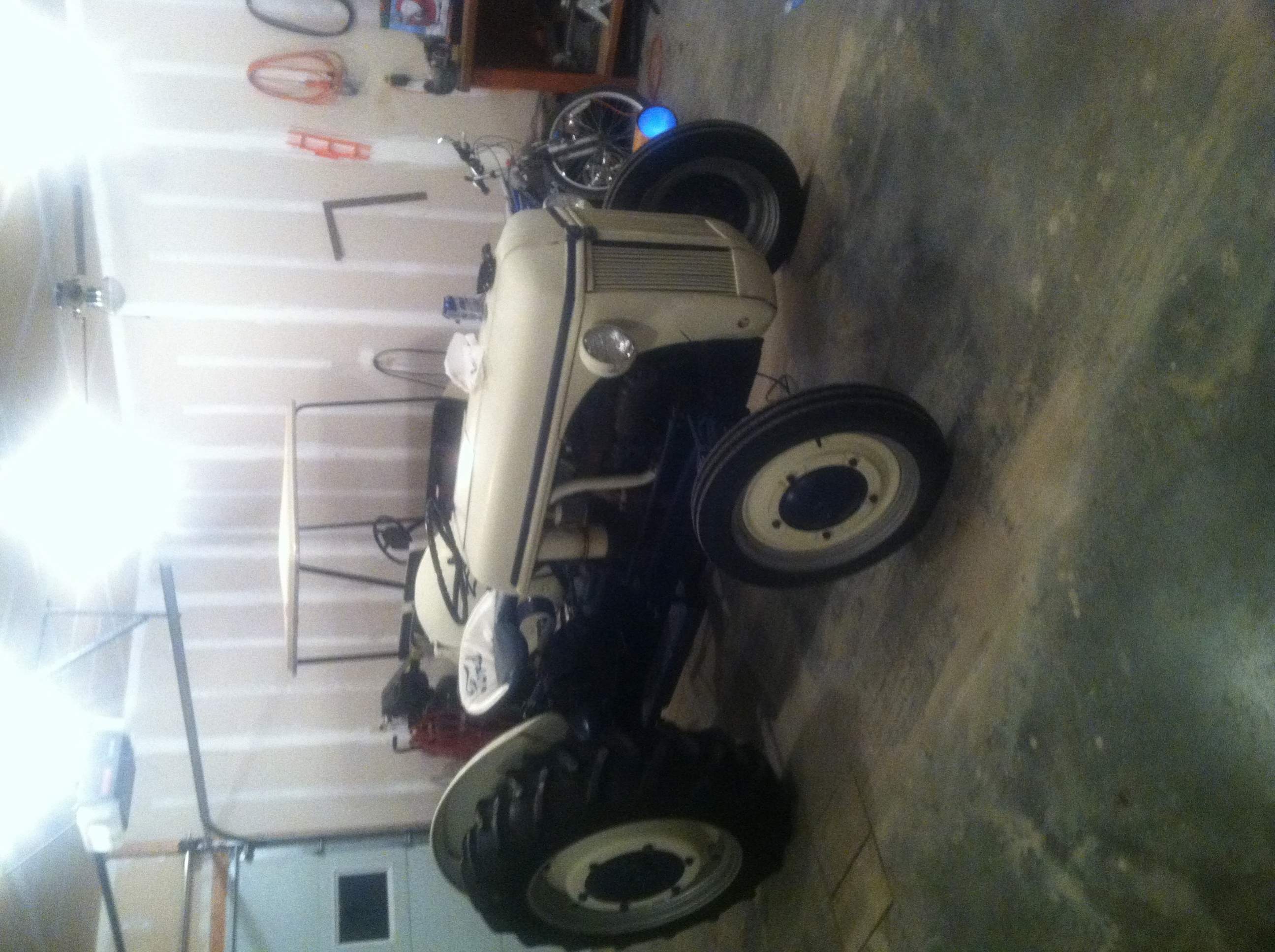

I will try and post some pictures, seems it is not possible using my iPhone. image.jpg
   / Sticky clutch 2N
Ha, I figured out to post a picture but they are not right side up....
