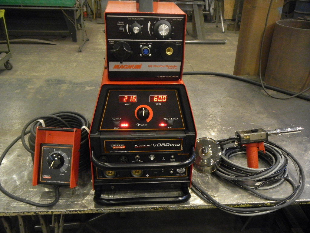

Never seen one of them, but I have it's big brother, best machine I've ever run! :cool2:
