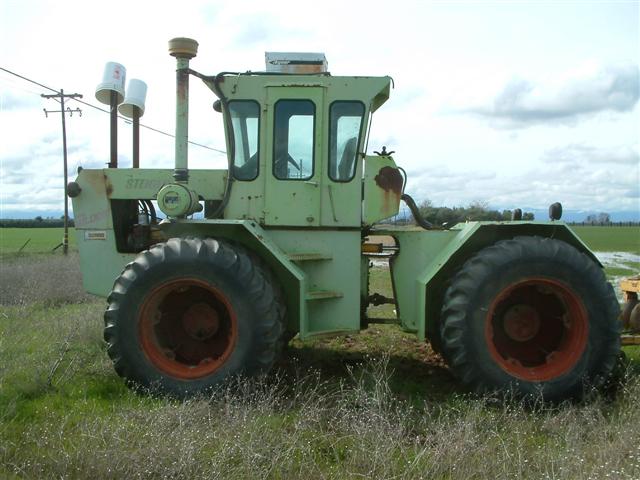

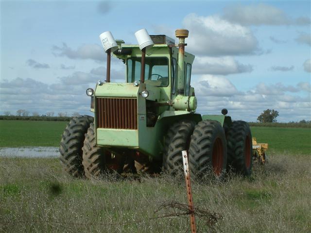

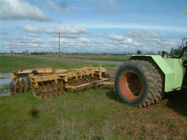

My neighbor has a Super Wildcat powered by a Cat 3160 diesel. He farms about 200 acres of hay and uses the Steiger to pull a 15-ft offset disc for primary tillage.
Good luck and post photos of your new toy.
