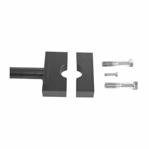

Need either copper, aluminum, or UHMW v-block covers for your vice jaws to clamp the rod without marring it. It looks like the piston is 2 pieces jam nutted together on the end of the rod. May need to make a couple clamp wrenches from aluminum bar stock. Think barrel wrench if you are familiar with gunsmithing. s-l500.jpeg

Need either copper, aluminum, or UHMW v-block covers for your vice jaws to clamp the rod without marring it. It looks like the piston is 2 pieces jam nutted together on the end of the rod. May need to make a couple clamp wrenches from aluminum bar stock. Think barrel wrench if you are familiar with gunsmithing. View attachment 569561
Piston was just sitting on the tapered end of rod. Got snug from the pressure. I used a bearing pull to break it free. Worked perfectly.
