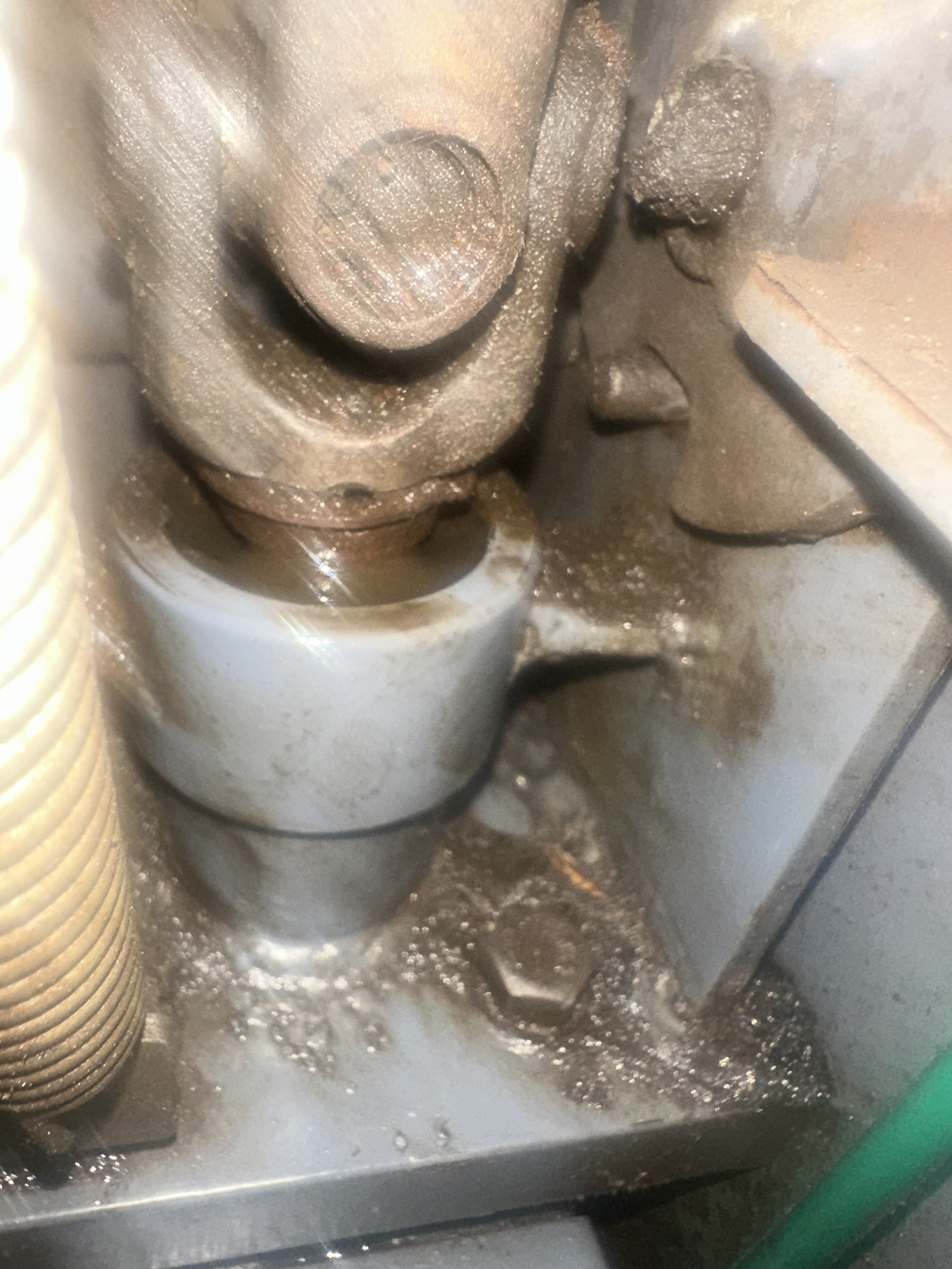

Hi, I have found an oil leak on my Kioti ex45. It is weeping from above the steering mount and from research so far I guess it is the steering orbital value unit below pushing oil up. It leaks more severely when I steer. I am wondering if anyone can recommend a replacement after market options to as a prices for OEM part look very expensive, I see many similar looking units but not sure if they would fit . The Kioti official part seems to be thousand euro plus. I also understand seal kits are impossible to find, unless anyone knows. Thanks
