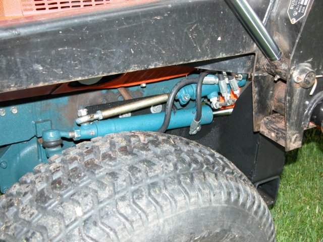

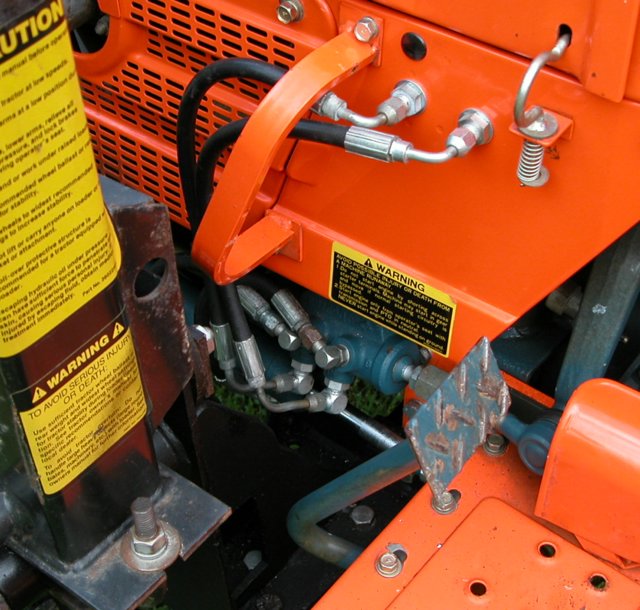

I may have the pitman arm... I had a B8200 that I installed a power steering kit on years ago, and kept the arm. If you still need it, I can look and take a photo to make sure we are talking about the right piece. Send me a PM if you want.

The power steering was a Kubota kit, no longer available (for many years) but the original steering box was used- this was a new hydraulic link, with a proportioning (?) valve and hoses, etc. The hydraulic link replaced the pitman arm. I found a couple of old photos showing this...
