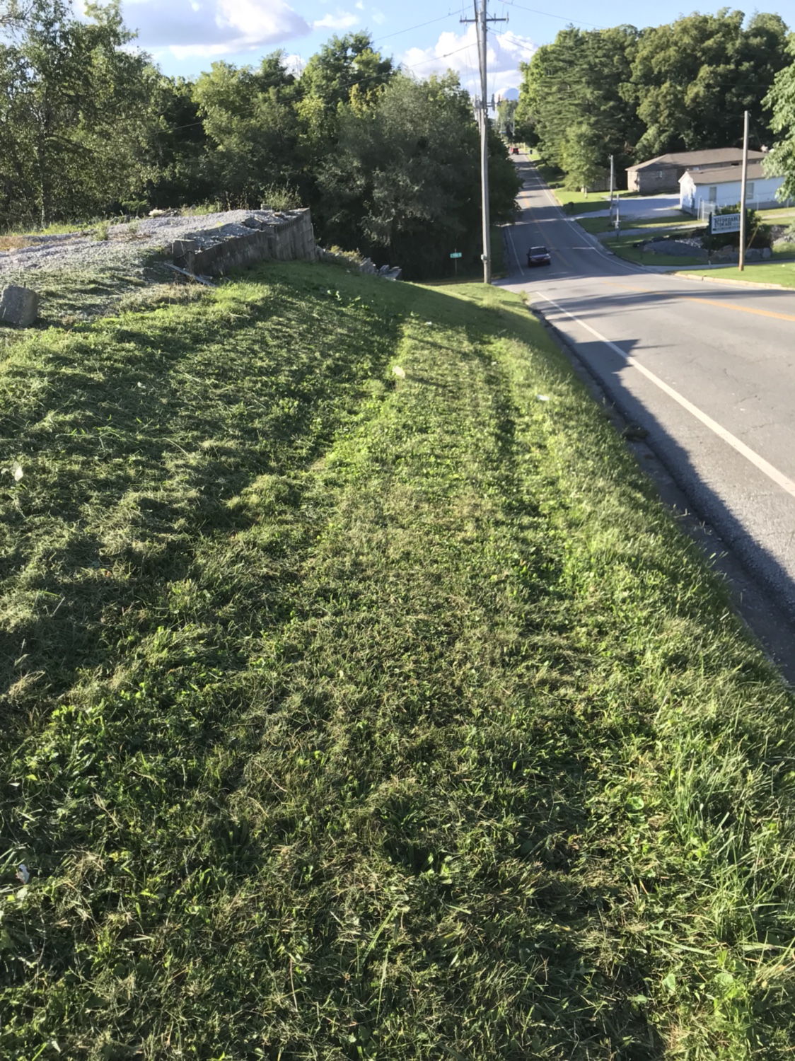

I mow double that or more on my ZTR. A commercial ZTR with bar tires and an experienced operator is a pretty capable slope mower. Get a light duty ZTR with turf tires and an inexperienced operator and it痴 easy to see why they have a bad rap. This hill is pushing the limits of what I値l do with a hazard at the bottom. If the bottom transitioned into level area I壇 go steeper.View attachment 572454

The bottom of the hill towards the road is a lot steeper and has a curb on it. As long as you could access the hill without having to drive down it and the pond wasn’t really deep right at the start I’d probably do it.

I got a chance to measure it today. The steepest part I mowed is 23 degrease. The bottom towards the road is 28 degrees. 20 degrease is well within rollover range. Most people are terrible at guessing the slope of a hill. Anyone claiming to operate sideways on more than a 20-25 degrease hill is probably wrong about the angle or made substantial modifications for better stability.

It’s the hill pictured in post 24. The narrow way which is the up/down the hill part is wide enough to make 2 passes with my 72” mower and not hit it all and the other measurement is probably 150 feet.

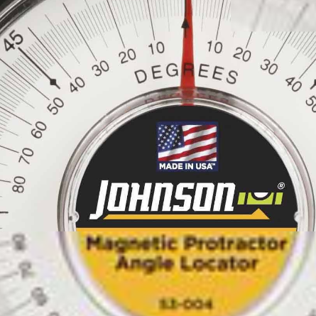

I measured mine with a angle gauge set on a 8' chunk of angle iron laid on the slope and it measured between 20 and 25 degrees. I don't know that its a perfect measurement, but its not just a guess.
