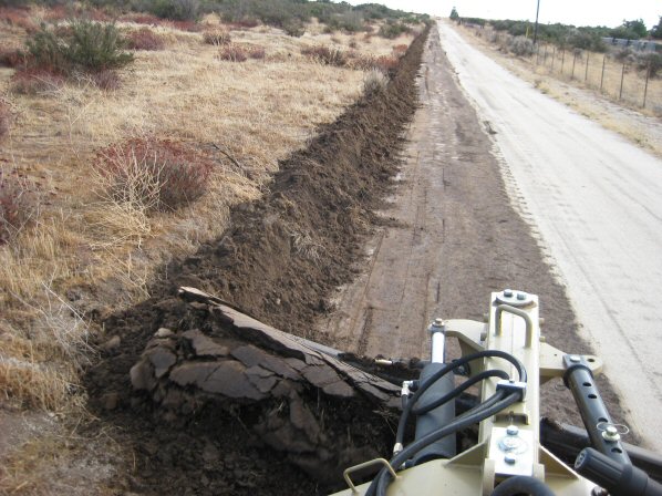

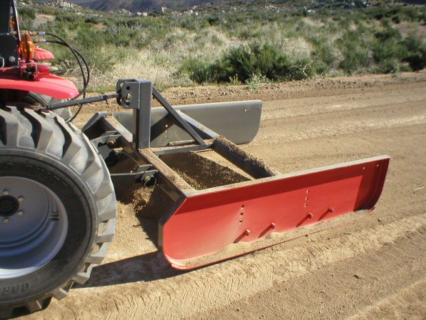

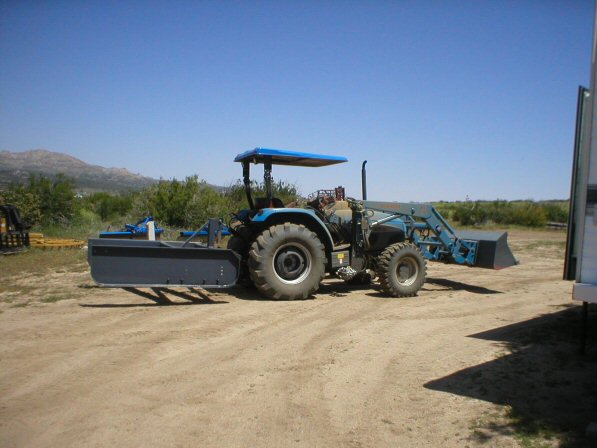

Kim, both my 5 foot and 7 footer grader blades currently have the cutting edges 1 inch below the side runners. I have a Land Pride RBT45108 (9 footer) rear blade. My 75hp 12,000lb tractor is at the low end of this blades capabilities. This rear blade is rated for a 125hp-15,000lb machine. Two years ago I bought that rear blade with no hydraulics for around $3600. Added welded hydraulic cylinders myself.
I maintain just under 2 miles of road and the roads vary from 12 to over 24 feet wide. Most of the road has enough crown in it that if I were to go much wider than my 7 footer I would be working against myself. But that is just me with the conditions that I have to work with. I am very happy with my 9 foot blade. I usually only have it at a 25-30 degree angle. When smoothing the road, do you ever run the tractor in reverse and use the backside of the blade? Sort of like a dozer blade with the cutting edge in reverse. I have found that this works better than pulling the blade in reverse.
For your size tractor, I would definitely build a grader blade with 24" sides 6-8 foot long, 3/8" thick.
Good luck

The grader I built on page one of this thread has the blade flush with the bottom wear strips. I found this worked better for my purposes since the runners will compress the soil some and still allow you to shave the material off the surface. My thoughts on the depth of blade settings is that I wanted to plane off the material that is above the side runners and leave the material below the runners. Even with the blades set flush you can load up with material within a fifty foot pull in gravel driveways or tilled land. It will shave off any high spots as needed and drop into low spots as intended.
I agree with Brian on having long skids, this equates to "The longer the straight edge the straighter the line" theory. I could easily see a 10' wide plane with side skids 8' in length behind a 100 hp tractor. For open areas that you want to smooth out such as fields, lawn areas or parking lots the wider blade makes this an easier task since the longer (wider blade) will do a better job of averaging out the ground.
How deep you need to cut depends on what you need to accomplish. If you need to cut through the surface to remove pot holes and remix the material on a road a lower blade setting will allow this to happen faster. To handle this sort of task I use my boxblade with hydraulic rippers and can move alot of material fast. I can then smooth and plane the road with my landplane to a nice finish. For most driveway and gravel road repairs I do the landplane is all I need to smooth the road surface. I find the rear blade and landplane are used more than the boxblade.
For anyone building a grader/planer I think that it is very important to make sure it is built stout enough to limit flexing and twisting as much as possible. To accomplish this I feel that box tubing in large dimensions with thick walls works the best. This also adds weight and ridgidity at the same time.

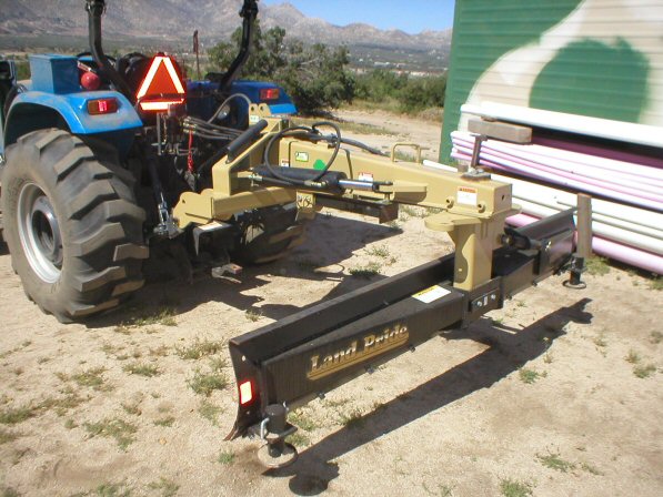

Kim, yes the Land Pride RBT blades comes set up for the hydraulics. I don't care for tie rod cylinders, and that is what LP comes with. I had the welded cylinders before I had the blade. Now after I mounted them and made the hoses for them, I took off the offset cylinder because I do not have enough remote valves yet.:( I need 4 remotes and I only have three.:ashamed: The other 2 are used for the Top & Tilt. If you look close in the picture, you can see that I only have one hydraulic on and the offset is a manual telescoping cylinder with pins that came with the blade.
Yes Land Pride has 10 foot rear blades. Either an RB55120 (1454lbs) or what I prefer, an RBT55120 at 1753lbs. :thumbsup: Both are rated for 180hp and 15,000lb tractors. ;)
