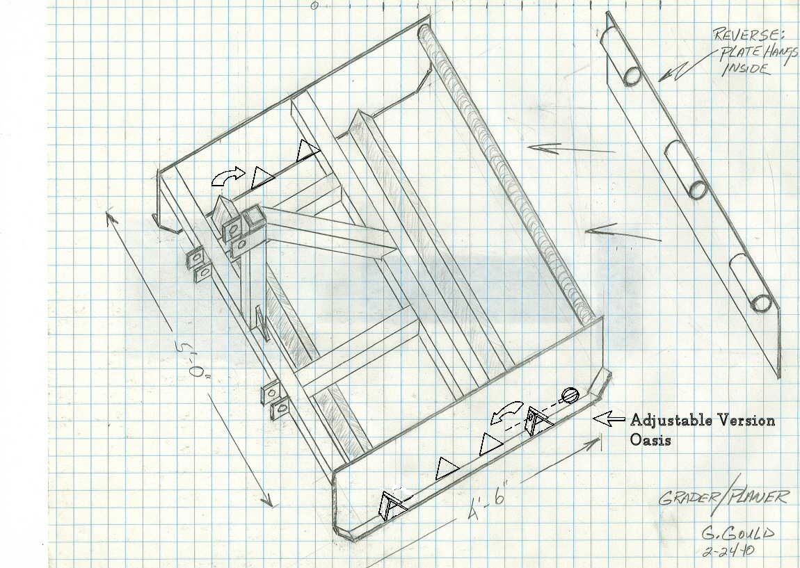

Ill offer one simple idea for making the angle adjustable without adding much cost or effort (See adjustable version image)
Prior to adding the skid plates cut 4 triangles (on each side plate) that are a bit bigger than the angle-iron cross-section.
Then after the frame is welded together the angle pieces can be inserted through the side plates either straight across or at an inboard or outboard angle.
The angle needs to be long enough to protrude an inch or two out the sides. Holes at each end of the angle would allow pins to hold the angle in place.
Im guessing the frame would be plenty strong without needing to weld the angle in place. If not some brace/gusset could be added to the frame.
I think some extra work to make it adjustable for crowning... would be worthwhile. So if folks could offer other ideas Id also like to here them.

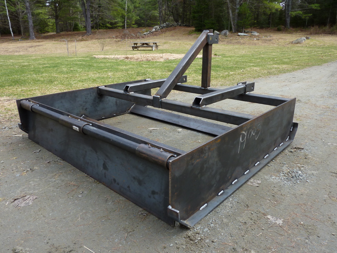

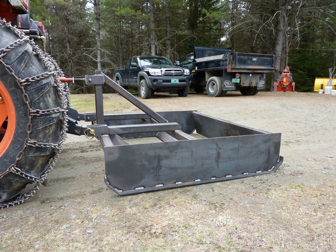

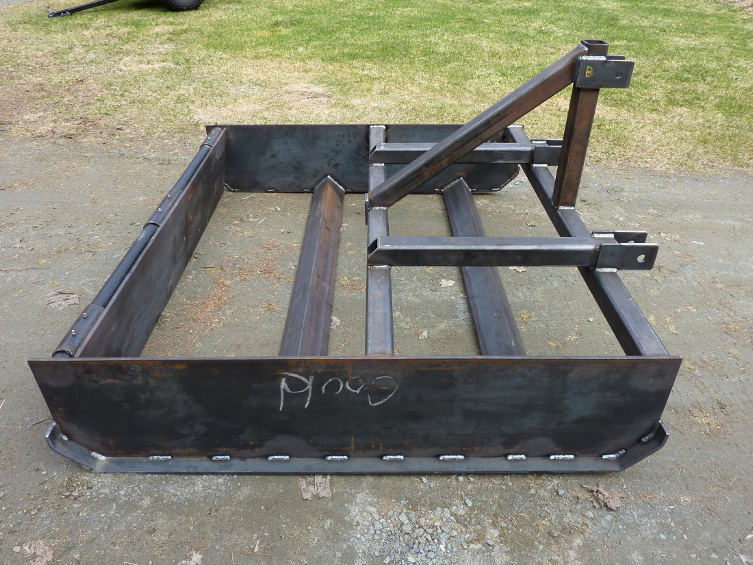

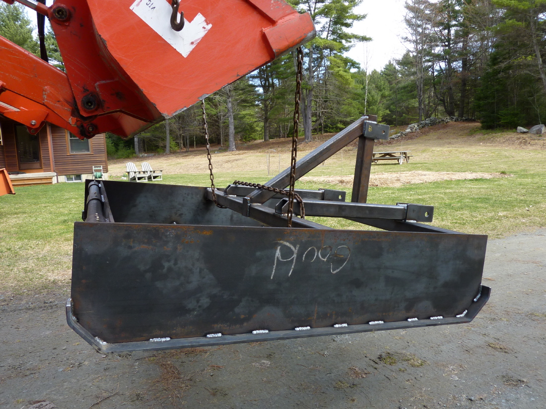

Got the welding done today. I brought it to a shop and we worked on it together - I was the gopher. I thought he did a super job for me. When we loaded it on my truck we found the balance point was exactly on the
middle cross member. I told him a figured it that way but it was just s_ luck.
However it will make life easier.
The frost is still coming out of the road so it is still to soft to grade but I
feel like a kid a christmas wanting to try my new toy. I did try it on a short section near the door yard. I think it will be good.
I have to add a stop for the tail gate so if I flip it to hang on the inside of the stop it will be like a box blade of sorts. If I flip it to hang behind the stop it will just be a drag. Might be a place for a cylinder if it works good.
