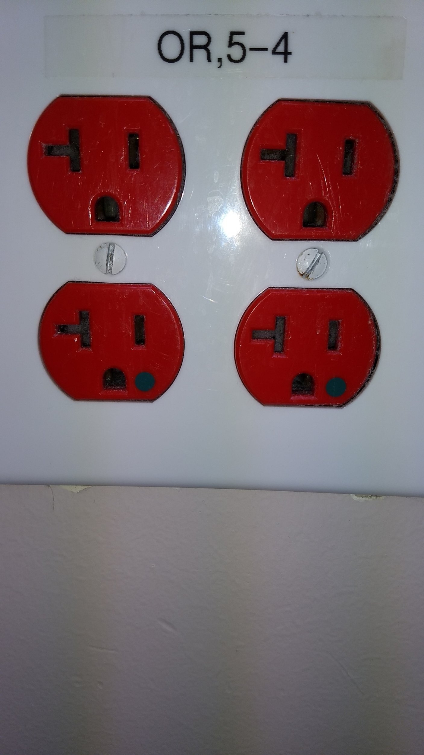

   / Status of Everything Attachments #1,278
I've always see the ground down in residential and up in commercial and hospitals. Ultrarunner?
The inspector wanted Ground Down at the Hospital...
Red signifies tied to emergency generator circuit and the green dot signifies hospital grade…
