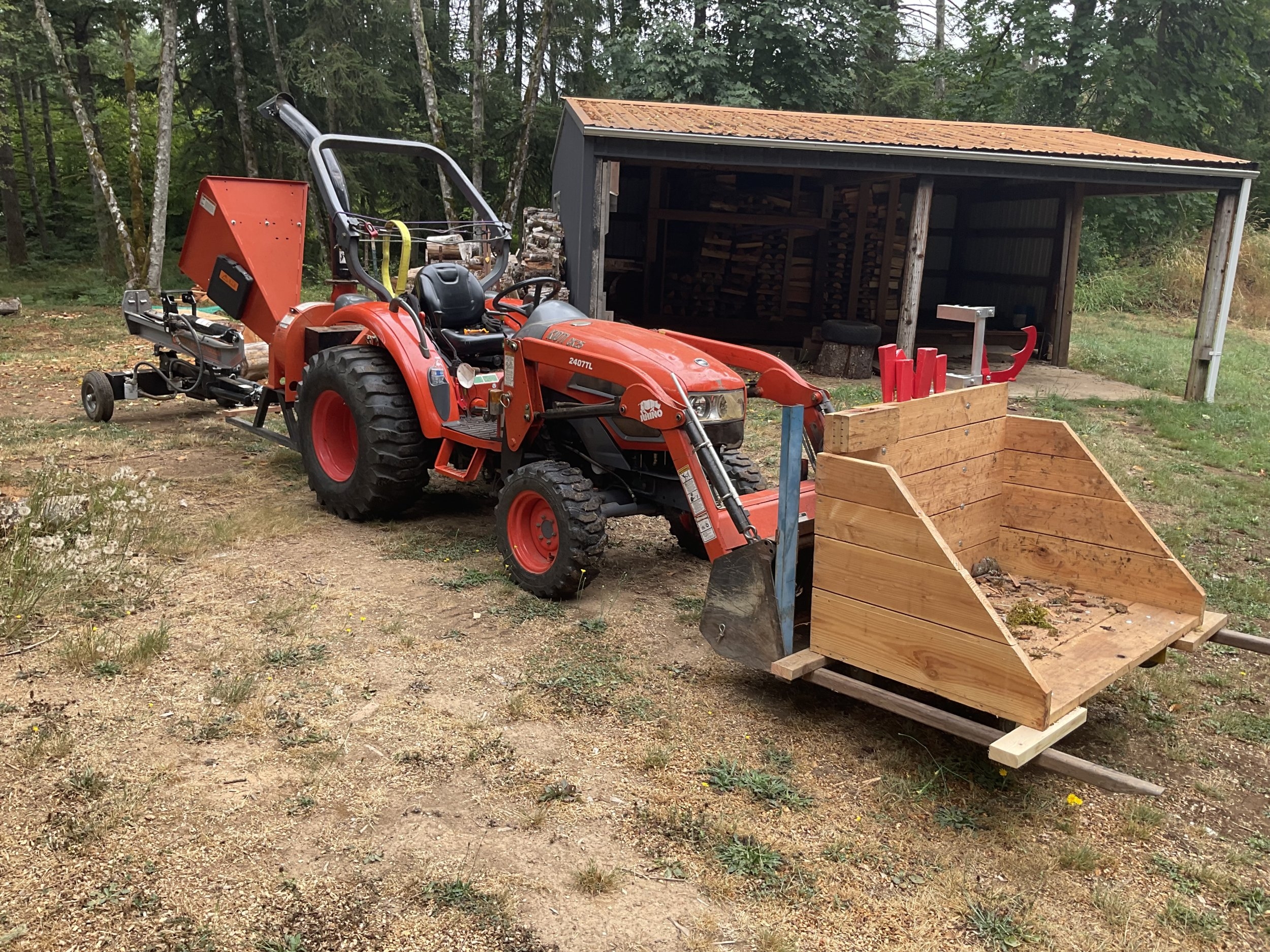

I guess I forgot to mention the last time I had that problem we didn’t get new gears we rotated each gear 180 degrees and that worked for about 250 hours and then the other teeth broke ( if that’s the problem)
Is the member Mike ( the pump guy )?
He said cost to rebuild 470$ minimum hopefully I can just get the gears and do it myself! Does anyone here know about getting the gears for the Kioti Injection pump?

The problem was 3 broken gear teeth on one gear, already ordered a new and improved set, and the gaskets. We should have everything in about a week!
The company I did business with is. Moose Diesel out of SC they have the parts in stock and will ship tomorrow 👍🏻👍🏻👍🏻.

As of yesterday 5/11 the Kioti is back to work.
I found a great mobile diesel mechanic!
He showed up on time both days and got it fixed, no drama!👍🏻. And Moose diesel came through with the IP parts! Great company to do business with! IMG_3690.jpeg
