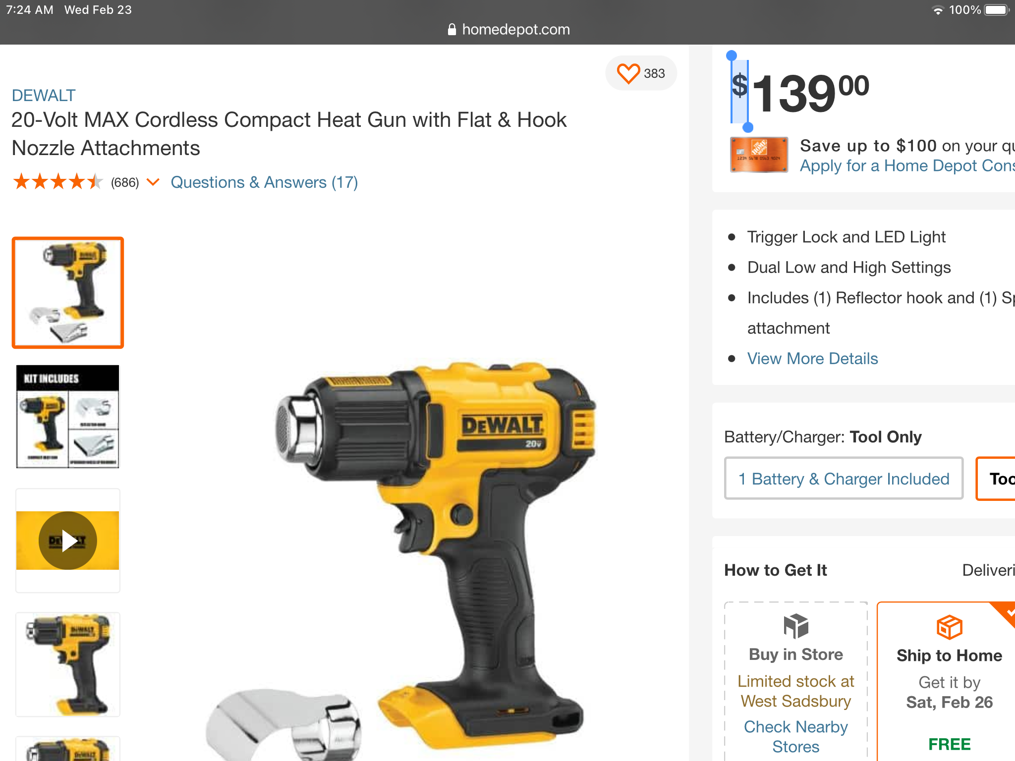

Just take a heat gun or blow dryer and heat up the intake manifold for a few minutes. It'll fire right off.

I keep my painters heat gun on an extension cord nearby too.
It can be one of several starting aids. Works well on smaller tractors.
Never bothered to check if DeWalt makes a cordless heat gun…..
On edit:
I might just have to pick one of these up. My ZD331 is a cranky starter when cold.
