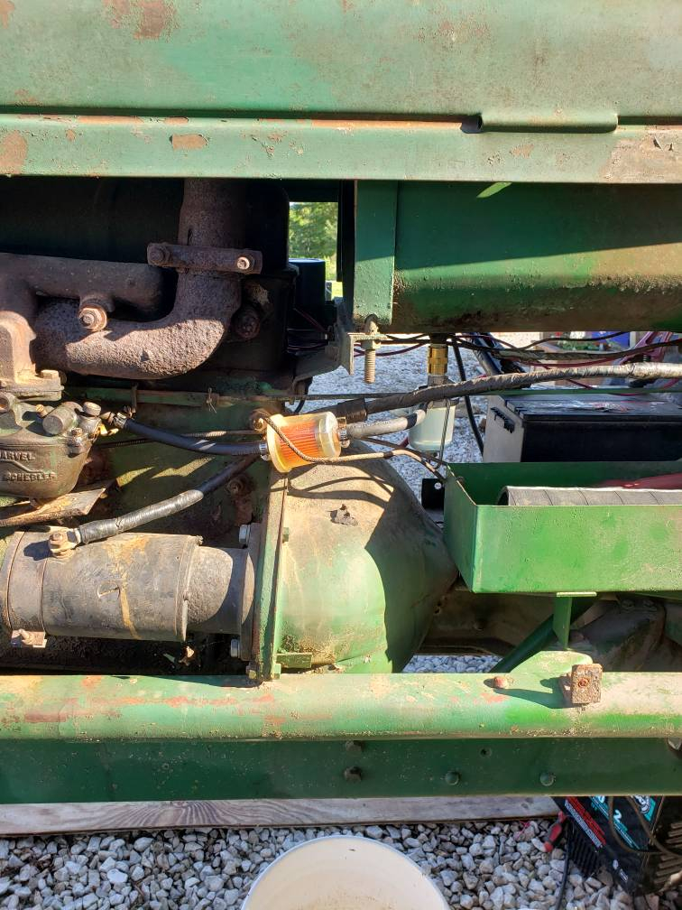

Need help.
Does the fuel line look right ?
It will start and run for a couple of minutes then die like it is running out of fuel.
Can't find out why it is dieing.
   / Starting a new adventure with a oliver 60 row crop. #18
Possible that the fuel supply valve above the sediment glass is pinched too much.

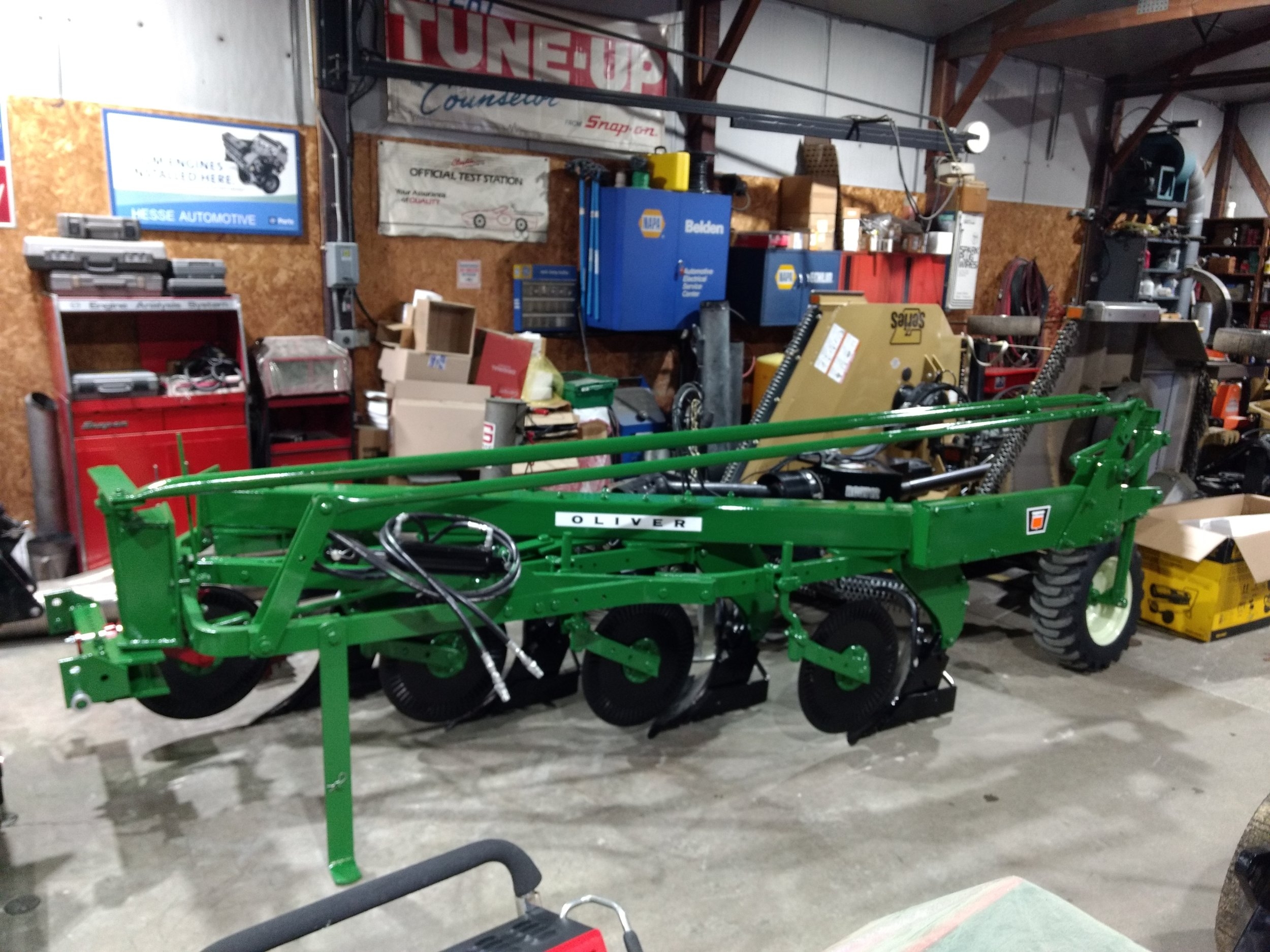

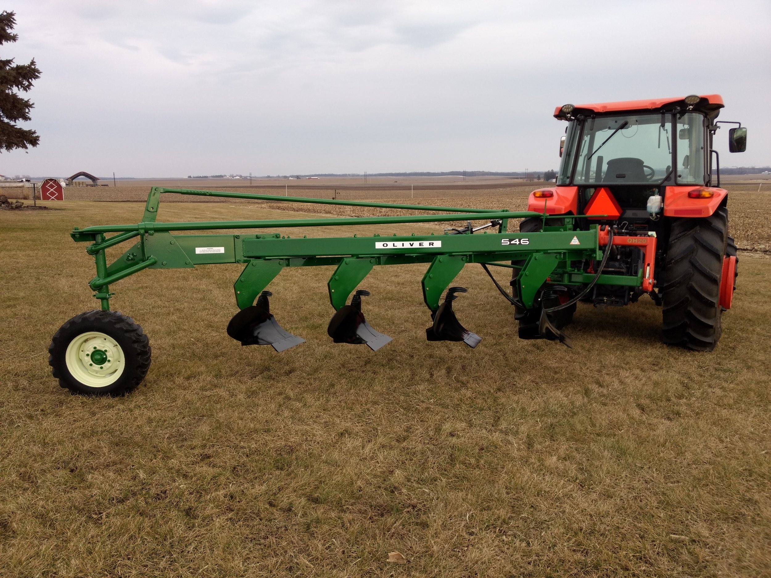

I can't say I have experience restoring an Oliver tractor, now an Oliver plow is another story!

Bet there is debris in the tank. Someone added the inline filter to help. Blow a puff of air back to tank but eventually will want to pull , clean and coat tank.
