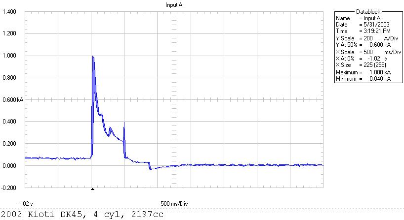

I roughly calculated the area under the curves in all these three graphs and found all areas are more or less same, meaning that total energy to start the engine is more or less same for all these three engines. Peak energy level can be higher at first (big 6 cyl.) engine, but it's application duration is shorter than the others. You have the data (coordinates of the curve) - so, you can calculate the areas under the curves at your computer easily. Maybe, my rough calculation was very rough and computer integration may give a very different result and those areas under the curves are very different. Also, I am wondering how you are comparing the starter motors of different engines with different sizes, stroke lengths and volumes. What's your dimensionless parameter that makes you think that waveforms of 6 cyl. diesel engine and same cyl. same volume gasoline engine would be much different and that the diesel would absorb more energy than the gasoline during the starting periods? I mean I am just wondering how you arrived at such a conclusion from these graphs that the diesel motor is spending more energy?

First.. I -havn't- done any calculations based on the data. However.. you yourself in the first line stated that you had.. lets go with that for conversation sake.
What that means is: the small diesel and big gas both consumed the same power to start.
What can we infer from that: that CI per CI .. the diesel needs more power to start. As it took the same power to start a small CI diesel compaired to a larger CI gas. Thus a diesel the same ci as that big 6cyl gas should take more power to start than the 6cyl gas.. assuming equal ci...
Again.. I made no calc's.. just using what you have stated. Seems your first line provides the basis against the argument/question in your last line... In other words.. you answered your own question..

This post turned out to be a conundrum. I decided to post the starter curves because there was a lot of creative engineering going on. The curves were a practical viewpoint, but the test universe was limited - I ran out of personal vehicles to test. My neighbor has a 30 something Hp diesel Lamborghini tractor that I will try to ramp the next time I see him. All engines were tested cold. Some said that more specifications should be added to the engine and/or starter. That would have taken the fun out of the post. There really does not seem to be a clear cut generalization that can be made. The more you think about the frictional and electromechanical losses, the more sources you can come up with. The inrush current of the 4 cylinder diesel seems pretty high for a 4 cylinder engine, but the test universe is just too small to generalize on. I think that all we proved is that it was to close to call. Another thing this post proved is that there are a lot of good thinkers on this site. Some may be stinkers and drinkers to.
