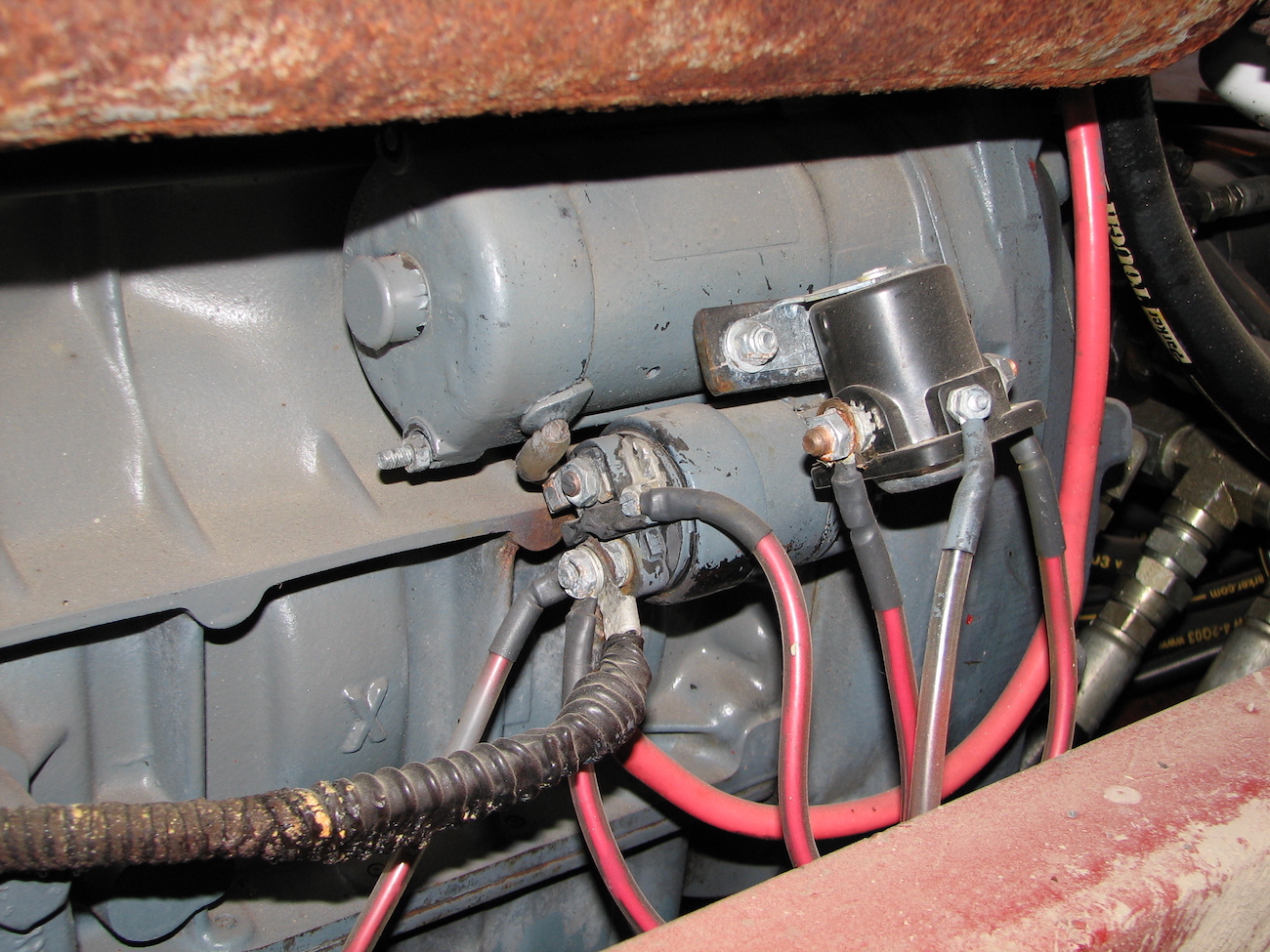

The starter problem is a known issue with certain 18xx units. Something about a slight voltage drop in the original wiring design. PT makes a "kit" to fix the problem. The kit is basically a standard auto parts store solenoid, couple pieces of wire and instructions. Very easy to fix.
If you don't want to call PT, I can take a picture of the installed kit but it may be a day or two before I go over to my property.

Is it different than the solenoid shown here installed near the starter?
Ken

Those do wear out. $10 fix at your local auto parts store. They get a little warm in the PT mounting. More importantly, the little wire on the solenoid tends to break inside the ring connector insulator due to the vibration (DAMHIKT). I had to fix it twice (grrr). The second time, I zip tied it to something solid and it has been good for the last five hundred hours.
All the best, Peter
