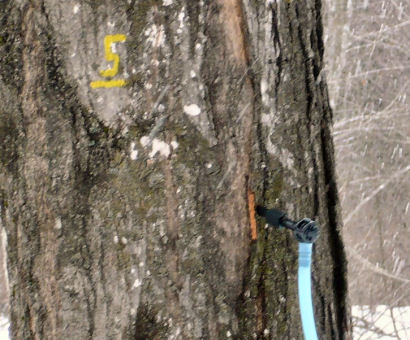

Yesterday we tapped another section of sugarbush and were testing a low of 3% and a high of 6 with an overall average of almost 4%. Good tree's!
Here's a few recent pics.

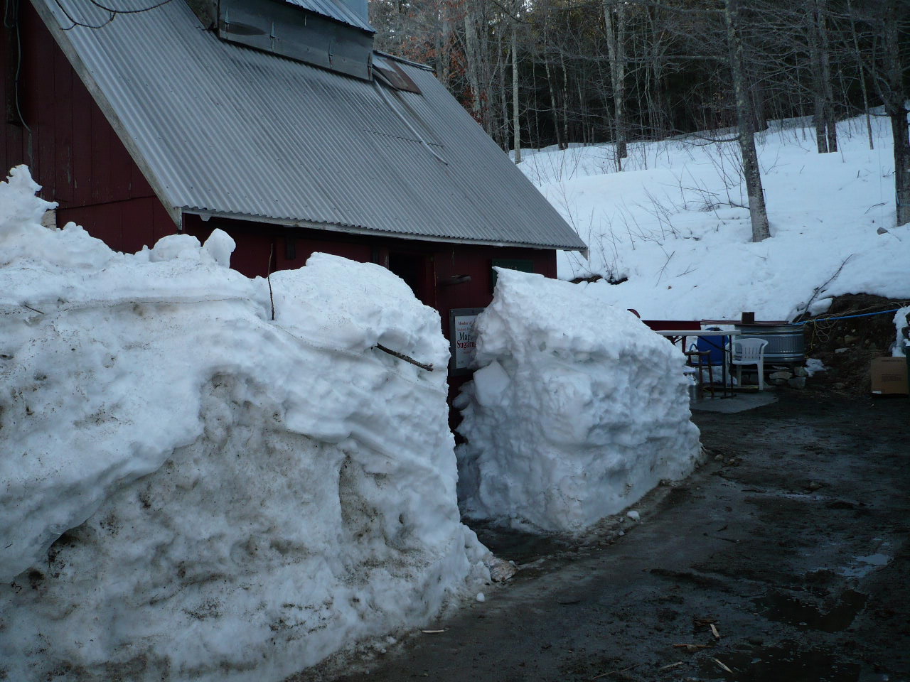

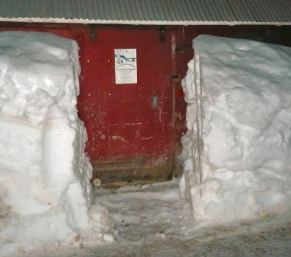

The sugar house door buried in snow.
Maple syrup samples from the last few years.

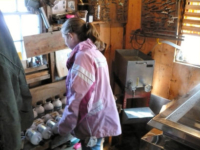

Packaging syrup.
A 5% tree from last week.

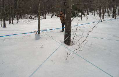

Pipeline pic.

Your sugar house is sure well insulated with all that snow, I pulled my few taps out yesterday, got over 40 gallons from 1 tree in 2 weeks! boiled down enough sap to get another 2 quarts of syrup the other day, this batch is a little watery, can I just boil it more to thicken it, it's plenty sweet enough now though. Even if it's not legitimate syrup how long will it last for before it might start to spoil?

We have about 100 acres of our own, some of which we tap. Additionally we rent another couple small sugar bushes. All told we run about 500-800 taps depending upon how ambition we are feeling. We have always strived for quality over quanity. At 3%+ we can tap 1/2 as many tree's and get the same amount of syrup in the end as others that tap everything in sight.
The tubing is the way to go. When you do use the UV (stiff) poly tubing, it holds up great and flows and cleans good. We've been using tubing since the late 70's and although we still do some buckets it allows us to get to the good tree's a lot easier.
Keep track of your tree's as they grow. Thin them out using sweetness as a guide. A refractometer is invaluable when thining a sugarbush. If you can remove the less sweet tree's and let the good ones have the sun and water your production will be much better.
Vacuum is nice, we run a small set-up sometimes to improve floww. It does help but the cost to run it has to weighed against the increased flow.
