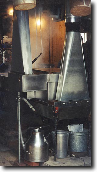

We're still 3 weeks from making any sugar, at best. With 4' of snow on the ground tapping is gonna be a real PITA this year. All the lines are buried and the mainlines are below the snowlevel, say nothing of trying to set tanks or gather buckets.:mad:
Here's a couple pics of our operation.
And some vids. YouTube - Boiling Syrup at Greene Maple Farm
YouTube - Greene Maple Farm

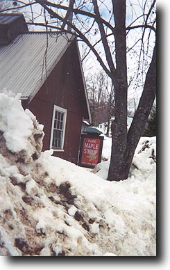

YouTube - Snow at Greene Maple Farm Sugarhouse
Here's a vid of our sugarhouse in the snow and a pic. It looks like a few more weeks for us to start.
How is the quality for you this year? Have you checked the sugar content of the sap? Just curious as we have yet to get a chance to do any testing.
