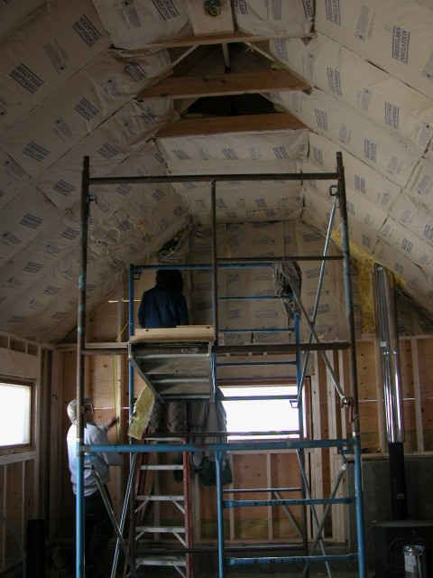

Shop Rebuild Day 8
Minus 22 degrees this morning, warming to a balmy minus 9 by lunchtime. Even standing so close by the burn pile my gloves started smoking I couldn't get those fingers to work! So I decided to work inside the shell. Got most of the ceiling insulated, the wiring for the overhead lights and ceiling fan in place, and most importantly -- got the woodstove set up and generating some heat! /forums/images/graemlins/grin.gif
Tomorrow: more dump runs and a start on wiring the shop. Looks like next Monday we'll have a heat wave (low to mid twenties), so till then I'll find things to do inside! /forums/images/graemlins/shocked.gif

Hi Pete,
Are you using a ridge beam to keep the eave walls from spreading, or how are you stabilizing the roof?
Did you provide proper vents at the eaves with a ridge vent at the peak?
Is there also a 2" air space between the top of the insulation and the bottom of the sheathing for air flow?
Just wondering before everything was buttoned up.
Good luck with your project.
Yooper Dave

Re: Shop Rebuild Day 8
Yes, yes, and yes. I used a continuous soffit vent, and will be installing a ridge vent as well...once the daytime temp hits at least zero!
Pete
