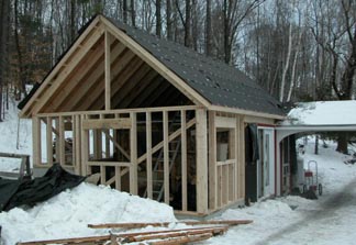

Re: Shop rebuild end of week 1
Got the building sheathed and the vapor barrier up. Ice shield is partly up. Windows went in today. Soffits are in. Will cut the passthru for the Metalbestos stovepipe this afternoon. Metal roofing is onsite as is the trim. Should have the shiplap for the exterior soon and will install that soon as the weather permits. The forecast high for tomorrow is 3 degrees, so I might work on the inside. /forums/images/graemlins/shocked.gif
Have I mentioned how tiring this is? I go to bed exhausted at 9, but wake up at 2am itching to get going again! /forums/images/graemlins/crazy.gif
Pete

/ Started rebuilding my shop! #30
Pete, your project looks great but slow down. You're making some of us look bad by getting so much done so soon. /forums/images/graemlins/blush.gif
Slow down heck! It's cold out there! Gotta generate some body heat! /forums/images/graemlins/grin.gif Once I get the outside done and some insulation inside, I can light the woodstove and slow down a bit. If I play my cards right, I might be able to play out there (um, I mean work) the rest of the winter without the wife assigning me busy work!
