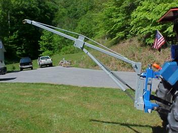

Now what kid of attachments can I make that will fit in the receiver hitch?? /forums/images/graemlins/confused.gif
   / Started my welding class am looking for a project #53
If you don't have a lifting boom, I have and idea you might be interested in.
Take a 2 inch box tube about 10 inches long, this will slide in the receiver. Install some kind of knuckle joint on the 2 inch box, and add about 6,8, or 10 feet of 2 inch box tube, At about the 4 ft mark, top, of box, weld a chain holder. The other end of the chain hooks back to the Quick-Attach plate with a chain slot. Install a hook or what ever at the end of the boom. This unit can be broken down very quickly when not needed . Maybe something like this picture.

I had thought about a lift boom, but had not thought of that versatility? Wow, great idea! /forums/images/graemlins/grin.gif

<font color="blue"> (lift boom versatility?) </font>
<font color="red"> Just remember that versatility (lifting capacity) is inversely proportional to the overall boom length! /forums/images/graemlins/blush.gif
If the PT-425 can lift ~800# with the adaptor plate 3' from the wheels, then with a 3' boom added, it will only lift ~400#, and with a 6' boom added, only ~250#!! /forums/images/graemlins/frown.gif
The Power Trac 48" Lifting Boom should be good for ~325#. </font>
<font color="red"> PS: With a 10' boom added, the average man could lift the rear of the PT-425 clear off the ground by just pulling down on the end of the boom!! /forums/images/graemlins/shocked.gif
