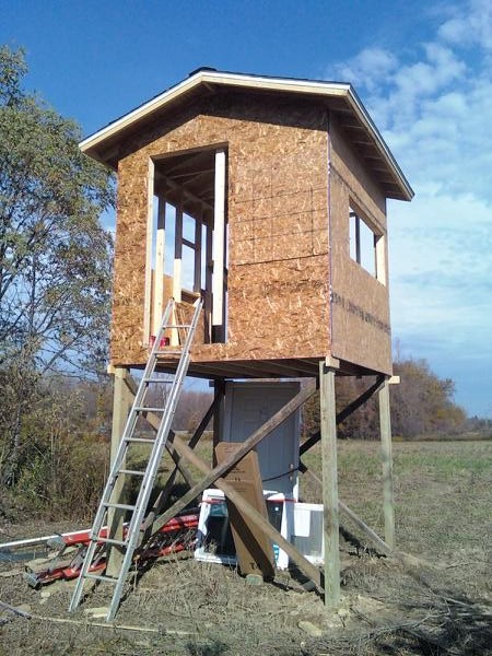

Sorry if i missed it how deep did you put the posts in and did you cement them or stone/dirt them in.?
thanks
great project btw
/ Started my tower stand today
#134
thanks
great project btw
The posts are 3' deep and are cemented in with 80 pounds of concrete per hole.
