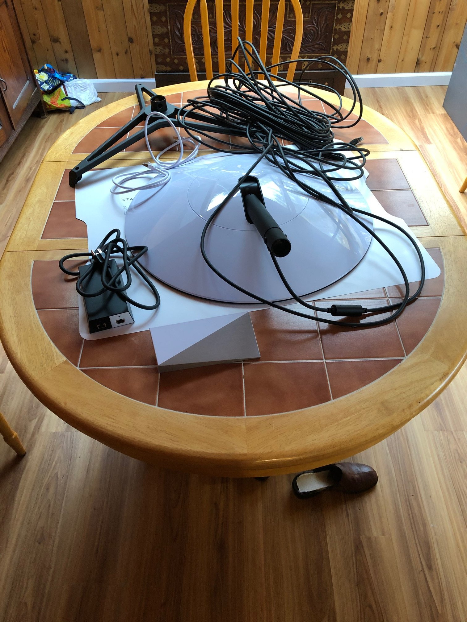

My Starlink is supposed to be delivered on Tuesday and I can't wait, neither can my 18 year old computer geek of a son. We've been using Viasat, works fine for most internet browsing, but streaming and games are awful for the most part. Couldn't due cellular as we have to run a booster to get 1-2 bars in the house. I still wouldn't trade a thing to be able to live out here. The peace and quiet and wildlife and woods trump anything else.
Tim
How long were you on the wait list and where are you located?
The information might provide some hope for others in your area.
