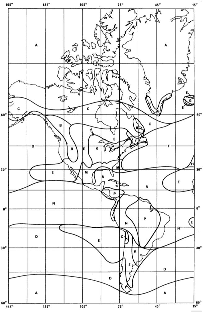

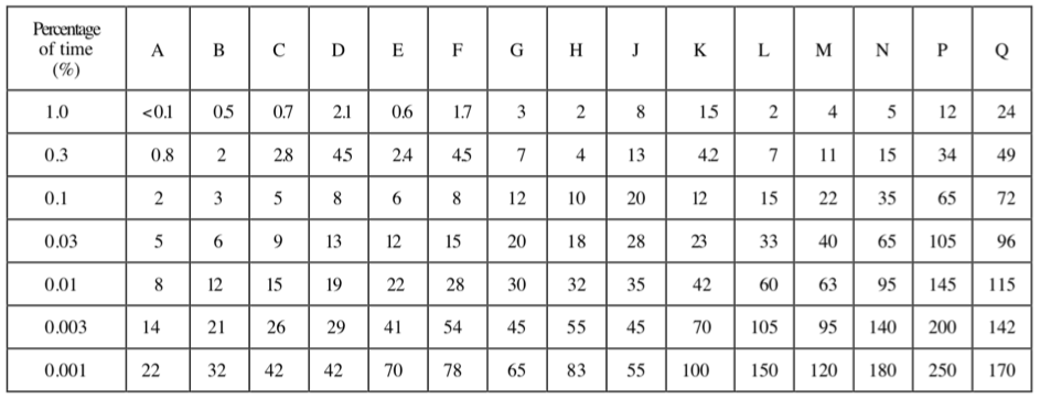

Around here, rainfall intensity is pretty light in the grand scheme of things, and even during what passes for heavy downpours here, I can't see anything out of the ordinary. IIRC: there was some filing that suggested that there might be impairment above 1-2" of rain/hr.
Here is an in-depth analysis of the impact of rainfall rate on Ka and Ku bands in a tropical location with heavy (1"-12" rain/hour) rainfall. (Starlink uses both.)
(region P, below)

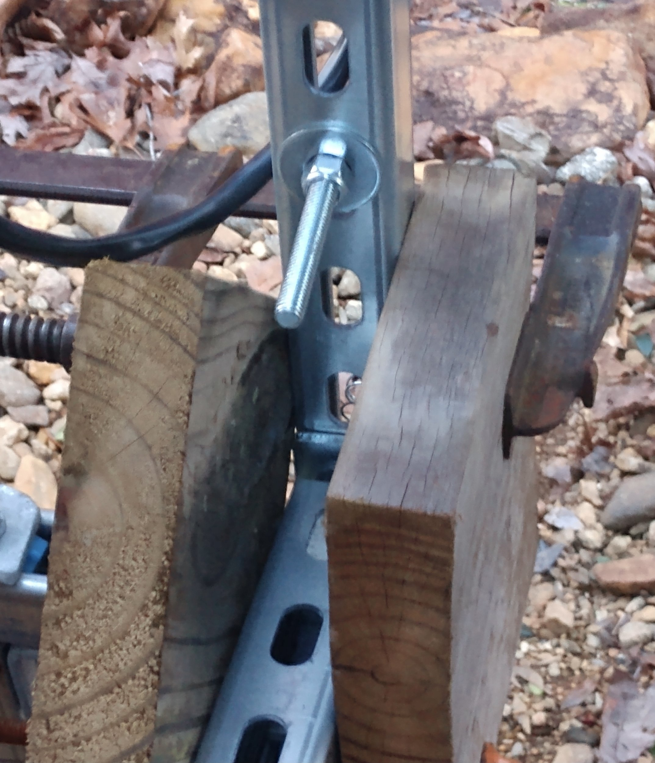

so, progresss report so far:

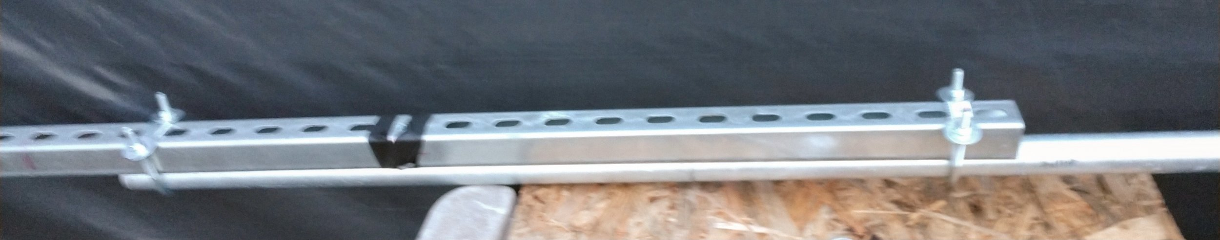

blocks of wood clamped to prevent base of mast from slipping sideways during lift (also visible is a pre-mounted bolt/stud for rapid fastening):

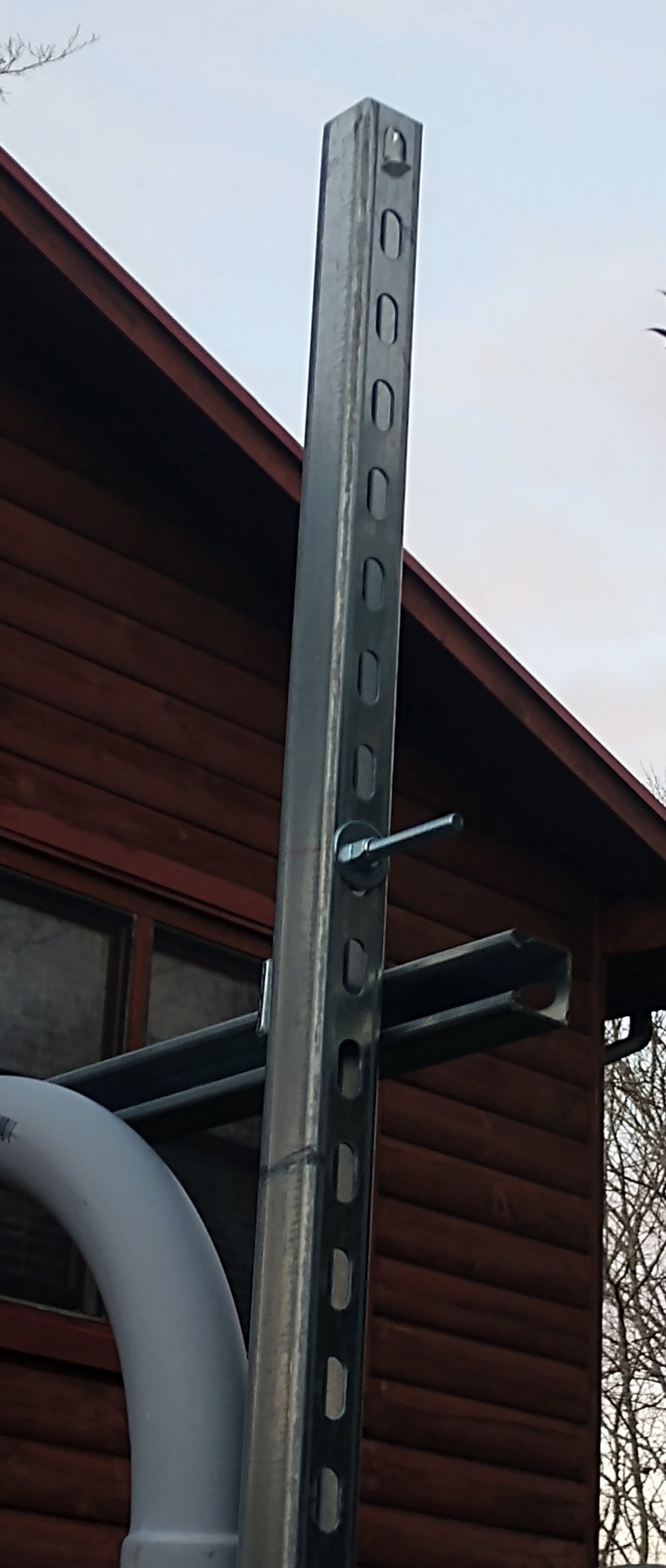

and the top stud:
bottom Unistrut and middle EMT sections u-bolted together (black tape is holding a spring-loaded StruNut in place for an additional bolt at the top of the existing strut on the solar array) :

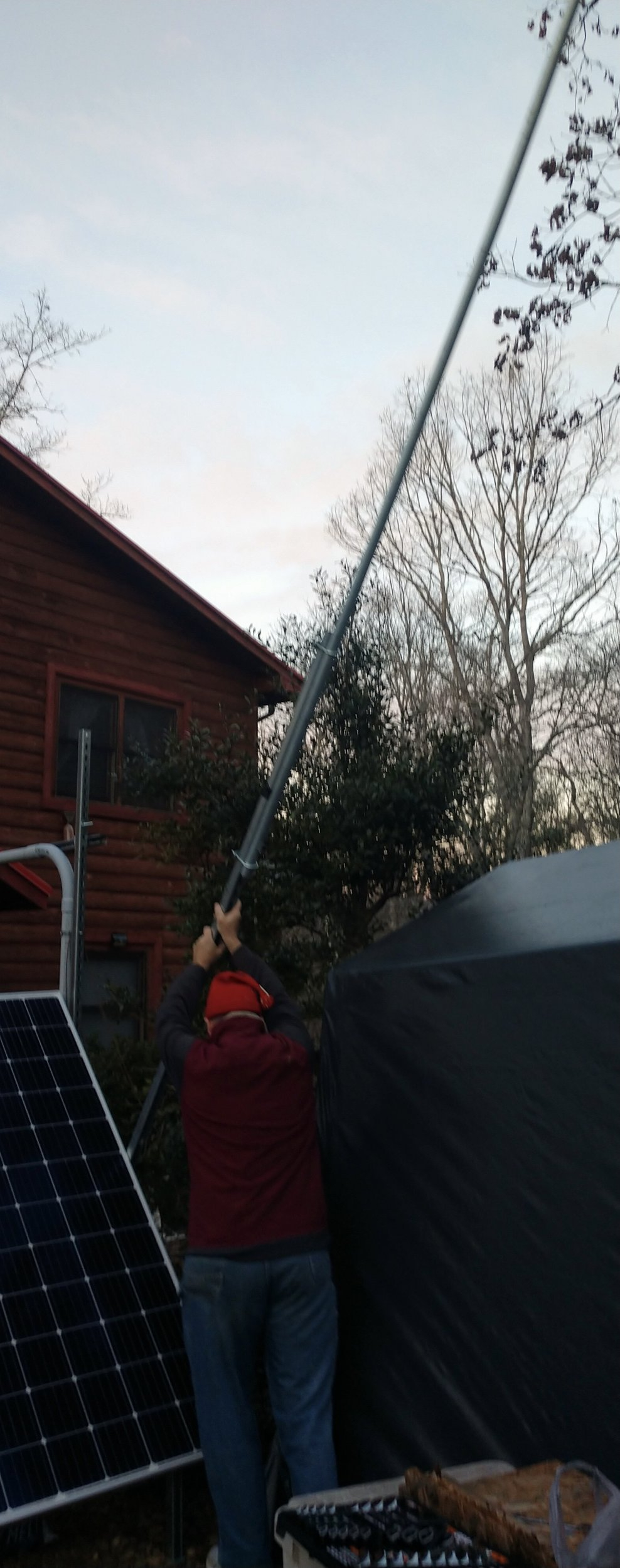

Trial lift of the two pieces assembled (it wasnt too bad - I am sure it will be tougher fully assembled!):

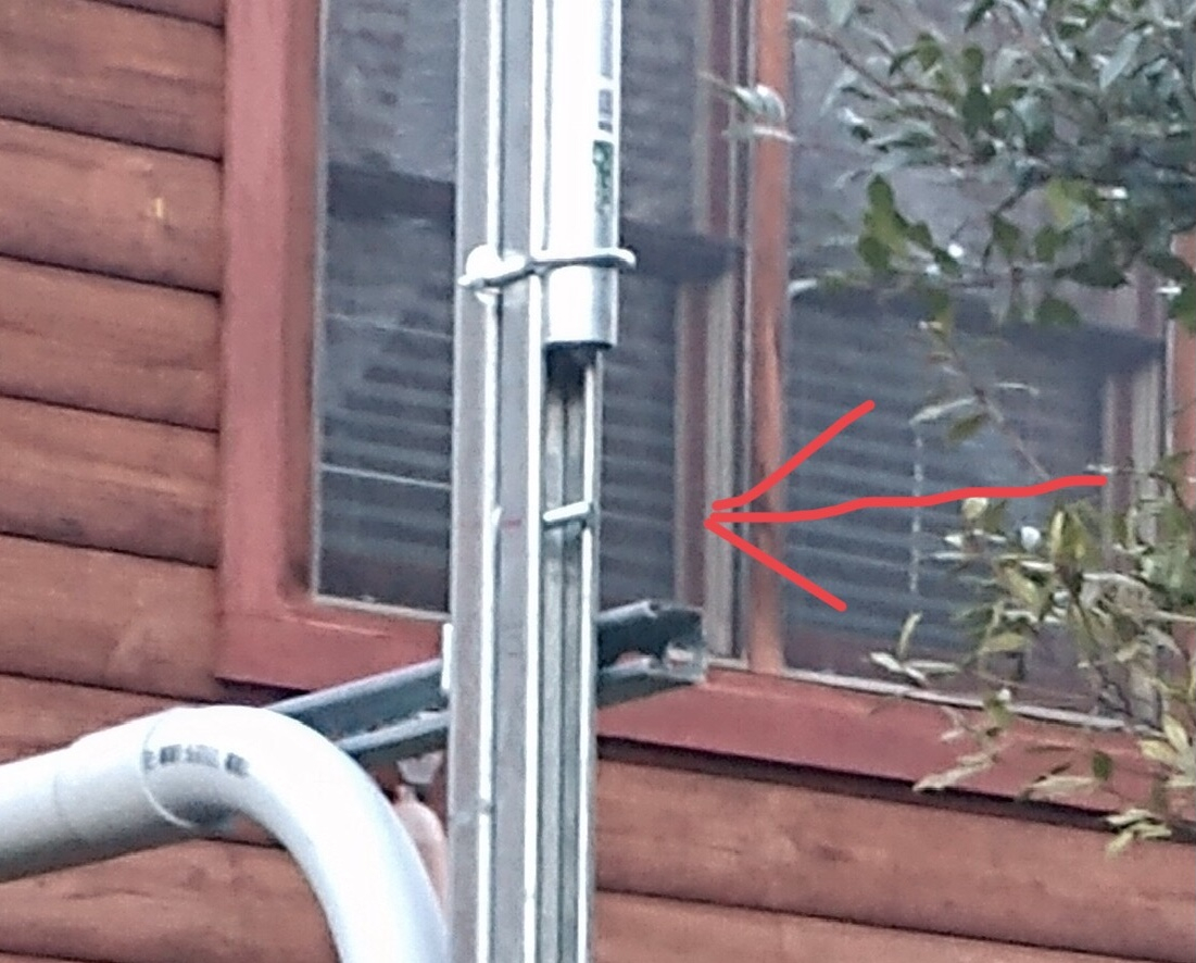

Upper bolt/stud with mast raised:

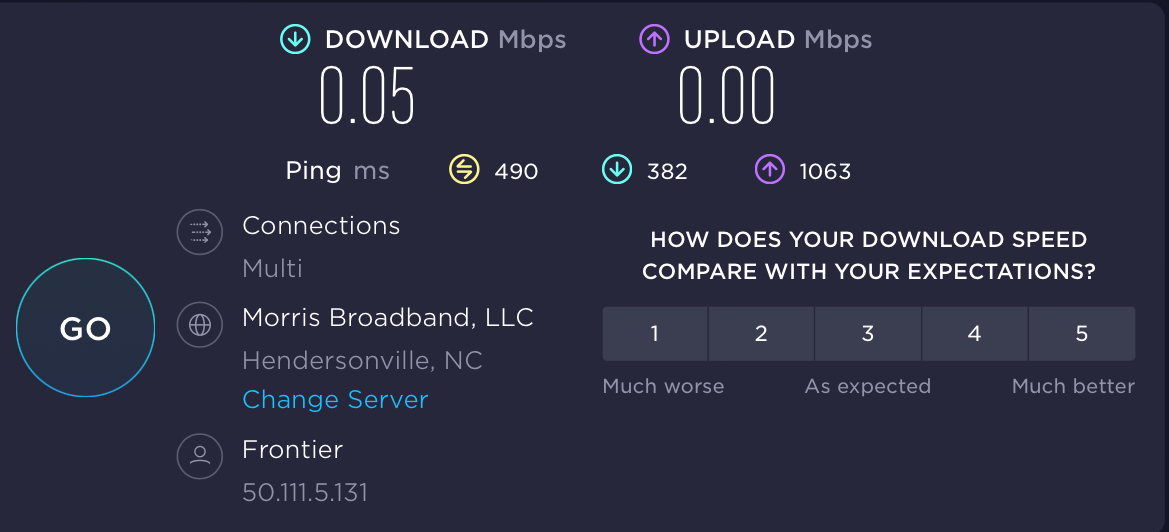

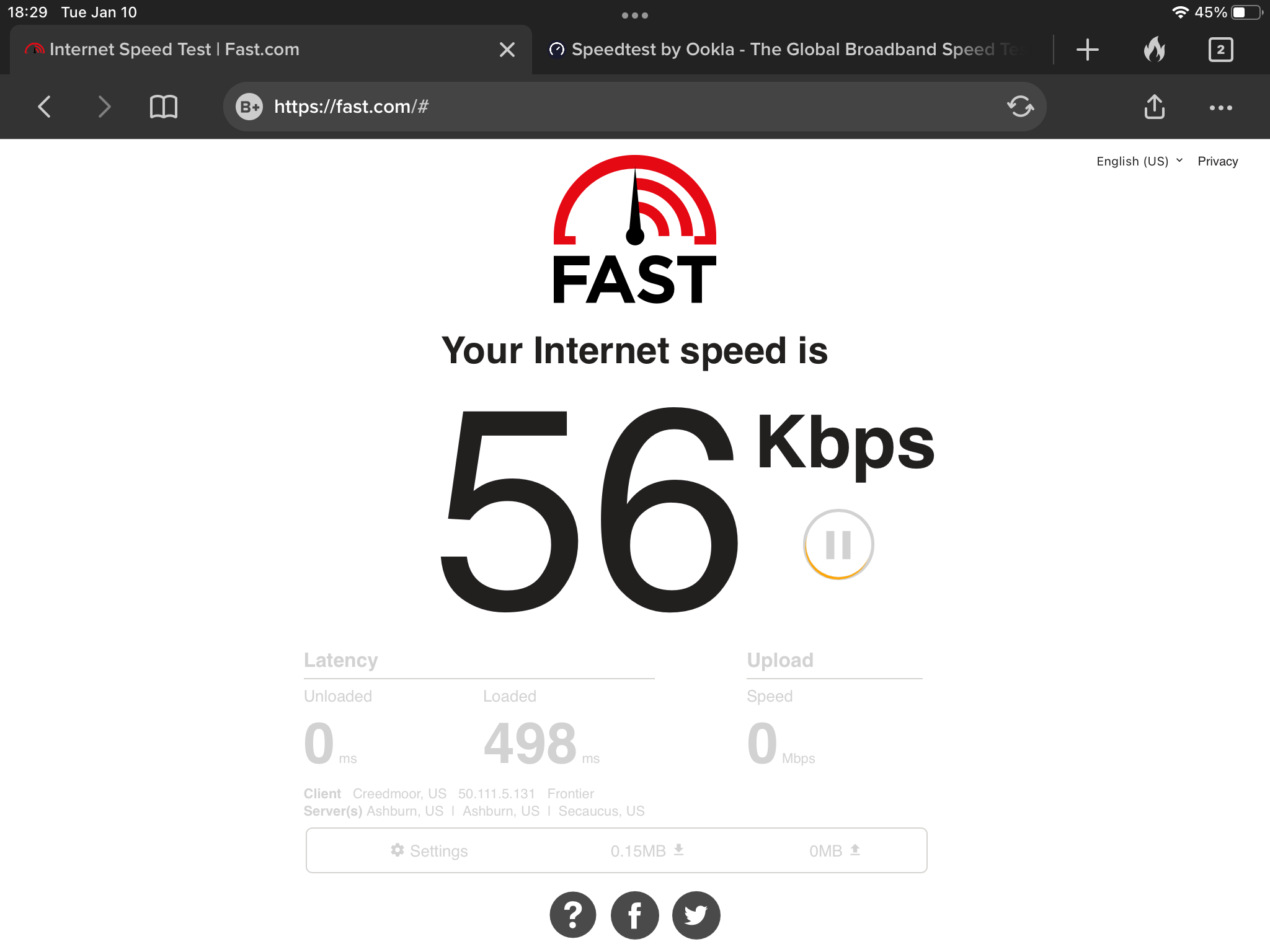

Earlier, we had some Spectacular performance from our DSL:

Curious why you just didn’t mount at roof peak. Might have been easier.
   / Starlink #3,357
I
KilroyJC
I don’t have a ladder long enough, and I haven’t purchased my scaffolding yet.
this is temporary until spring. And I can do it without getting on a ladder. Okay, I need to get on a 6’ ladder to spin on a couple nuts. . . But I don’t need to be 20+ feet up on a ladder . . .
   / Starlink #3,358
Even if you had a tall enough ladder, do you really want to go up there every time the Dishy needs some love? I have a Protect camera sitting on the top of a pretty spindly pole, and every time it needs to be reset (which unfortunately is every so often), I can unscrew one bolt and pivot the pole down until it lays across the bed of the side-by-side. The Dishy, though, is at the top of an 8' pole that is anchored in 2' of concrete. I need a ladder for that one, and I wish I'd done it the same way as that camera pole.
