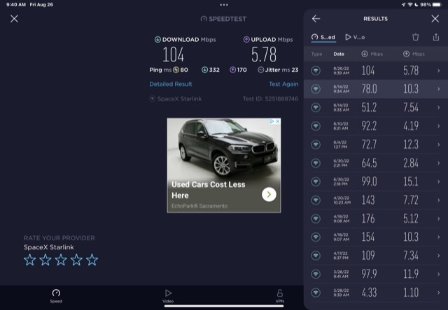

That's difficult to answer. Because any speed test is only a test of the connection speed on the specific path between your system and the one particular endpoint of the speed test site. And there is nothing to base "is it accurate" on except a comparison to your own testing against that same exact test site and endpoint server over time.
My suggestion is to pick one speed test site that you like and stick with it. Always choose the same endpoint (usually listed as a city name). Then keep track of your speeds over time. The actually number doesn't really mean a lot, but the variance from your average test result is what is insightful.
Just be aware that there are TONS of variables that impact connection speeds. You're on a shared network on your ISP (Starlink) and your ISP routes you to the Internet which is also a shared system. Time of day, day of week, events happening in your area or across the country at the time can all be impactors.
Thanks. I use a nearby university IT department (75 miles) server as a test site for StarLink thinking it may be independent vs. some ISP provider. Dunno.
