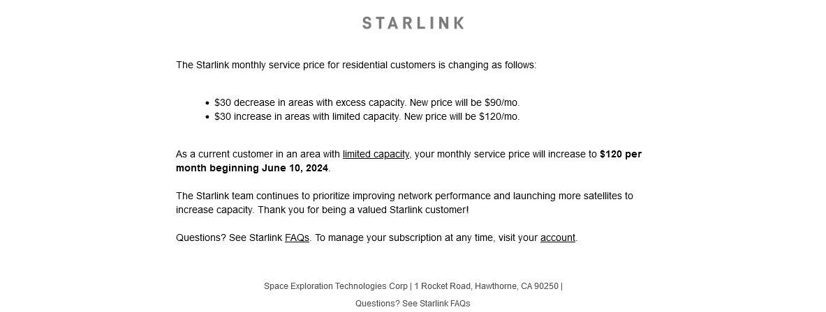

I got the price increase e-mail. I find it highly unlikely the capacity in my area changed. I'm pretty rural with residences spread out quite a bit. I've never seen another SL on anyone's roof out here. Curious if anyone gets that e-mail and their price goes down?
As for the solar storm, to my knowledge our SL wasn't disrupted at all.
/ Starlink #4,113
Price has been $120 mo for about 1 yr now.

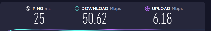

My speed test just now is excellent
DOWNLOAD Mbps
250.63
UPLOAD Mbps
21.19
Ping ms 23 24 24
/ Starlink #4,117
fyi just now, 92 down, 11 up, latency 26ms.
I used to think 250mb down was some sort of hardware limit, but I have seen speeds higher than that. Usually like 4am.
/ Starlink #4,118
I just set mine up. on the regular speed test 237 MBPS download, 8.5 upload and 28ms latency. On the advanced speed test, 68MBPS and 12.6 upload
/ Starlink #4,119
Just did mine,
121 Mbps down,
9.4 Mbps up,
and 37ms latency
