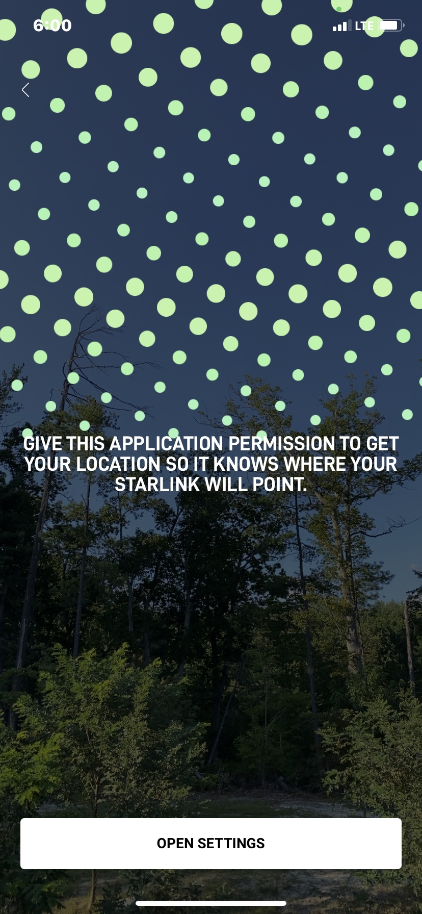

As you move away from the trees, you are going down hill. The only other place I couldnput the dish would be on a pole about 20yds south of the house. This is the app from the ground. I am sure it would be slightly clearer on a pole but I am not sure it would be worth the effort.

My neighbor is in an awful location. A house sitting in a very small hole in a dense forest. I didn't think SL had any chance to work there. His system reports substantial obstructions and the phone app gave dismal results.
His performance blows away his old DSL. He has done wifi calling with no problems, and speed tests run from 4mbs to 80mbp or so. Very, very, very surprising to me.
So, you might put the antenna up and see what your results are. One wild card he has not yet dealt with is a signal when there is a snow load in the trees. I will try to get a screen grab of his obstructions page.
I noticed my antenna sort of tilts to the NE. So when I let him try my SL I put it at the edge of his hole in the forest to best take advantage of looking up toward that direction.

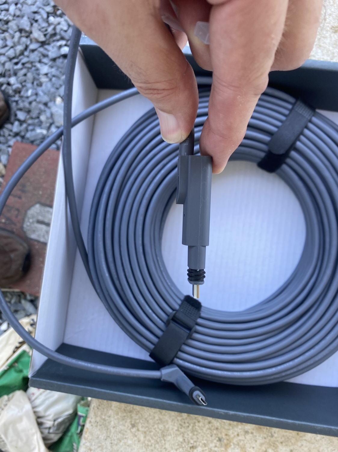

I used a regular cheap bracket from Amazon, and the starlink pipe adapter, the antenna pipe locks right into their adapter.
Here is the 150 ft cable. It’s the only cable from router to antenna.
The end I’m holding goes into antenna inside it’s pipe.
That is the same bracket we have, from the starlink shop we just bought the adapter and the install kit. It was super easy to install, we have it 30' up in the air on the side of our house.

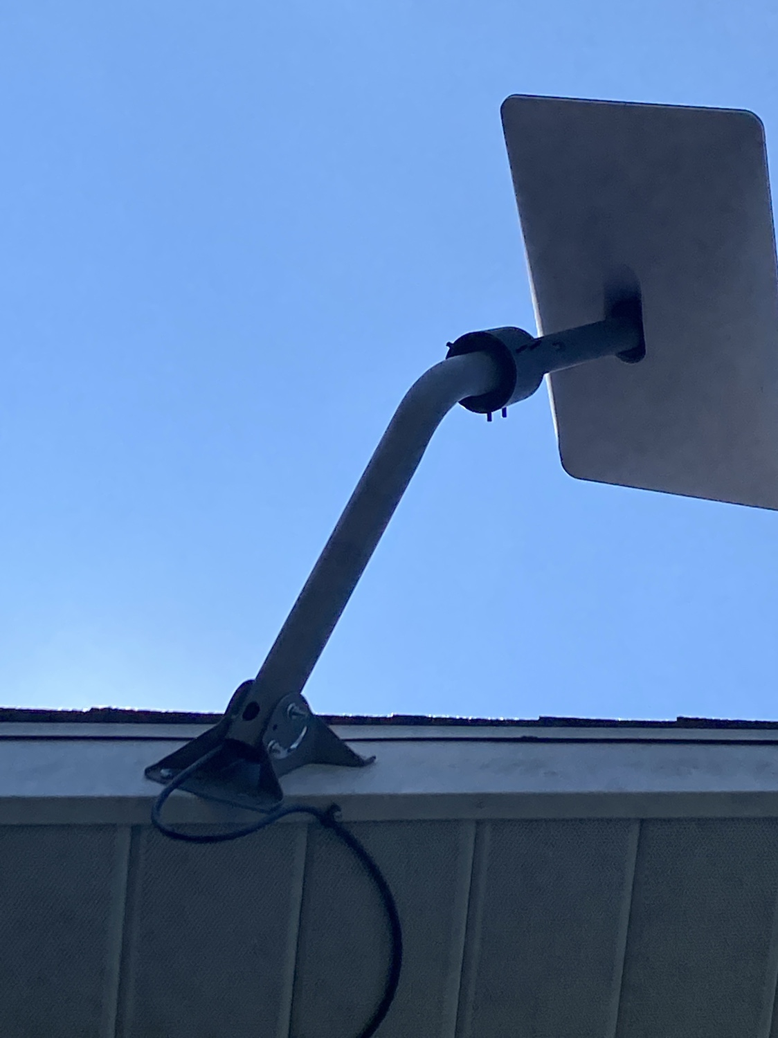

Originally had my dish sitting on a picnic table in our side yard. There were a few obstructions, so the connection was less than optimal. However, I got it on an early February day, and was not interested in climbing up for a roof mount in the middle of winter.
Later, I did this mount. The main bracket was ordered from Amazon. Addd a piece of galvanied pipe from the local hardware store and clamped the Starlink antenna mount to that. I was a bit concerned about high winds and the fact that one part of my eaves was not in great shape, so I added some outriggers from an old Satellite TV antenna mount and attached them to a seam on my standing seam roof using S-5! clamps. (A bit of an optical illusion there: the outrigger looks as though it's attached to the very edge of the roof, but it's actually clamped to a seam about 16-18" back from the edge.
