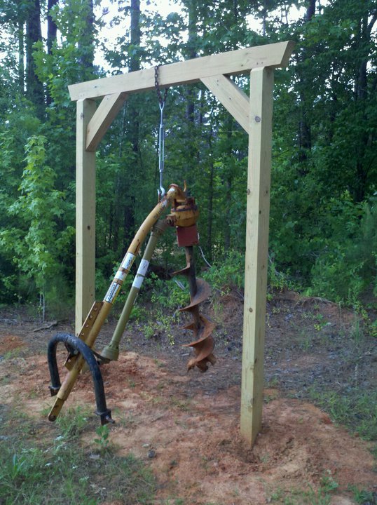

I've been tripping over my Posthole Digger for too many years now, and the last time I put it on, I decided that it was going to have a stand before I dealt with that again. I've seen posts from others who built simple stands to hang their posthole diggers, and thought that was the best solution. Simple, cheap and easy to build. I even got lucky and found all the lumber that I used in my scrap pile!!! :thumbsup:

Here's a pic of mine... well sort of. You can only see one of the 4x4 upright posts but it's pretty much the same as Eddie's, just not as pretty. :laughing: This SURE makes it easy to hook up to a tractor cause the PHD will swing or tilt anyway you need it too to line it up. Btw, looks like we have the same Leinback PHD.

Thanks for this picture, but with the auger up so high, do you have trouble putting the PTO on? I like to have mine level. What's the deal?
I have decided I need some kind of stand because getting the PHD on is not so hard but getting it OFF is my problem. I just drill it into the ground, which presents problems.

I had it on my tractor when I put it on the stand, so it's at the ideal position to hook it up again. I used a turnbuckle just in case I need to raise or lower it a bit, but don't really think that I need it.

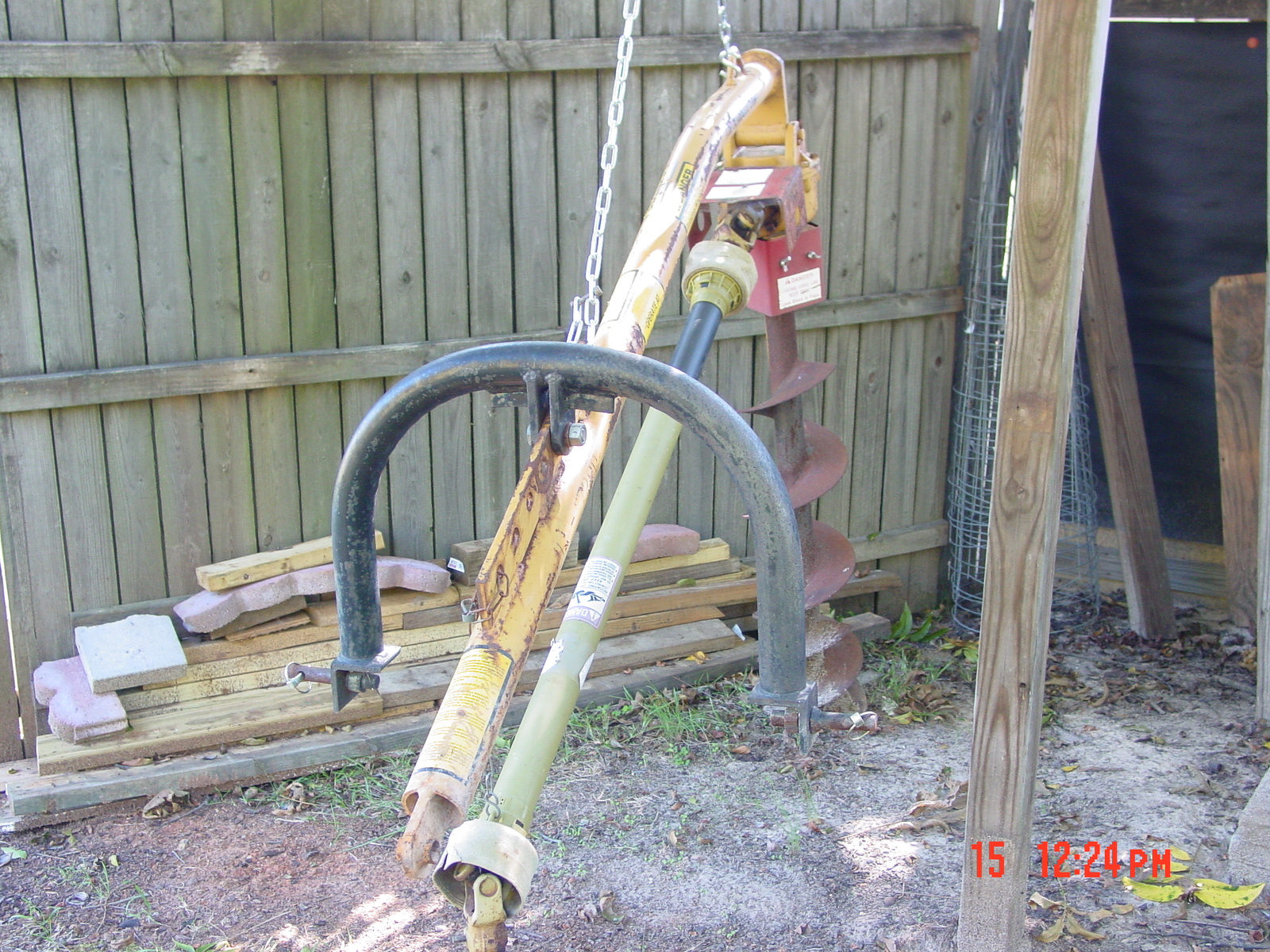

Here's my phd stand. Everything is resting safely on the ground. I don't like having heavy things suspended in the air. It consists of two old fence posts, a piece of scrap lumber and a piece of rope.

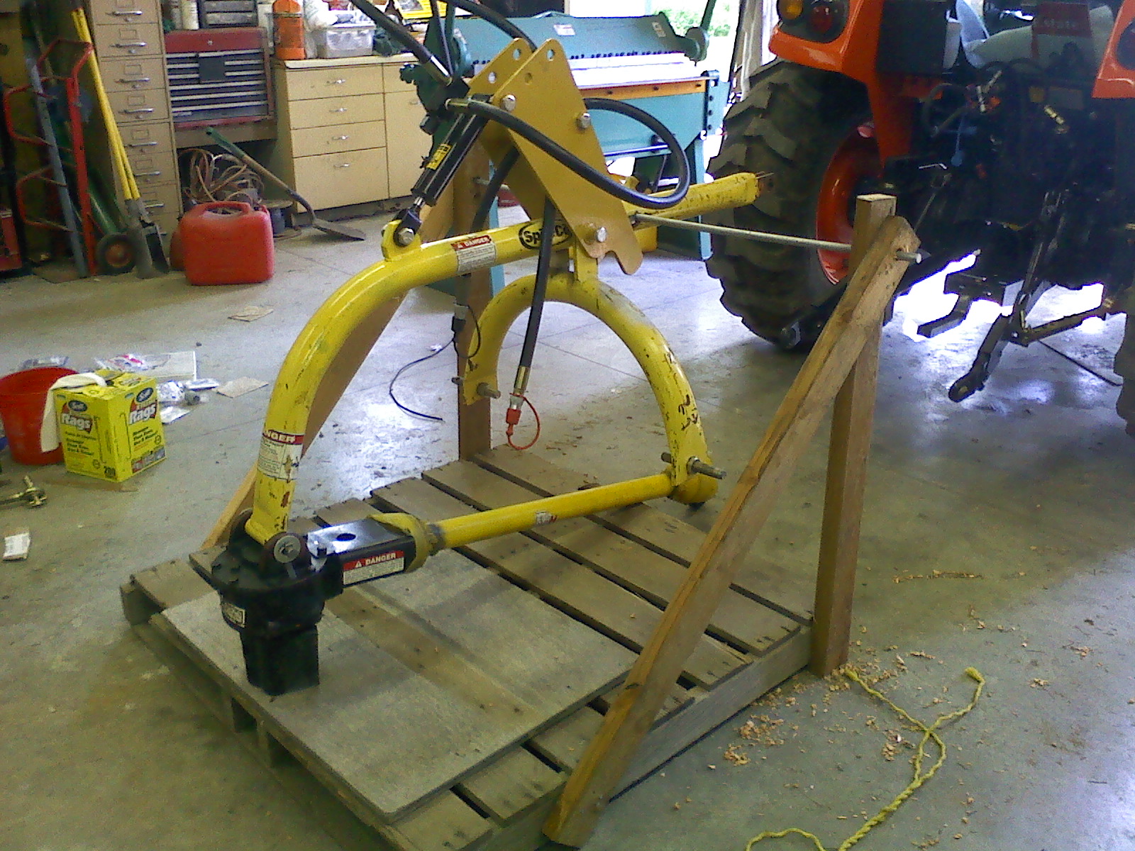

I wanted one that i can move into and out of the shop easily, so i gathered up some scrap wood and a scrap pallet...and here goes. Cheap and easy...just like me. Hooks up in minutes, and i dont have to lift anything cept the auger.

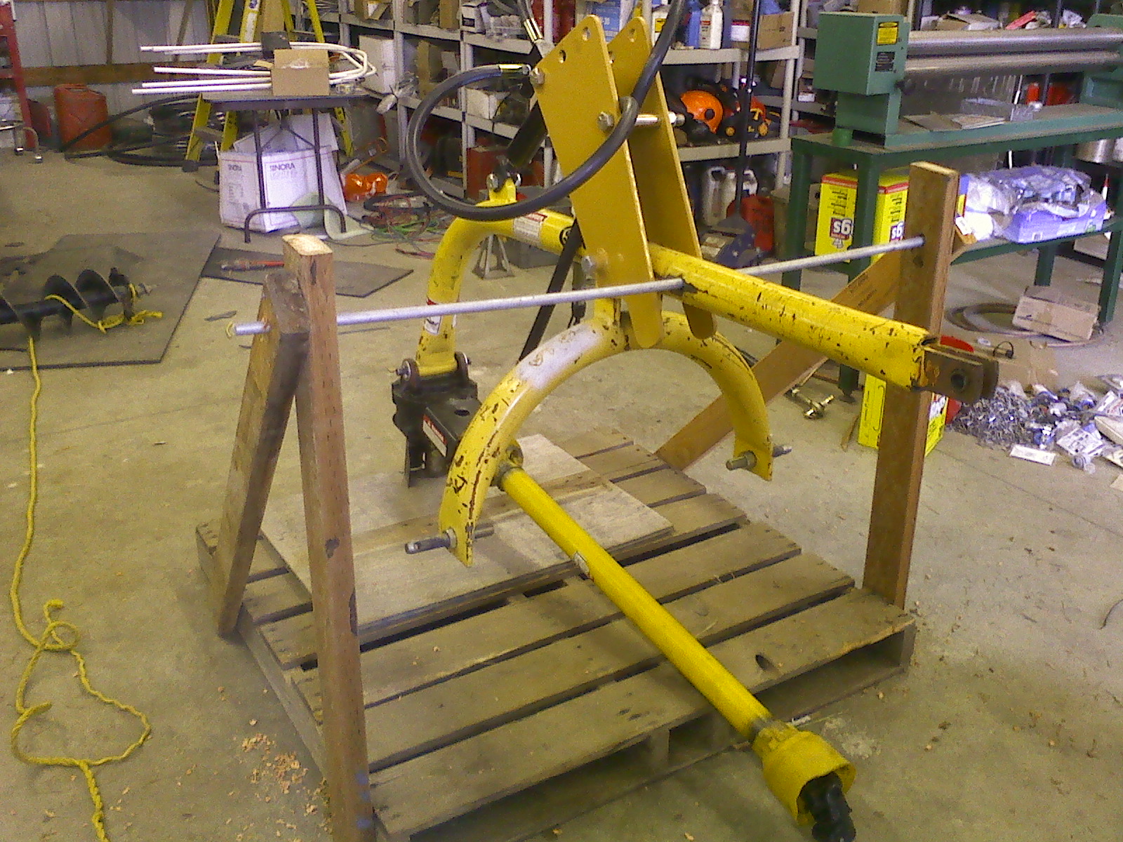

Same here, just scrap laying around the shop. I palletized mine so that I can move the PHD when necessary, without the need to actually mount it on the tractor. The cradle design however, requires that the auger be pulled up parallel with the boom (note chain) before using the hydraulics to lower it into the "parked" position. The second chain is to hold the PTO shaft up outa the dirt after it's disconnected from the tractor.

That method means you still have to 1) back your tractor to a precise spot (always a pain IMO), & 2) lift a fairly heavy portion of the PHD & hold it accurately while making the connections (also a pain & a good way to get extra greasy!).
I know you don't want to suspend it in the air, but with the chain & rafter mine is hanging from now, the bottom of the auger is only an inch or 2 above the floor. Nobody could fit underneath it, & it would do very little damage even if it did ever fall. I guess it could fall & then lean over onto somebody, but it isn't likely to do any serious harm.

no wheels on pallet...i use pallet forks

What does the Hyd cyclinder do on your PHD? I find it to be a VERY interesting mod...
Also, was the hole you run the bar through already there??

Downforce. Not sure about his particular model, but on mine it's a factory option/upgrade - rather than an aftermarket modification. I just opted not to purchase it (yet), as my augering to date has not suggested it would have been worth the money.

The hole the bar is run thru was already there. Its for adjusting the arms and post hole digger.
The hydraulic assist adds about 250-500 pounds of down force while digging holes. This way i dont need someone holding on a steel rod hanging off the PHD to dig the holes.
Its a single acting cyllinder that applies downpressure but immediately deflated when i raise the PHD.
And it works GREAT

This one is actually from the factory that made my PHP (Speeco). The only thing was that i waited for 6 years to buy it, and their design had changed. I had to do some mods to make it work. On the new models it simply bolts right on.
But my mods simply reflected the changes that they made.
