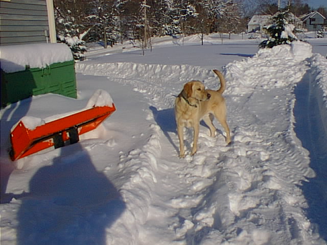

Used steel that was just sitting around, doing nothing. I had a few chunks. was around 3/16" thick,, 18" X 48". So the extension added 18 inches out front and 18" high on the sides. Reinforced with 1 X 1" angle iron. Weighs less then 75 pounds (in guessing) so I can manuver it alone. I have two 4" wide skids on the botton to keep it off the gravel.
I'm not real good at welding, I can make it stick real good, but don't look too close at the bead. (Whadda ya want for nuttin????)
I don't think I would have made it any longer, since my dump height is now limited.
Helps alot since I have one area in the driveway that drifts badly. Can get 3 or 4 feet deep. Taking bigger bites make it much easier.
Works well for mulch too.

There's a reason for celebration here: I just got my Kubota skin applied (it wasn't immediately available with the new software)!!! It looks cool with its orange backrounds. The other thing that you provided is the ability to make the bucket bigger. One of the things i don't like about the stock Kubota design is the lack of rollback to flip things in the bucket. Your design doesn't necessarily have to extend the bucket parallel to the existing bottom but could be angled up to provide more rollback. An extension on the top edge would prevent material from falling back on the operator when fully elevated and rolled back. The bolt on side edges you used will allow this bottom angle to be changed. Good job, you just saved me from taking a more complicated path! SteveV /forums/images/graemlins/laugh.gif

Skent, Yours is alot bigger than mine and I'm jealous. /forums/images/graemlins/frown.gif
Nice job with the enlargement.

Great job skent -just about exactly what I have planned for a spring project. Just bought a torch set to cut the plate. Can't quite see in the picture - do your sides fit inside the stock bucket? I was thinking of match the sides against each other and using a strip of plate to extend inside for the bolt attachments. (I already have one hole for the bolt on toothbar and was going to add another on top) Also I was planning on extending by 12 inches as I was concerned about total lifting capacity being exceeded. Can you fill the bucket with snow/mulch and still lift with no problem?

I added 18" and even with wet heavy snow there's no problem lifting. I have my extension overlapping inside the existing bucket sides. To test the bucket, I placed 10 bags of sand, (50 lbs each) and it worked fine. I think it would be impossible to load over that weight with snow, no matter how 'wet'.
