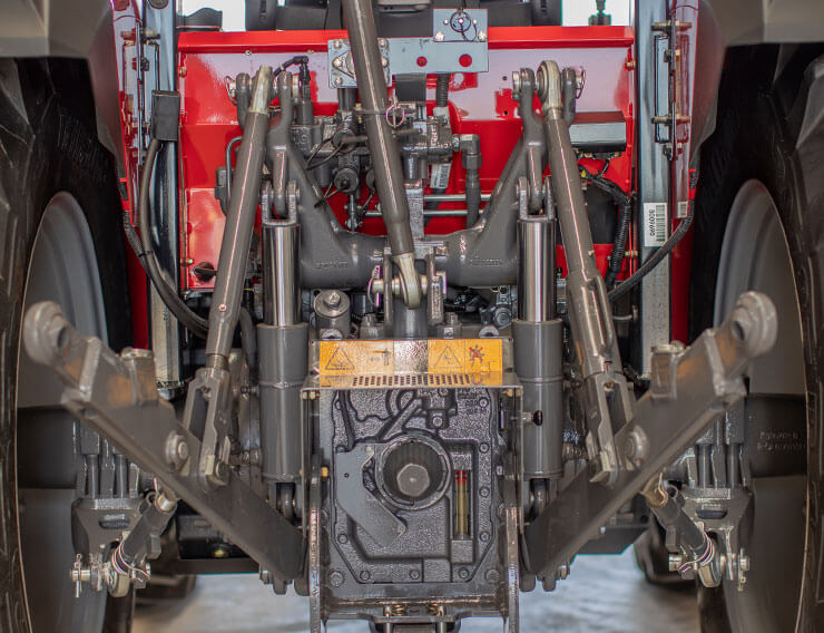

Using tiny attachments on the Massey is a bit of a mismatch. Like Lou said....unpin the stabilizers.
   / Stabilizer spacing won’t fit my old attachments
#12
If you unpin both stabilizers will the lower arms swing in close enough then?
Haven’t tried that yet firgured I’d need to rejoin them anyways and wouldn’t swing back to do it
#13
Just trying not to have to go get all new attachments

Rear view:

You went from a 4000lb tractor with cat I hitch to a 8000lb tractor with cat II.
Break out the welder and make if fit if you insist on using cat I implements
