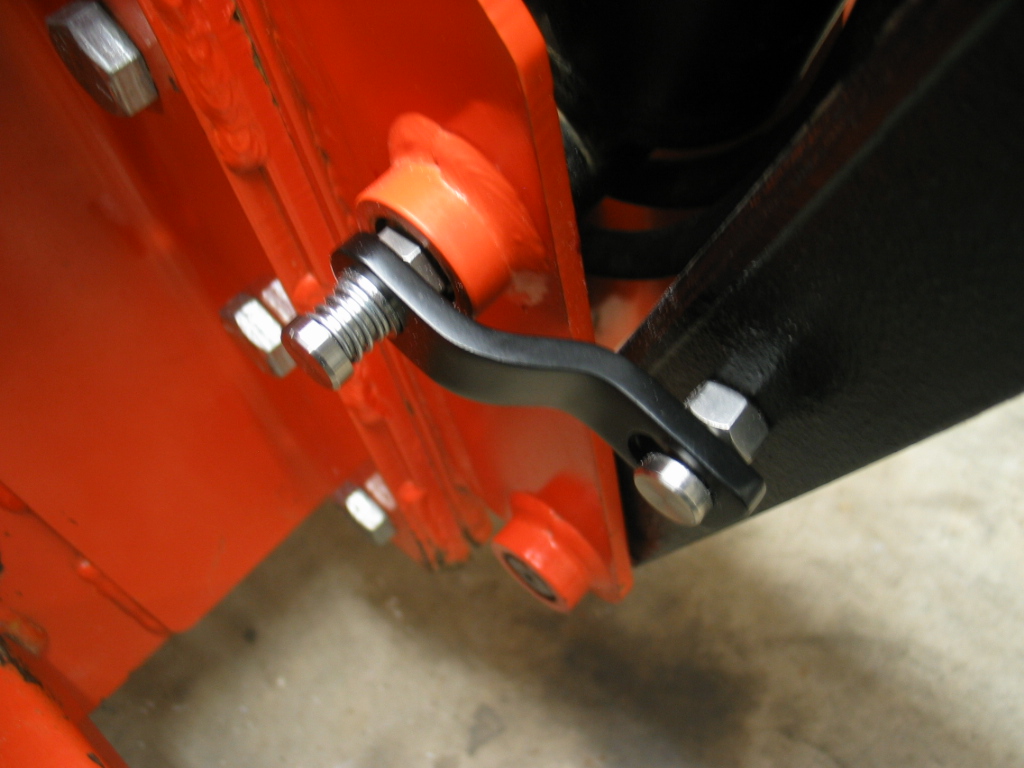

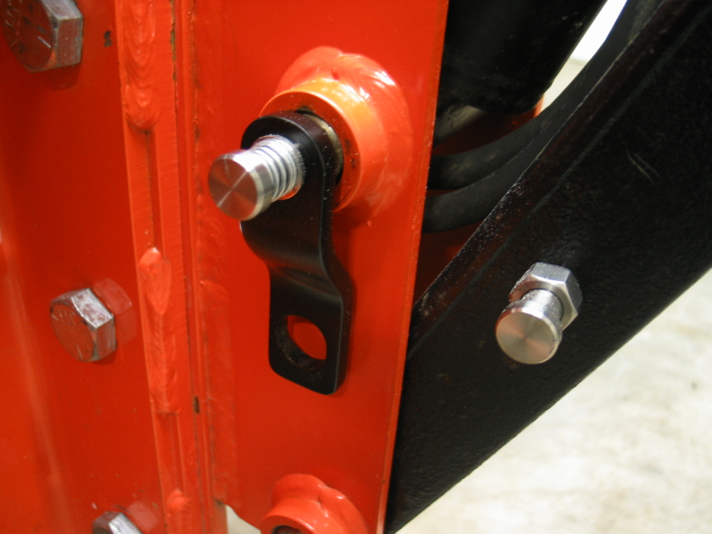

I really like the spring loaded stabilizer locks WaxMan made though..........
