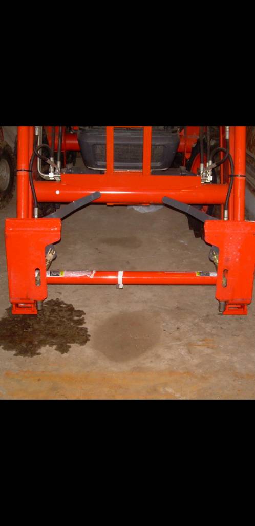

Boy I sure would like to see some pictures or video.
I've got everything loaded in the truck. After work today I'm going to weld up the quick attach. Brace and fishplate the **** outta it. Depending on what time I make it back to the Homestead, I'll try to remember to take a video of the plow setup.

I ran outside a few minutes early this morning to take a quick video of the plow setup.
Sorry for the quality. Its the best I could knock out before I had to leave for work.
Didn't bother taking video of the tractor side since a lot of it is in my truck. What sucks is I have to tack it in at the shop, drive back home, make sure it all fits, then drive back tomorrow, and weld it solid. Two days without riding the motorcycle in. :thumbdown:

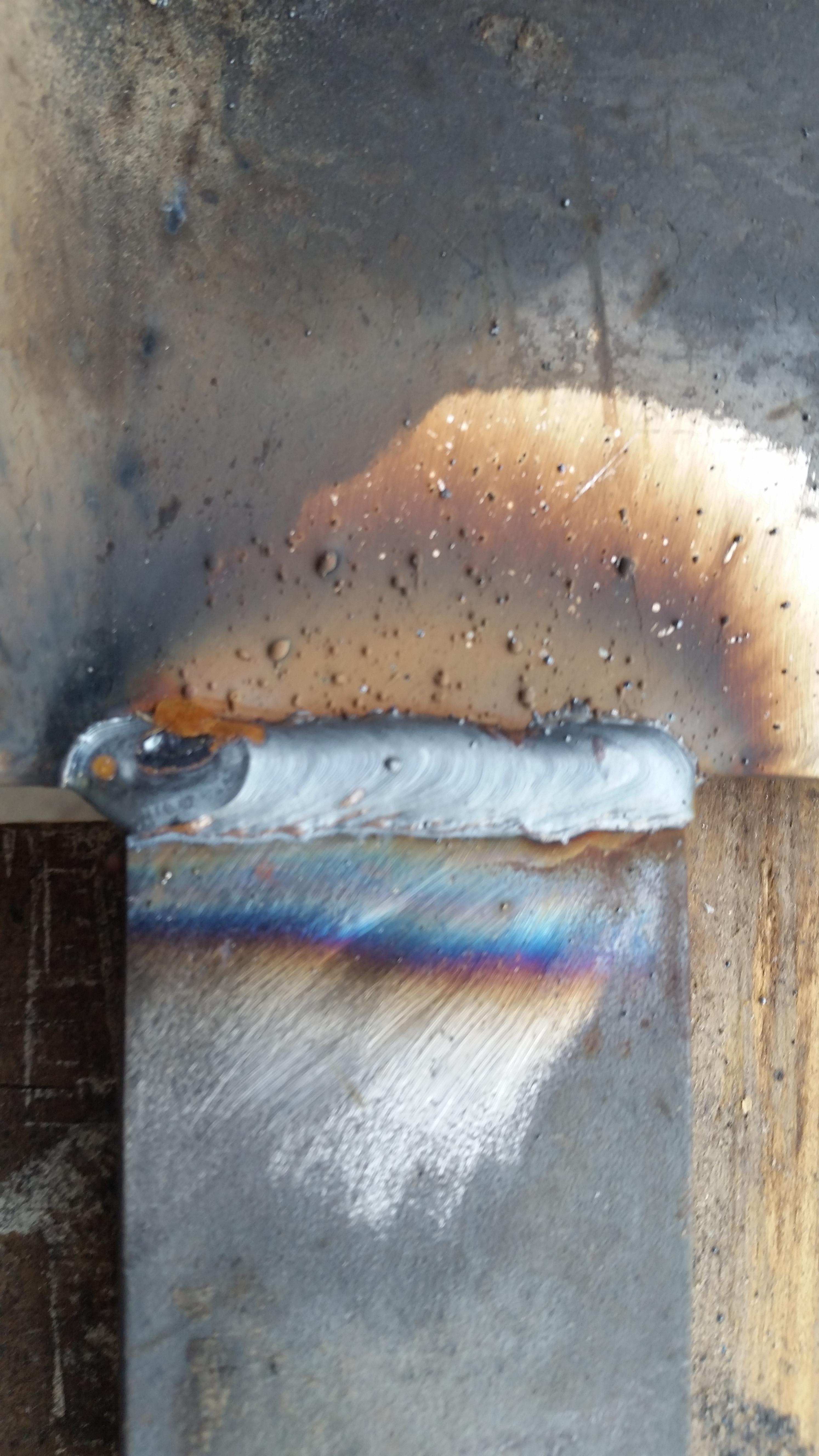

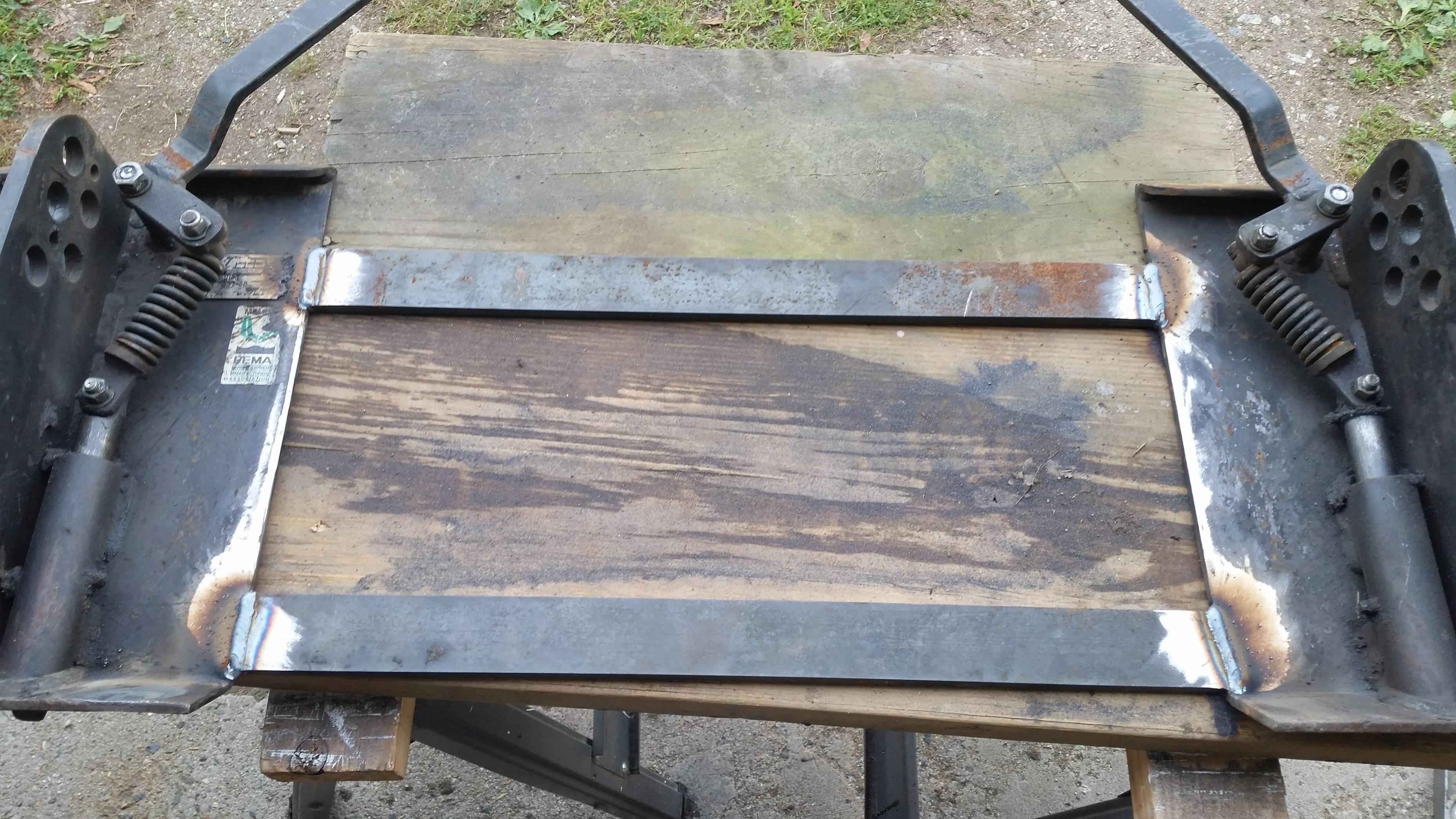

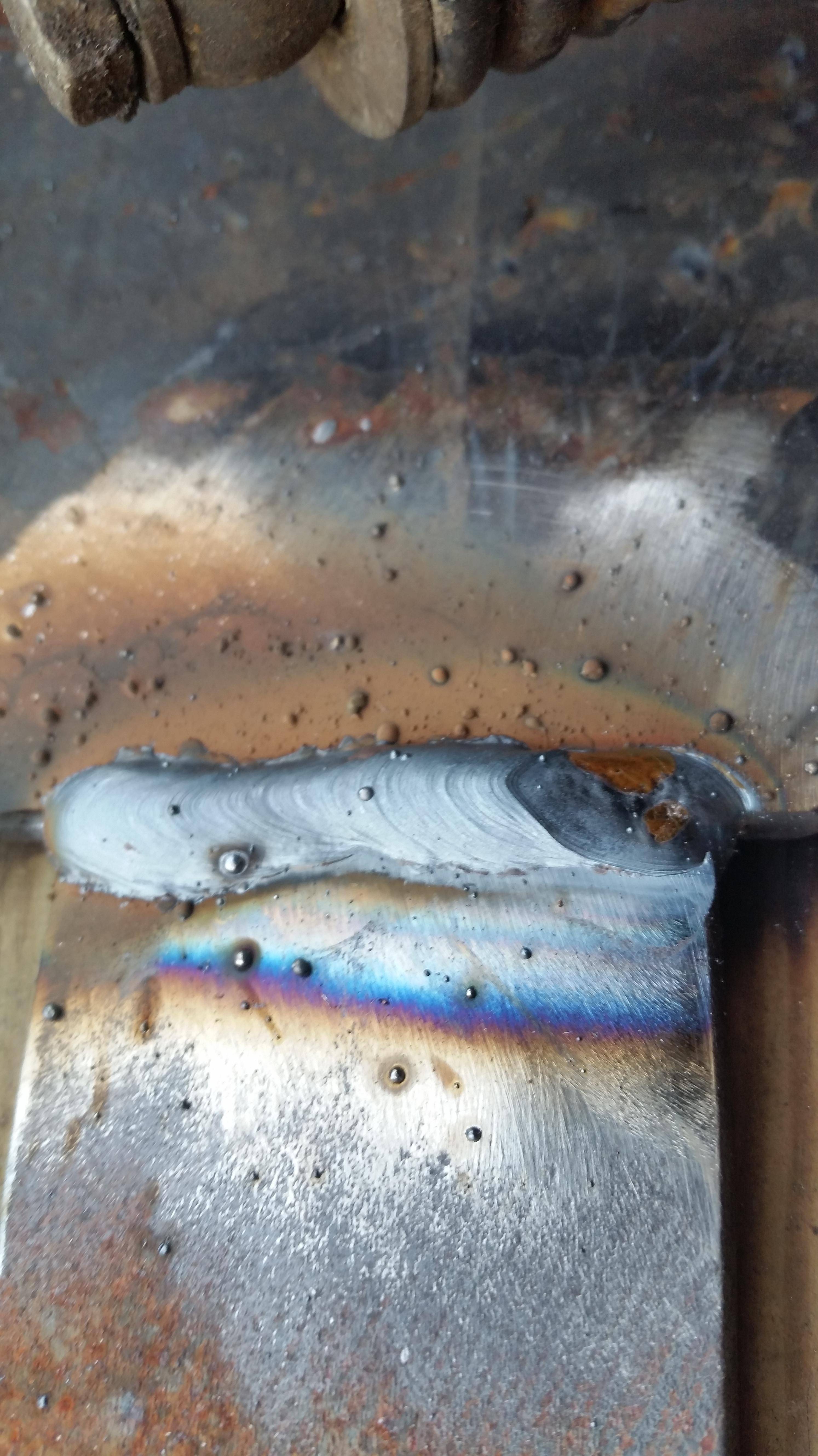

Not my greatest welds. But I took it home and it lines up just fine on the tractor. Now to bring it back to the shop after work today and plate the whole thing.

Maybe I missed something in the thread but my first though seeing those pics is......
Those flat braces have no torsion strength.
Those plates are not going to remain in sync like that.

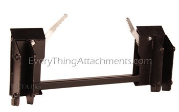

You can see on the item Travis posted, WR long used box tube as it provides torsion strength.
Again, if that is not your finished product then disregard my comment. WRL-APUM-2T.jpg

Kubota uses round tube.
