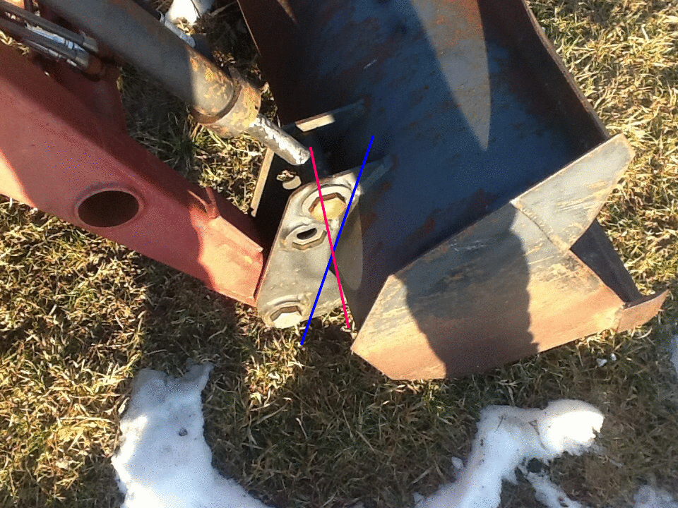

There is always the option of building more roll back into the individual attachments as best suits them --- unless you are just buying off the shelf.
If you simply cut the blue line in your pic and welded the new plates on there for both sides, you would have exactly the same roll back as you have now, just an extra couple layers of plate in between. If you have oodles of dump angle to sacrifice to gain additional roll back, I'd consider following 1/2 the blue and 1/2 the red lines along the back of the bucket keeping the ears as big as you can. Fill in the triangle that is left between the 2 tips of the now removed ear to get back to a straight surface to weld onto your new QA plate.
I'd really think twice about making new ears. Why cut those perfectly good ones off, toss them in the scrap only to make them again???

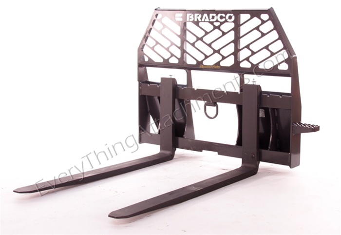

That is true, but you might not have enough rollback. You could not use most standard SSQA attachments.
Most fork frames do not have any extra angle built in.

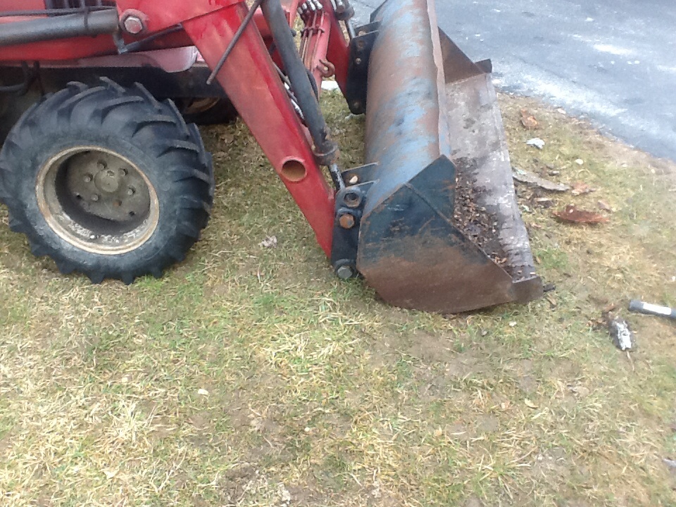

mikefromnh, could you post a side view picture of the bucket on the ground, fully curled back?
/ SSQA build using Bob Tach rebuild kit
#27

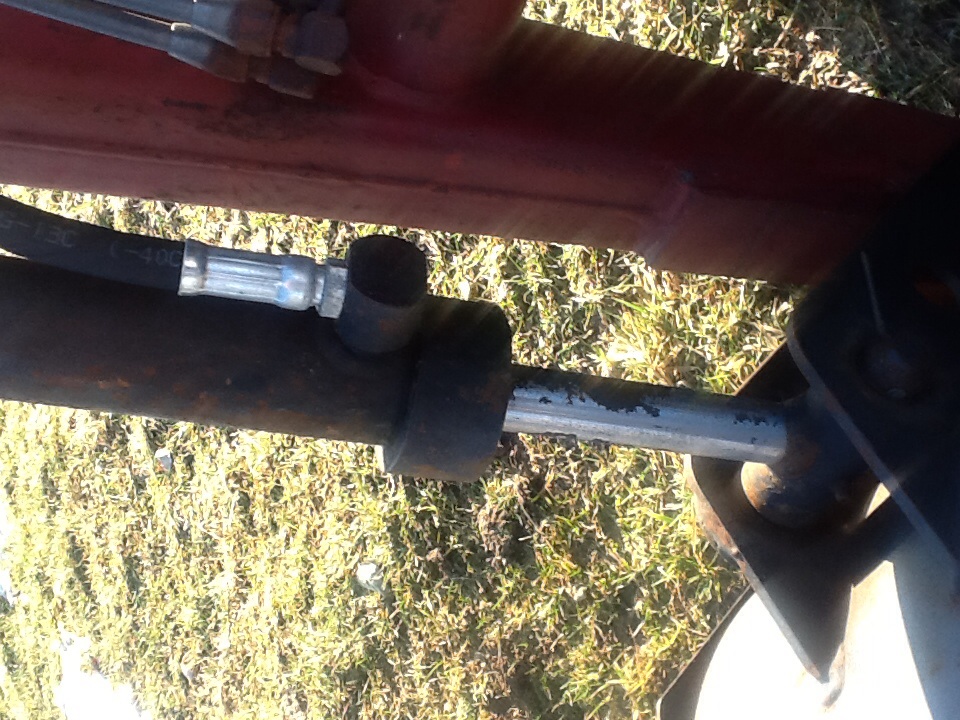

The pic I posted already had the curl cylinders retracted all the way. It doesn't have much roll back as is.
The cylinder rods could be shortened 3-4" but that seems more trouble then it's worth.
If i cut on the blue to save the ears then I would have to add a wedge shape piece to them get the right angle on the latch boxes, I would then have to add an opposing piece to the bucket to get the angle right for the adapter plate.
It seems like less cutting and welding to just make new ears and cut the existing ears at the proper angle for the adapter plate.

Doesn't seem to have much roll back at all. Are those alternate pin holes for the curl cylinder, would it have more roll back using them? If so, would that be a better starting point for planning the ssqa modification?

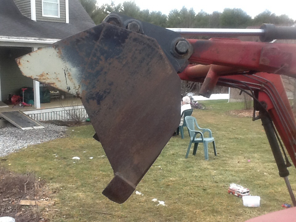

OK, next raise the loader all the way, dump the bucket all the way and take a side view.

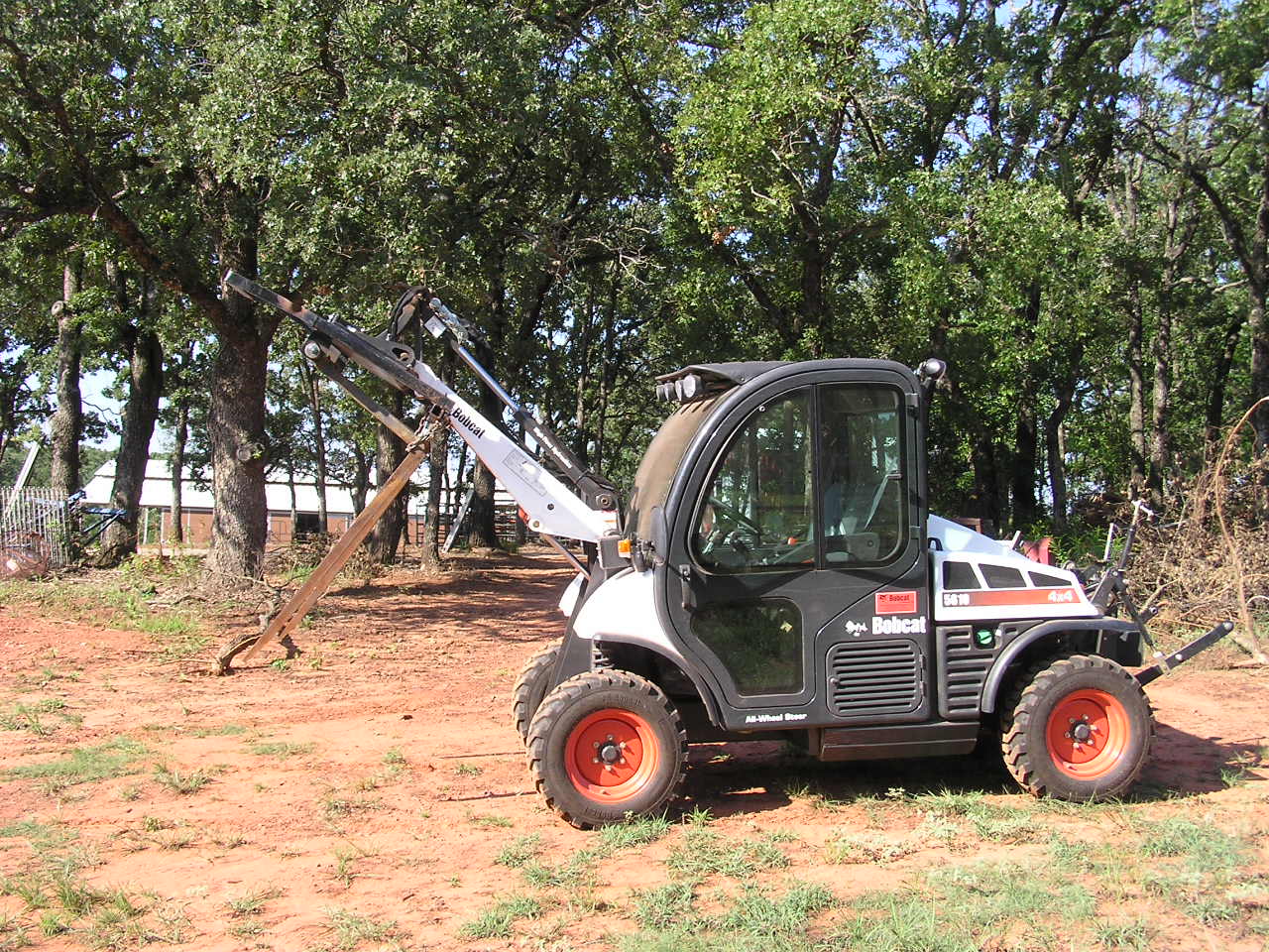

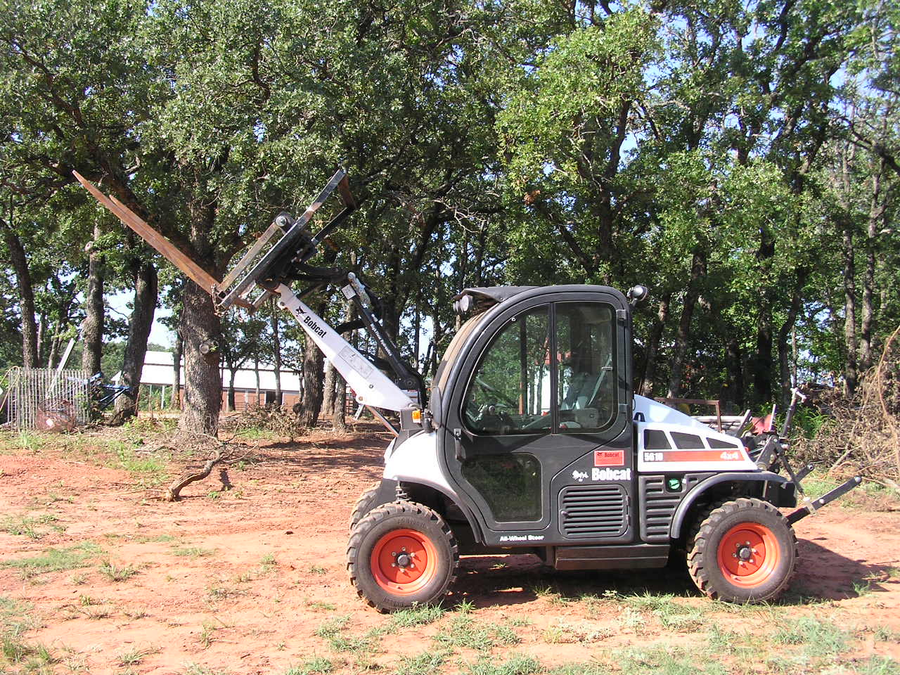

This is what the Toolcat looks like with a straight fork frame :
News to me I thought they all did, the few I've seen in person all did. A quick peek at the EA page and ya, looks like about half of them have none. Buuutttt, that one you showed does have additional built in when you look at the 360 view ;)

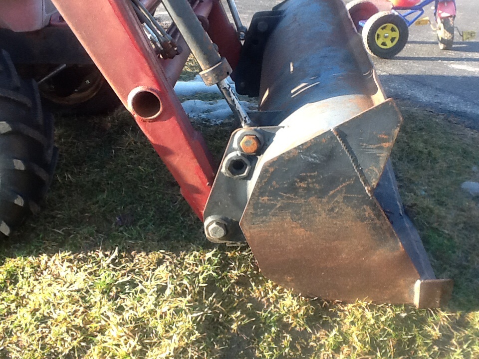

Here it is using the other pin holes.
Obviously it has more rollback and a better dump angle at full lift.
Unfortunately it looks like its at about +5 degrees from vertical. I'll have to get it in an even surface to be sure. I think I could live with the latch boxes at 90 degrees if I just had to cut on the 'blue' line to reuse the ears.
I could keep the pins in the shorter spacing most of time and switch to the farther spacing if I was using the bucket for something that needed the extra curl force.
Cutting the blue line and using the shorter spacing adding a smaller wedge on the tractor side only might also work...

That gives the preferred bucket extremes with some loss of curl force. That two hole ear set is a valuable option. I would build up those ears to give a little more than 5 degree back tip on the ssqa plate using the short holes. -- I know you want to keep it as close in as possible, but its only going to "cost" an extra half inch or so at the bottom. -- The long holes will give you less tip, but when you need more articulation force youll be glad theyre there. ... Convenient.

From those 2 pics, I would still cut the original blue line or the split blue/red I'd suggested earlier but rotate the bucket 15 deg or so before welding the new QA plate onto it. You've got tons of dump angle but SFA for roll back at ground level in my opinion.

Alright ... Here is the plan ;)
Cut the blue line and add a little to the ears to get a 'minus five' back angle when using the short pin spacing.
I'll weld the adapter plate to the blue cut line on the bucket side.
That will maintain the two pin spacing option and give me slightly less dump but more rollback. I'll use the short pin spacing most of the time but be able to switch to the longer if needed for extra curl force. Which I don't think I'll need that often.
Just need to wait to my birthday so the kids can give me the plasma cutter I just ordered :)

The nose of the loader arm rotates behind the adapter plate. I would check to see there is adequate clearance if welding the adapter plate to ear on the blue line.
/ SSQA build using Bob Tach rebuild kit #38
Worth keeping an eye on but he should have lots of clearance as he's going to add an extra wedge in there for the -5 rollback
