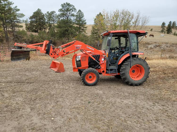

We have one of these at the farm for little things the most common usage is for the post driver,
that way it has much more reach getting into the fence lines then on the 3 point;
it works it is not the tighest construction and does have some play.
Then I have this one which is a quick hitch mounted to an SSQA plate;
I use this mainly for moving things around and getting into places that I can't back into,
it works OK. I should have spaced the bottom out about 3-4 inches as I don't have as much curl back as I would like.
I did the same thing twice. Garage sale Quick Hitch welded to a garage sale SSQA plate. First one was a snow plow mount. Sold it with the old tractor. Built another as its handy for moving impliments occasionally. Especially my heavy flail that I can barely lift with the loader. Easier to drive my LPGS & a tiller to some arena jobs than haul things. Easier to use a SSQA 3pt hitch up one impliment than rig up things on the pallet forks. More secure too.
Used it once or twice for cleaning out some stalls my cab couldn't fit under. Was okish, but not great.
