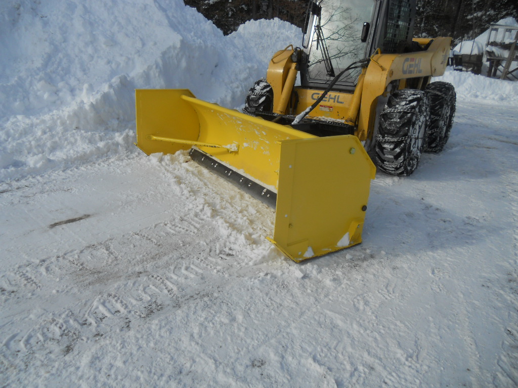

Ya got to be very carefull with a SS. They have a ridgid frame (no suspension or axle movement) and unless it is on flat ground (not necessary level), you have only one wheel on each side firmly on the ground diagonal from each other, and 2 wheels "light" if not touching the ground at all. Imagine putting a 4 legged table down with one leg on the carpet with the others on the wood floor. That equals 2 wheel drive. Chain it up on all 4 corners. IIRC you just got this machine, you will come to know how to use it.:thumbsup:

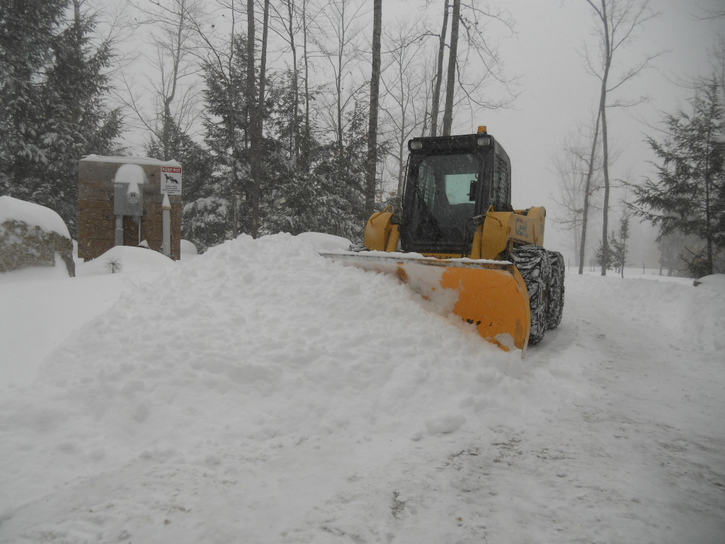

Traded Kubota tractors to GEHL3640e SS. Have 16" to 24" plus drifts on the ground. SS now stuck off drive in yard. Been stuck twice when I get off level drive, slides sideways or gets at angle (not level ground and I live on a hillside) and gets stuck. Also now remember why I moved from BX to B Kubota tractors, ground clearance.
Are tire chains the answer. Tires are 27x 8.5x 15HD. Deere on internet offering chains for $100 plus shipping. Ebay seller has them for $88 with shp but has for LT tires and mine are HD, does that make a difference for the chains?
Purchase larger diameter winter tires and wheels for your SS.
