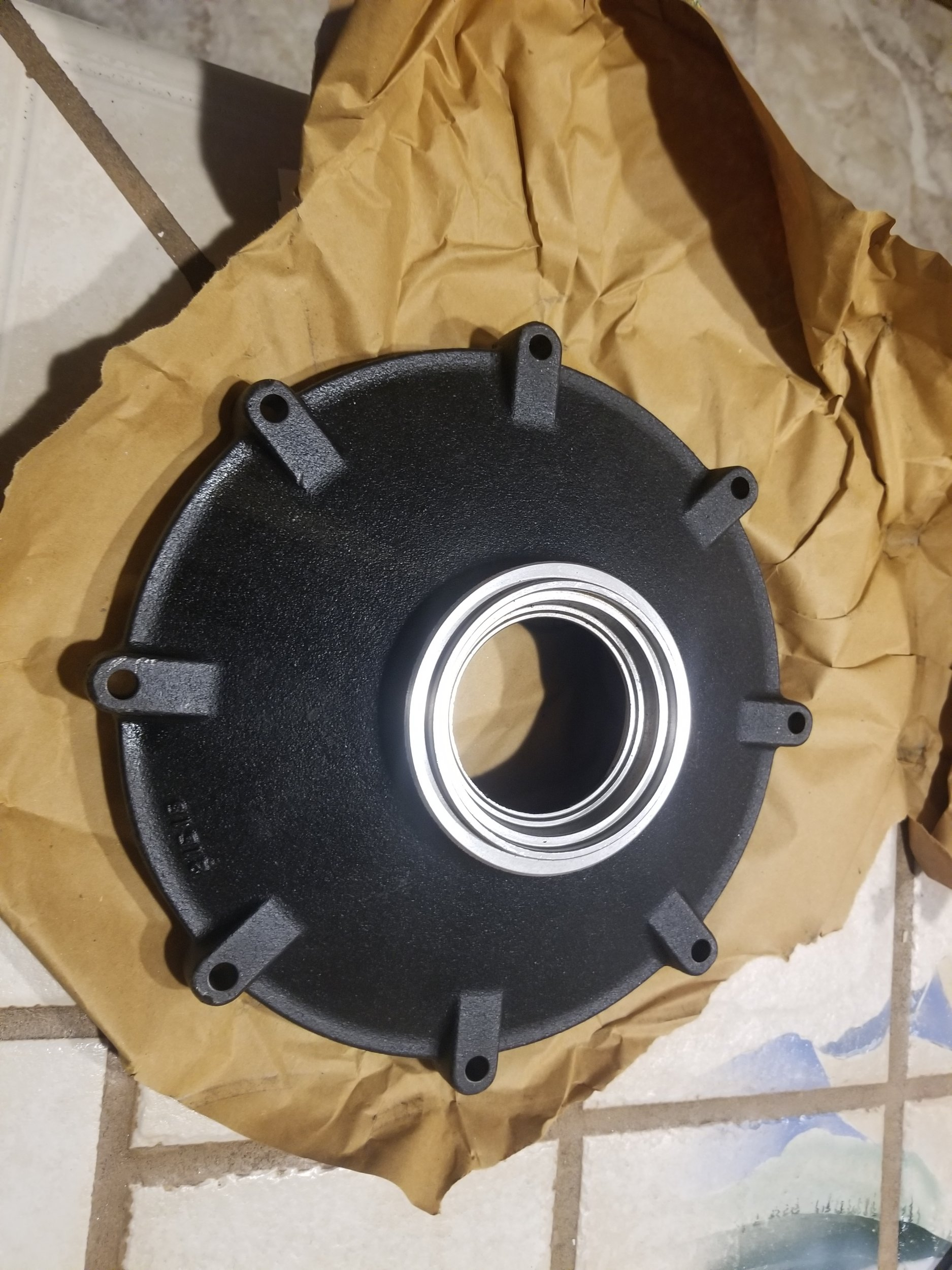

Well new cover, bearings and seals arrived today. Waiting for axle 1E87F45D-F274-4E52-94AC-71FD4FD314F7.jpeg

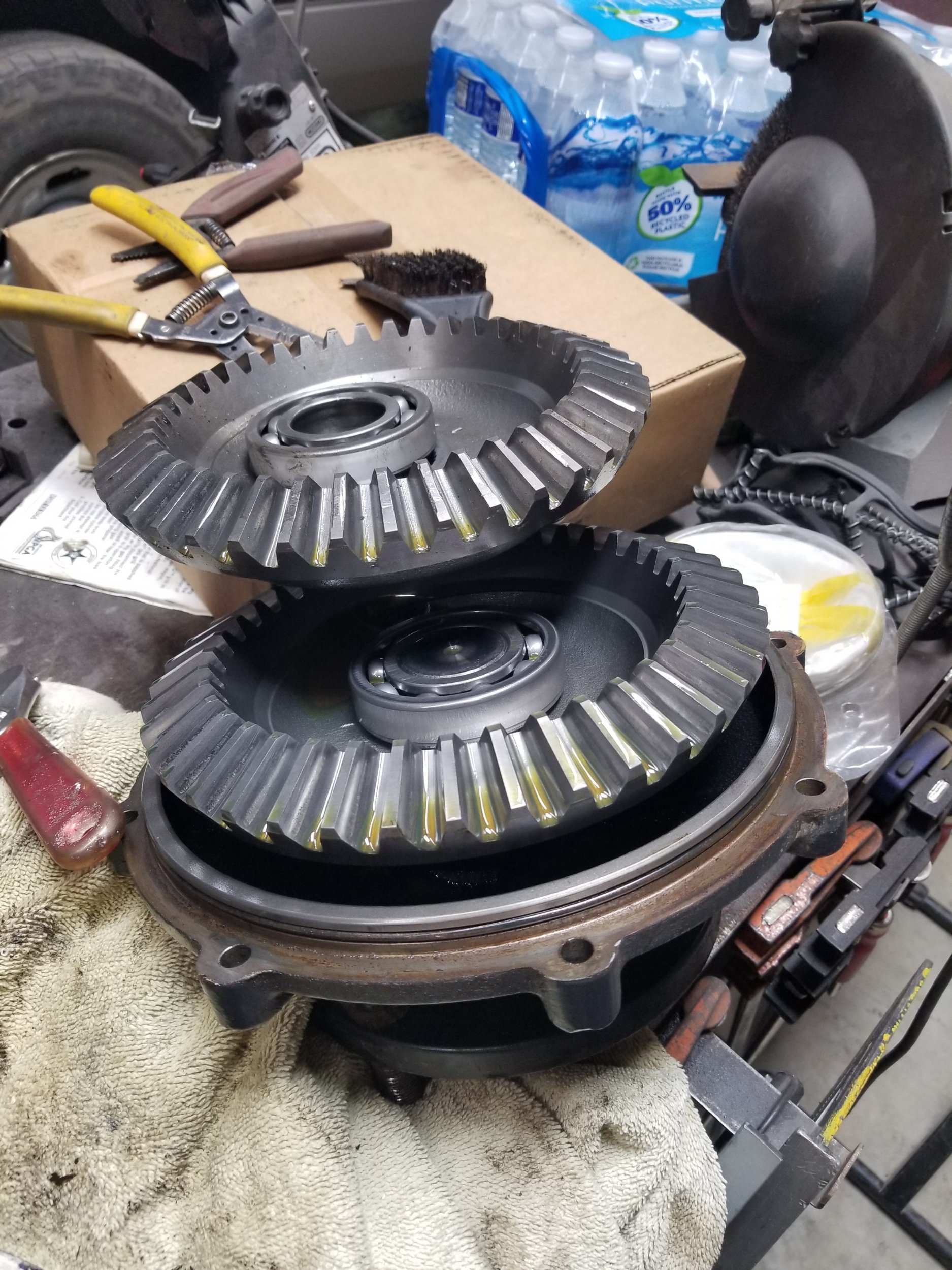

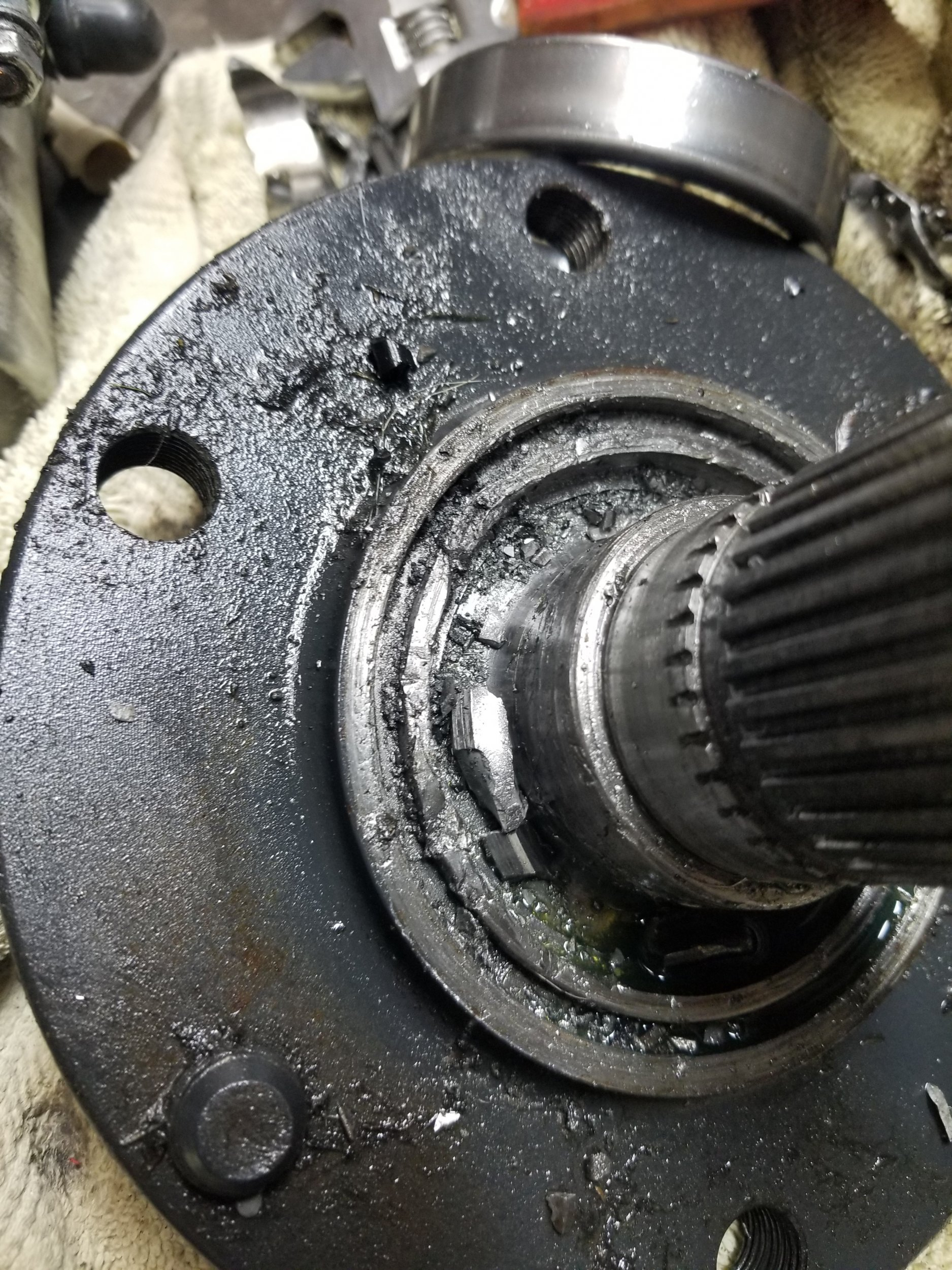

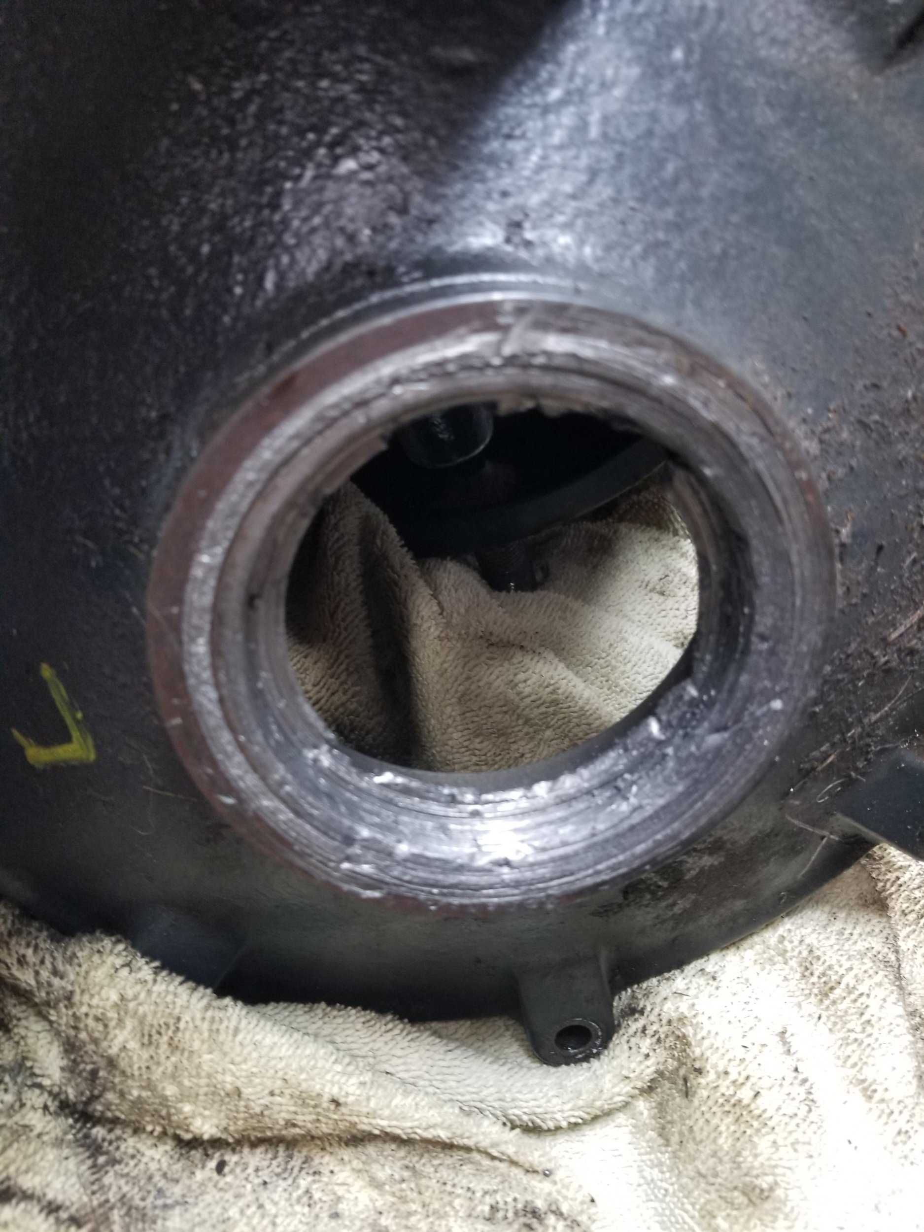

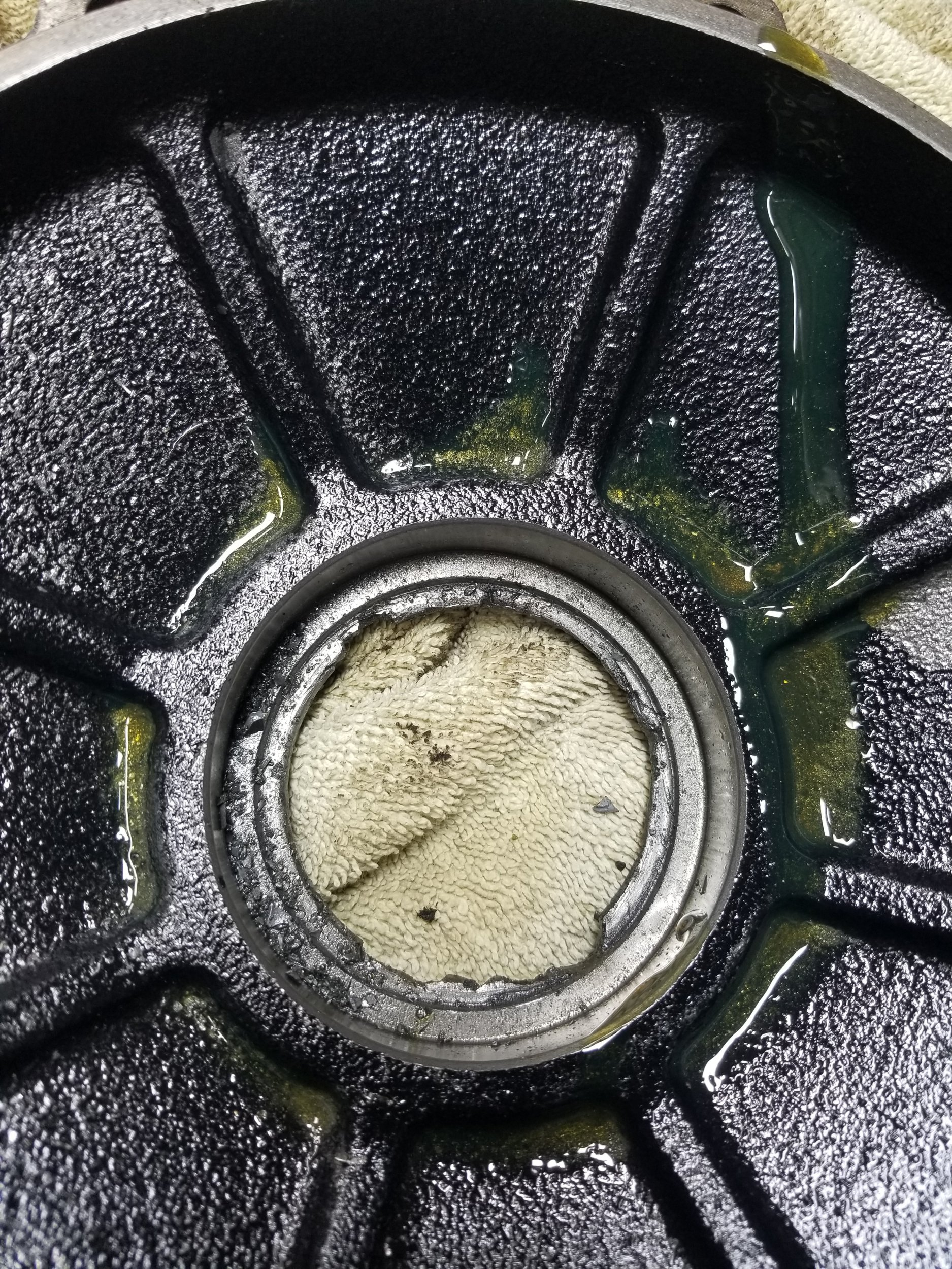

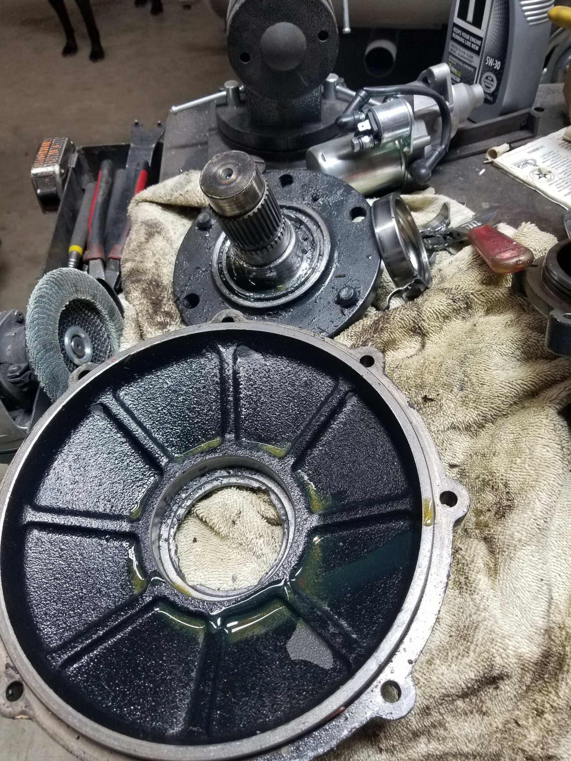

not really sure what happened. judging by the amount of 90 weight that spilled out, it wasnt low on fluid. i changed fluids last summer. when parts come ill split the other side and take a look. it could jut be a freak occurrence, but im not taking a chance with other axle. im replacing bearings and seals. ive owned this unit for 11 years now, and this is the worst thing that has happened. no other bad issues. guess im just glad it didnt happen in middle of winter.
its not an issue with the axle or cover, it was a bearing failing. i have no idea who manufactures the bearings kioti uses.
i had my JD870 do the same thing as happened to this tractor at about the 700 hour mark. dealer told me it was just a freak occurrence. now i wonder. that repair cost me close to 2 grand.
here are some pics of the kioti
View attachment 758206View attachment 758207View attachment 758208View attachment 758209View attachment 758210
