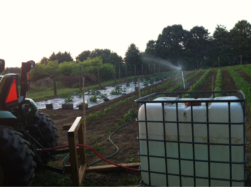

I just ran some sprinklers for our garden. There are 5 total and if I run more than 2 the other 3 only spray about 3 feet but the first two run great. I am running it off of a tractor mounted pto pump and tanked water fertilizer mix. The pump is capable of 22 GPM at 300 psi running 1200 rpm max. My tractor only runs about 600 rpm wide open.
Can I reduce the sprinkler nozzle size and get the other 3 running? Would love to run 7 at once!

/ Sprnklers #7
I'm just glad I'm not the only one that does this. It works pretty good. I'm just running one sprinkler right now.

Rather than fiddle with piping size, you can change the orifice size on the sprinkler heads. Most models have interchangeable nozzles letting you control aim and/or flow rate. Ultimately, a good system will have all the heads setup for proper balance to maximize use of the available gpm and pressure. I have even gone as far as adjusting head orifice size for the sweep angle of rotors, so that all heads in a zone put out the same precipitation rate.
In order to use the head/nozzle to balance flow rate and pressure, the supply line diameter has to be much much larger than the orifice diameter, so that the head is the definitive pressure loss. Balancing the piping layout is also important in long runs, so that you do not introduce biases due to frictional pressure losses. It's not a big deal in short runs.
/ Sprnklers #10
Like s219 said, you need to match your sprinklers to your pump. Running at half RPM will mean different things for different pump styles but you've got what you got. You also don't want to eat up spraying potential with loss in your lines, so definitely don't make them smaller between sprinklers. The issue you have is that your first sprinklers are too big for your pump and are using most of your capacity. The two ways to fix this are smaller nozzles or some other restriction BETWEEN the main and the first sprinklers, such as a valve you can throttle, or a smaller pipe, again just from the main to the sprinkler, you don't want a smaller main anywhere. Keep in mind you may get your pump to run 7 sprinklers but you might not like their performance.

I know we are not running 22gpm or 300 psi. The pump is barely running half rated speed and those specs are at max RPM.
Trying to find nozzles for these sprinklers. I think if we throttle down 2 of them that are running in a half moon shape then the less water will actualy balance my actual output. As it is the other 3 are turning a circle and laying out the same amount of water (idealy) over twice the diffrence.
This works really good but I want it to run the 5 at once then we will switch over to the other 2. The orifices are proving harder to find than expected.
