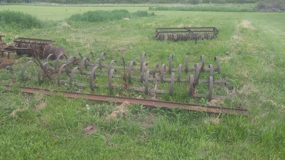

Hello,
I just purchased a 12' 3 section spring tooth drag. I also bought an extra for spare parts. Plan is to replace all hardware, straighten all bent parts, paint, and reassemble.
So far I have all the spring tooths and adjustment levers off. The coolest part is most of the original nuts and bolts are coming apart, but the replacement bolts are snapping.
I found out I need 21 spacers for all the moving parts. They are 7/8" o.d. x 1/2" i.d. x 3/8" thick. Does anyone know where I can purchase these? I'm ready to go to my local machine shop and see if they can make them.
Glenn

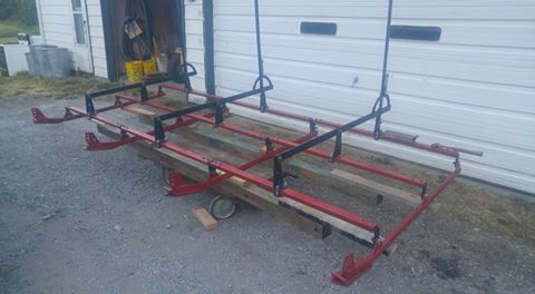

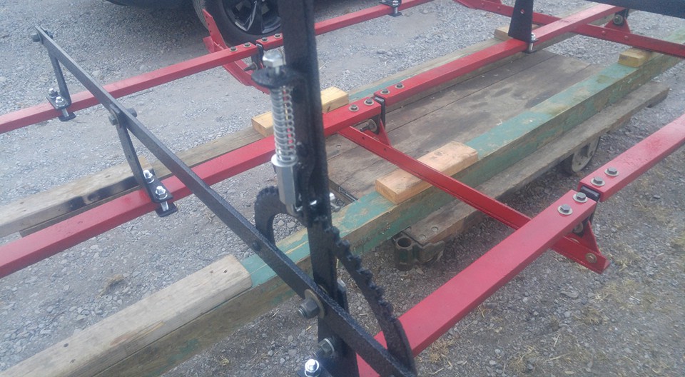

Time for an update. I had the "L" brackets made at a machine shop. They came out perfect. So after a little painting, I started the reassembly. Right now, I'm stuck figuring out the release handle for the spring hook adjustment.
But enough of talk, here are a couple pictures.
Glenn
/ Spring Tooth Drag - restoration project #7
Crap, that implement looks brand new now! Good work!
