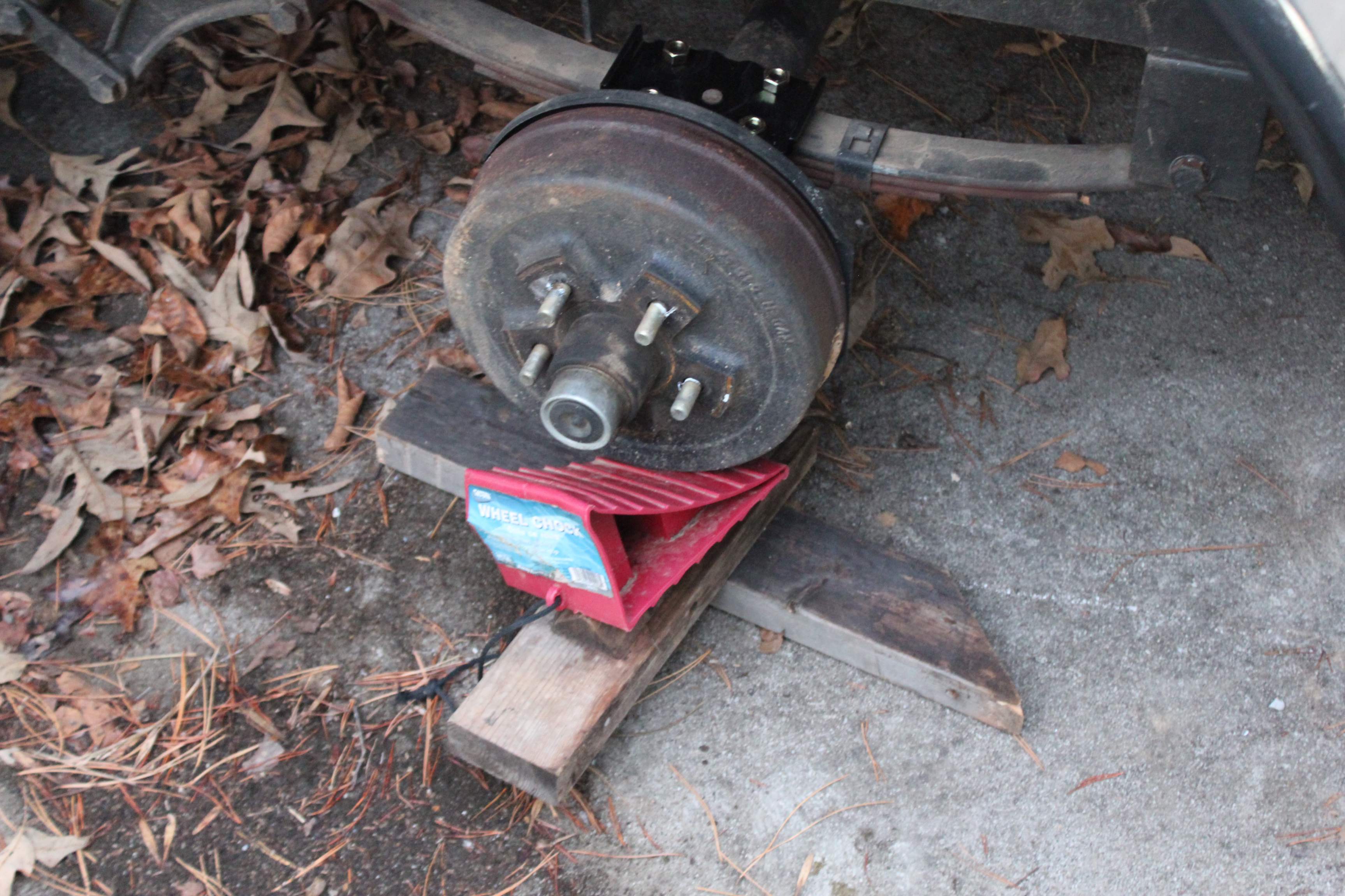

BTW, the kit is $50, but that's only for one axle, so for a tandem, you're in for about $100. Since the kit comes with new U-bolts and nuts, it's not actually THAT much more expensive than welding on new spring perches. Spring seats are about $8. The U-bolt kit is about $16. So the Dexter SOA conversion kit is twice as expensive as welding on new perches yourself. If you have a welder and know what you're doing, it's no debate. But when you add in the hassle of transporting your axles to a welding shop and the cost of getting the new perches welded on, it's a no-brainer. For a tandem-axle trailer, the added cost of the kit is $50. As far as I could tell, that's basically the job minimum for most welding shops around here, so I basically broke even.

Ok thanks, did you get any pics of the your trailer as it sets now, did you have to change your hitch ball height?
Dave

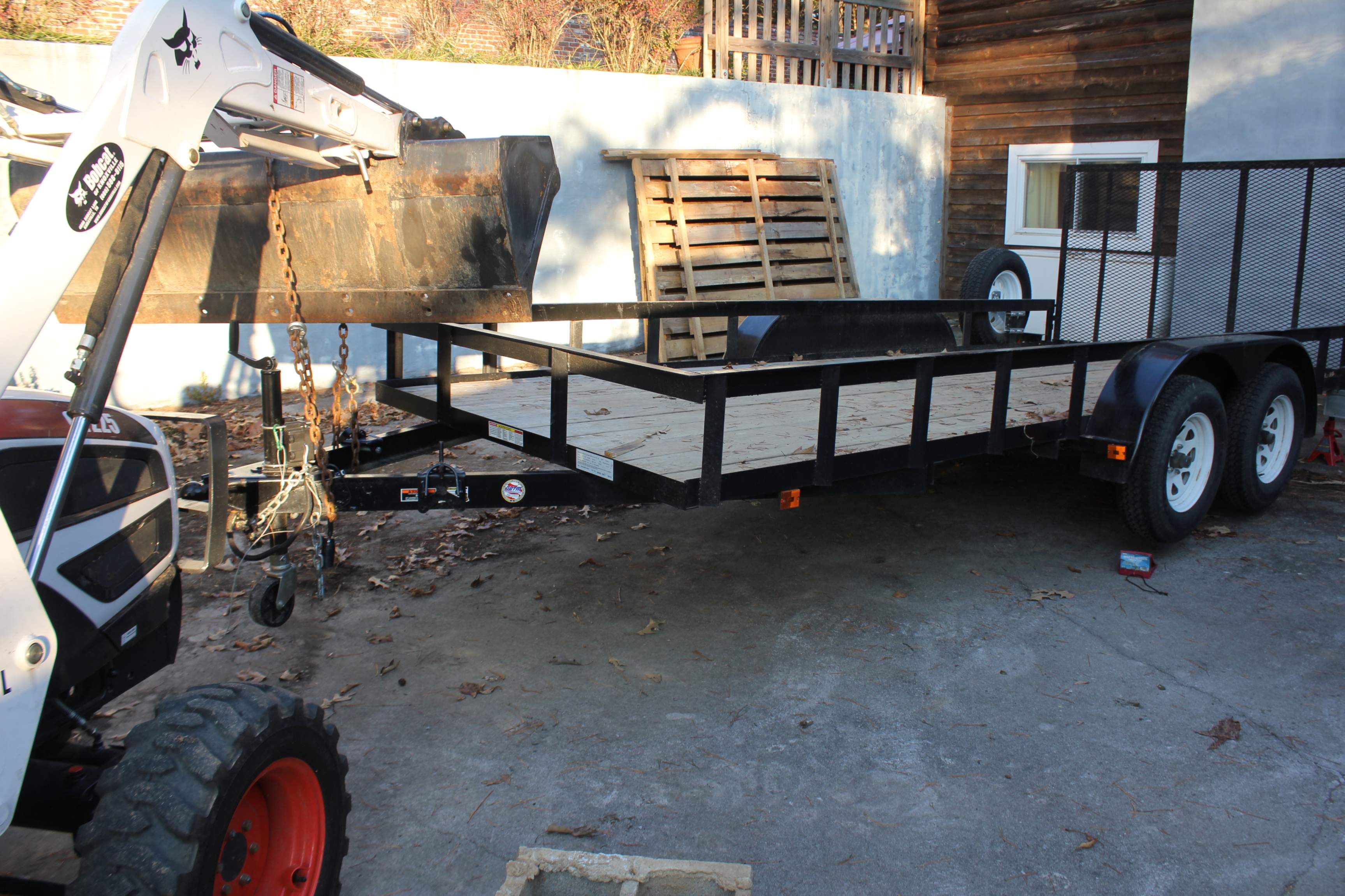

I took a picture for you today, Dave. Unfortunately, I don't have a "before" picture for you to compare it to, but just imagine it 5" lower ;)
I did have to change the hitch ball height, but that was sort of the point. With the ball at its old height, the torsion bars of the WD hitch scraped the ground. I actually had to buy a much longer shank for my WD system in order to get the head low enough to let the trailer ride level. Raising the trailer let me go back to the original shank, which is significantly lighter. You may think I'm just whining, but the difference in weight between a 6" shank and a 13" shank is probably 30 lbs. They're solid 2" steel.

I am sure it is set up the way you want it now but to me it just looks funny with all that room in the wheel wells. Looks like some of the 3/4 ton trucks that certain brands make and put tiny little tires on.
Chris
The problem is, it is simply unusable with a WD system at the ride height that it was, and I can't go over 3500 lbs on my current truck/hitch without a WD system. I suppose I could have addressed the issue with a class V hitch and no WD system, but there are other benefits to a WD system that I would rather not give up. Also a class V hitch runs about $300, while the SOA conversion was about $100.
If I'm really motivated, maybe some day I'll grind out the tacks holding the fenders on and lower the fenders...

wow - thats alot of space in fenders. Have you taken it down the road with a load to see how it feels yet ? if so , how does it feel ?
/ Spring Over Axle (SOA) trailer conversion #32
My 5th wheel is the same way. One of these days I need to make up some kind of fender skirt or something. Unfortunately, without the spring over, the trailer would be way out of balance, and really low in the back. And, probably making contact at the area around the top of the tailgate. It was probably fine behind a 2WD, but even my stock Dodge is too tall if the trailer was not SOA.
We bought this used; the conversion was done before I bought it.
Even with the "lift", it hauls/handles really nice.

Wonder how hard it would be to lower the fenders?
From what I can see, it would require more than just cutting the fenders off and welding them back on lower. They are the exact height of the trailer rail, so lowering them would require cutting out their back-plate to make clearance for the axles and to allow access to the suspension parts. As high as it rides, there wouldn't be much holding the fender onto the frame if they were lowered to be proportional to the wheels.
Well, I say that, but now that I think about it, I know exactly how much the fenders would have to be lowered, and that is exactly as much as the trailer was raised, and that is 5". Obviously, the fenders could afford to have 5" of metal cut out of them, should it come to that.
I have heard of some folks buying bigger wheels and/or tires after doing an SOA conversion, both for aesthetic reasons, and to allow for the wheels to have slower turning at speed (less heat buildup, less wear on bearings/hubs). Realistically, I am likely to just leave it as it is, even though it does look a little funny. The trailer is for working, not looking at! And no matter how funny it looks, it is much better than scraping my torsion bars on the road all the dang time.
