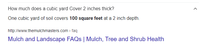

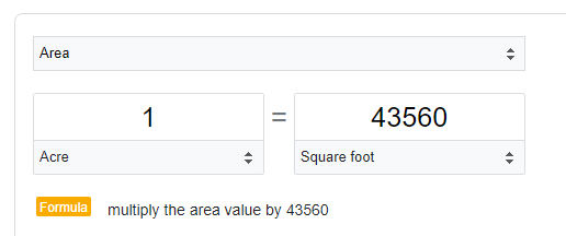

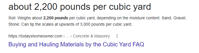

2" deep on 2 acres seems like a big job to me. I don't think that is in the realm of lightweight or hand operated equipment.
435.6 yards per acre @ 15 yards per dump truck you are looking at 29+ dump truck loads per acre to get 2" deep. 958,000 pounds of soil per acre... I must not be understanding the assignment.

Hmmm.....sounds to me like I need to do some basic arithmetic and probably also reduce the size of this project
